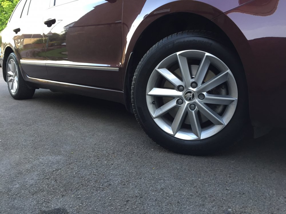

Just wanting to share what I did to make my Superb (3T Facelift Elegance) properly superb.
First was to replace the standard 18" wheels with 16" off a brand new Octavia. Managed to sell the old 18" on eBay for what I paid for the new 16" on eBay.
Big advantages are that the Michelin Climate Control tyres I then fitted are much cheaper, offer all-season traction and most importantly, the ride quality over the broken roads of Gloucestershire is greatly improved at speed. Around town, the difference is less noticeable. Mpg is also up slightly due to narrower tyre.

Any pictures of how your ride looks now?
Contemplating doing the same, myself.
How much extra MPG are you talking, is that by the car computer ?

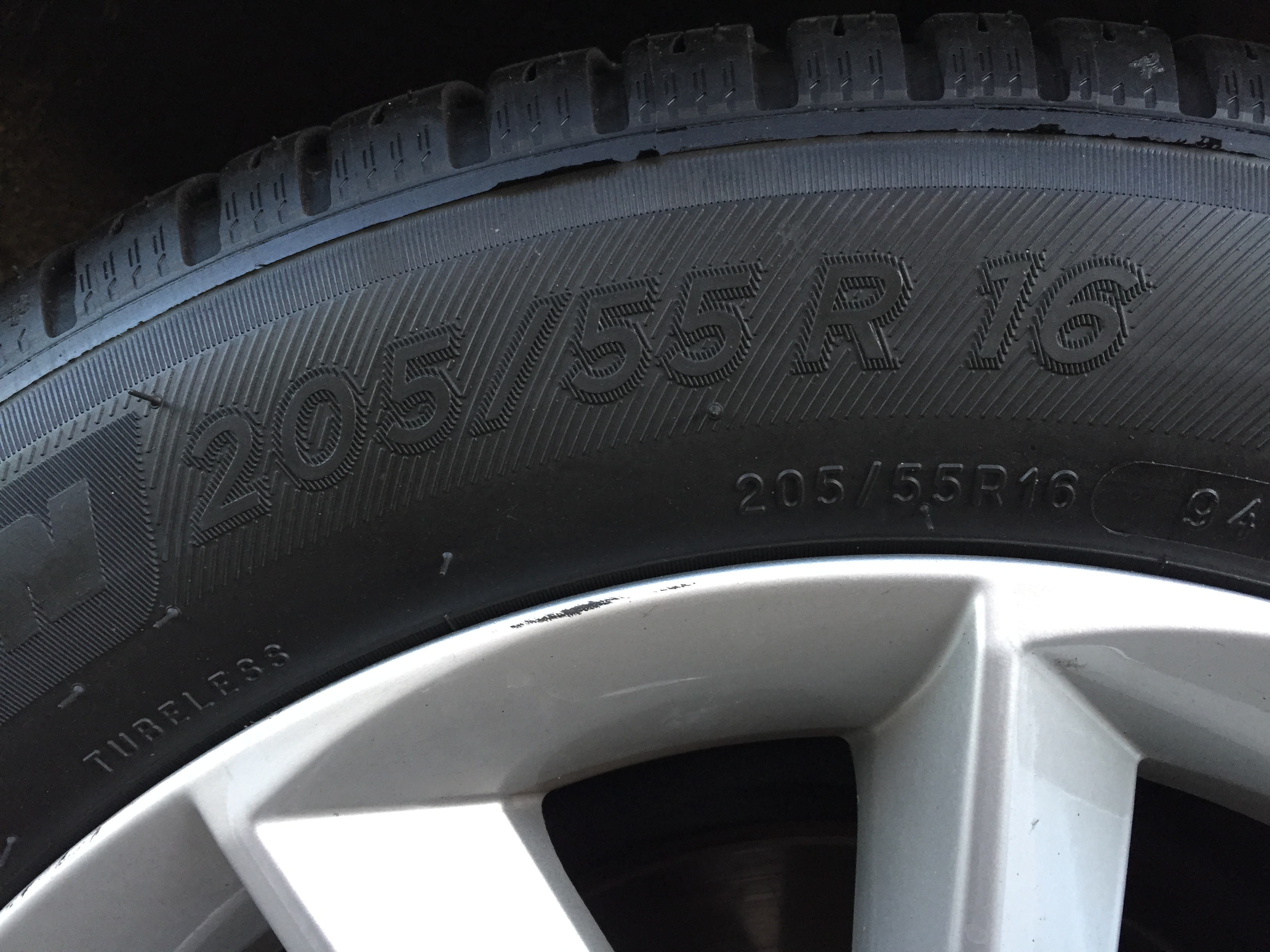

Do you have 205/55/16's now?
Where are you getting Cross Climates from and how much are they?
I am very much on the same page as you about the wheels and using Cross Climates rather than keep a spare set of winter wheels.

I got the first lot of tyres from Blackcircles, had them delivered to my home. Then took them to favourate local garage for fitting and alignment (they don't fit directly for Blackcircles as they don't get paid enough per tyre).
For another car where I did not need alignment, I actually used the Kwikfit home fit service (a van comes round). Actually found the guy pretty good and helpful.
Regarding MPG, according the trip computer, I'm getting around 2-3 MPG better than with the wide 18". Of course, if the roads were table smooth, I might think otherwise, but these days of budget cuts, there are cracks and pot holes everywhere.

The very same wheel/tyre combination as on my 2013 FL Superb Greenline SE. They are excellent in my opinion for many practical reasons.

Mark 3 Octy wheels, they are very nice.
Roughly what does a Cross Climate come in at per tyre ?
I can get them fitted no problem locally
Trying to keep OE for the age of car, so it's considered less of a mod. Original Superb mk2 alloys very hard to come by.
Loving the Crossclimates on mine (Spectrum alloys and 205/55/16 ) - Smooth ride and very quiet indeed and stick like glue to the road, also amazing in the wet (rather tested on a very very wet journey recently - road like a river) .  Early days - but economy me be slightly improved as well

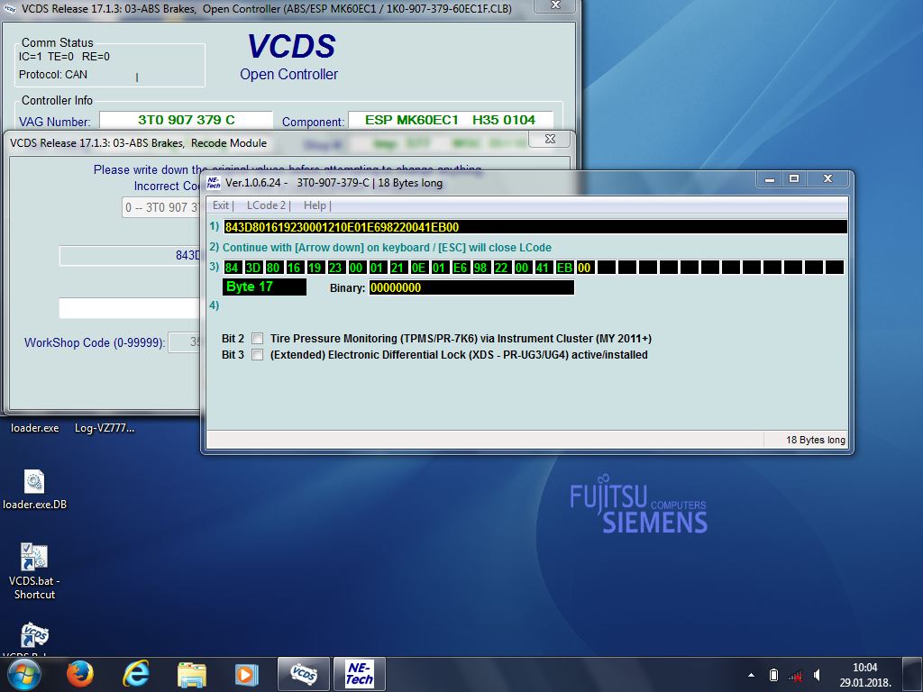

Both XDS and hill hold are in module 9 which is the ABS and both can be enabled via the coding with long code helper.
XDS is just an electronic pseudo-diff, it works by braking the spinning wheel so that the standard open diff transfers some power to the other wheel. I don’t know anything about the Halfex system so can’t help how XDS works in conjunction with it.

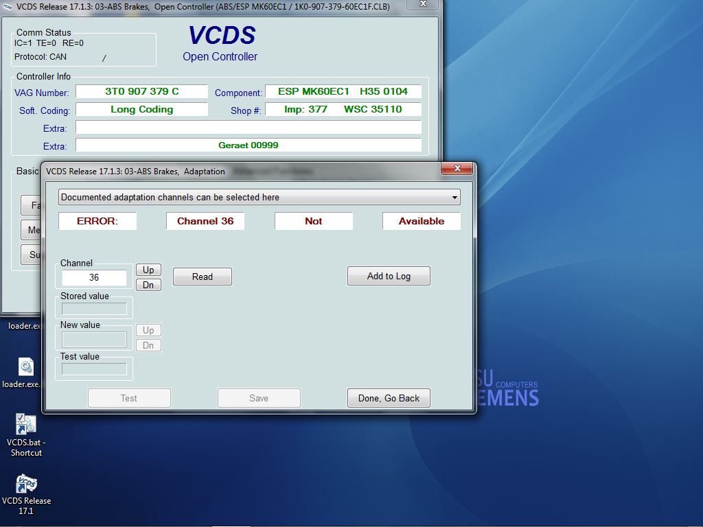

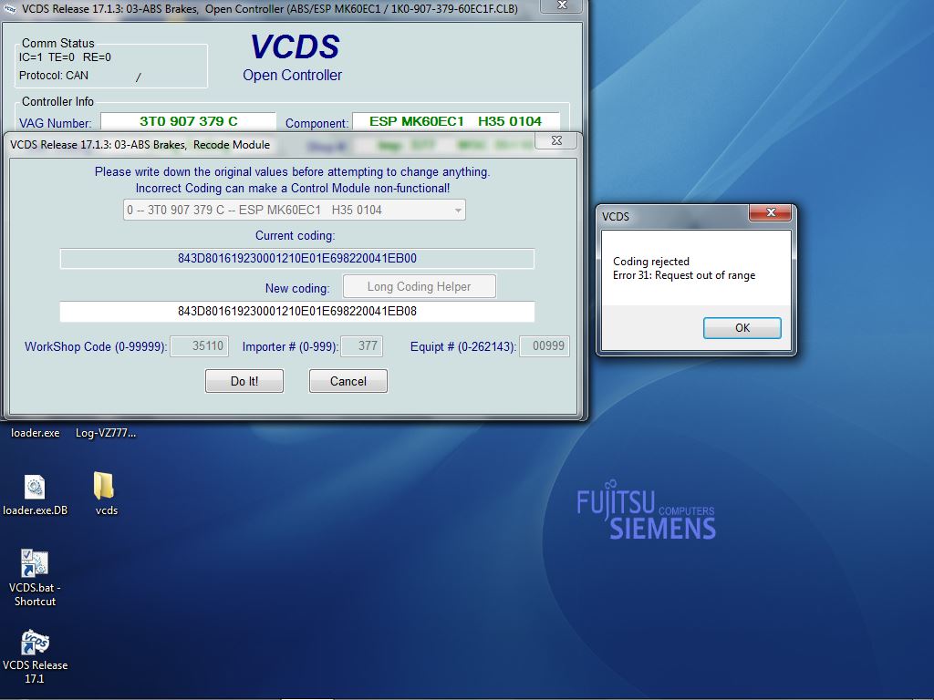

Tried, I guess in my case I have an older ABS module or whatever, and that is not available to me (I even tried coding the Differential in the CAN Gateway, nothing changed) ... so, any chance for an software upgrade, or would I have to change the entire ABS control module?
Forgot to add, the ABS ID data that VCDS can see (in case it sheds some light):
Address 03: ABS Brakes
Control Module Part Number: 3T0 907 379 C
Component and/or Version: ESP MK60EC1   H35 0104
Software Coding: 843D801619230001210E01E698220041EB00
Work Shop Code: WSC 35110
VCID: 3D76E2B6A4EAEEA9C2-8068
