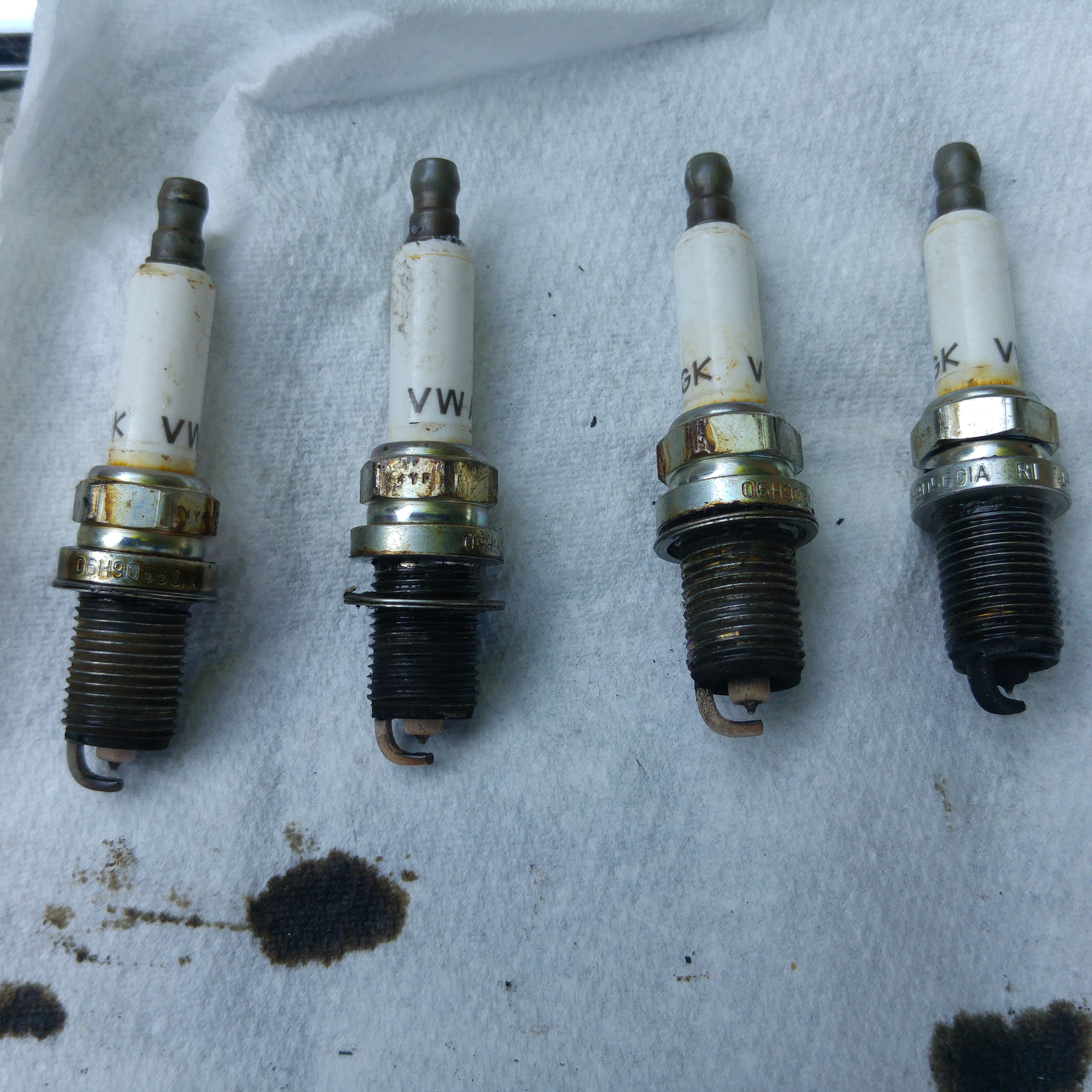

Have you changed the plugs? How did they look?
Sorry for the delay! Here is the picture of the spark plugs.
Found a bit (few drops max) of oil on the coil pack of Cylinder 1, 3 & 4. For some reason Cylinder 3's spark plug took some effort to come out!
So the conclusion is that the sparkplug in Cylinder 4 didn't have the compression ring so oil must have seeped through and caused the dry fouling.
No problem :cool: Not the worst plugs condition I have seen, deposits yet not that bad, agree the missing washer on No.4 was the issue, who could do that? As you say you found few oil drops on other coill packs, important is cleanlines in the head so plugs sit on clean metal with correct torque. When you feel plug goes not freely in or out, do not drive it out at once but go forward and backward few times so the thread will clean up a bit.
So keep going and just keep eye on oil level.
