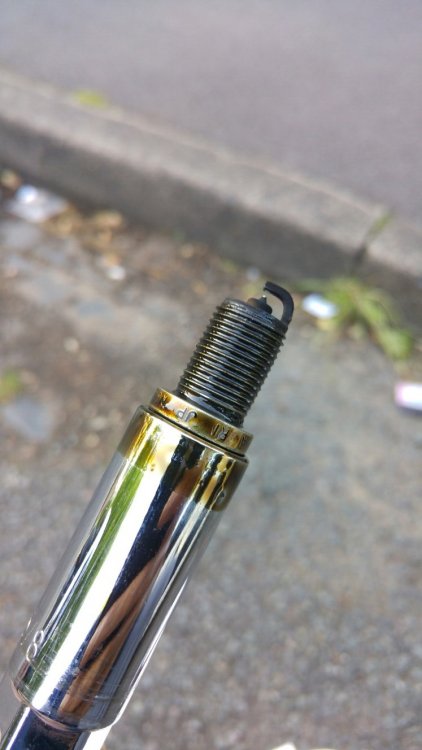

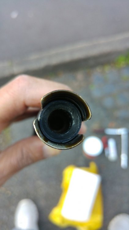

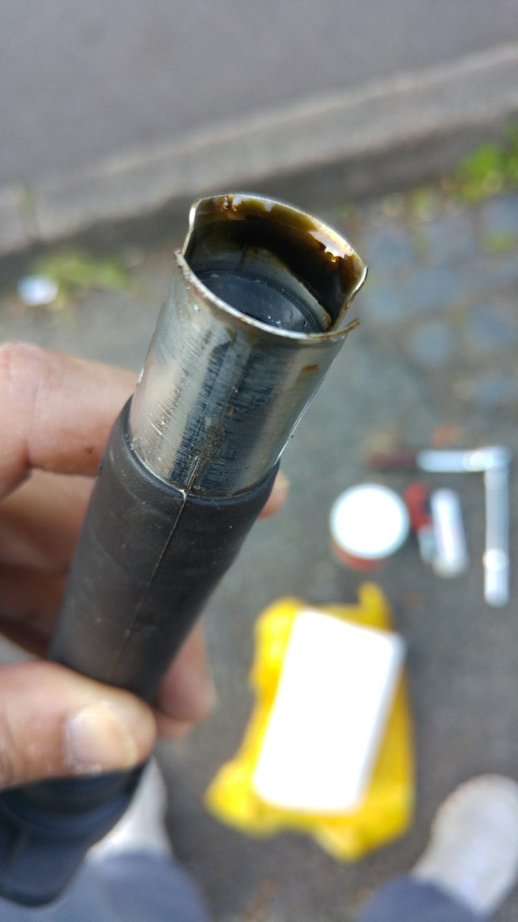

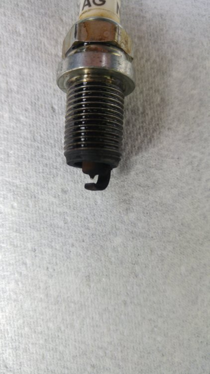

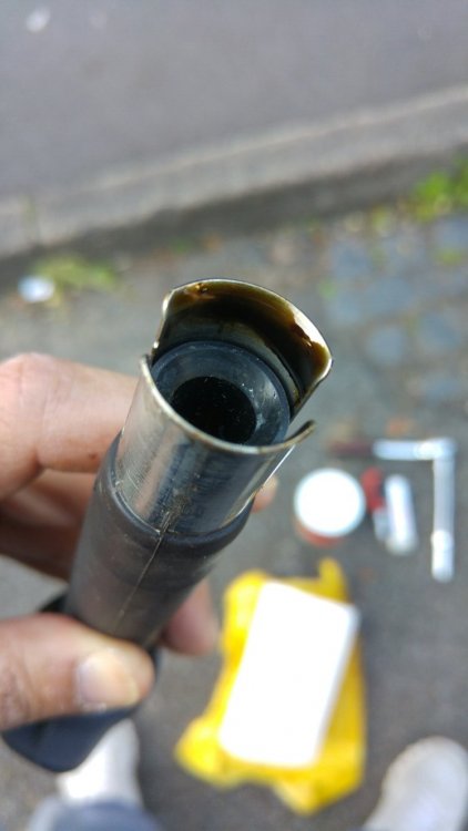

Got new faults codes! There is oil in the coil pack no4, I took out the spark plug and that was covered in oil aswell!
HELP!

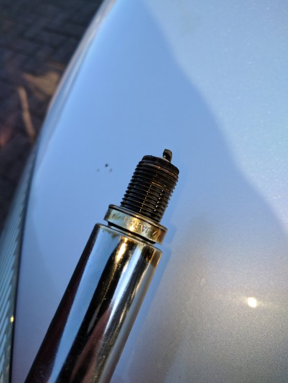

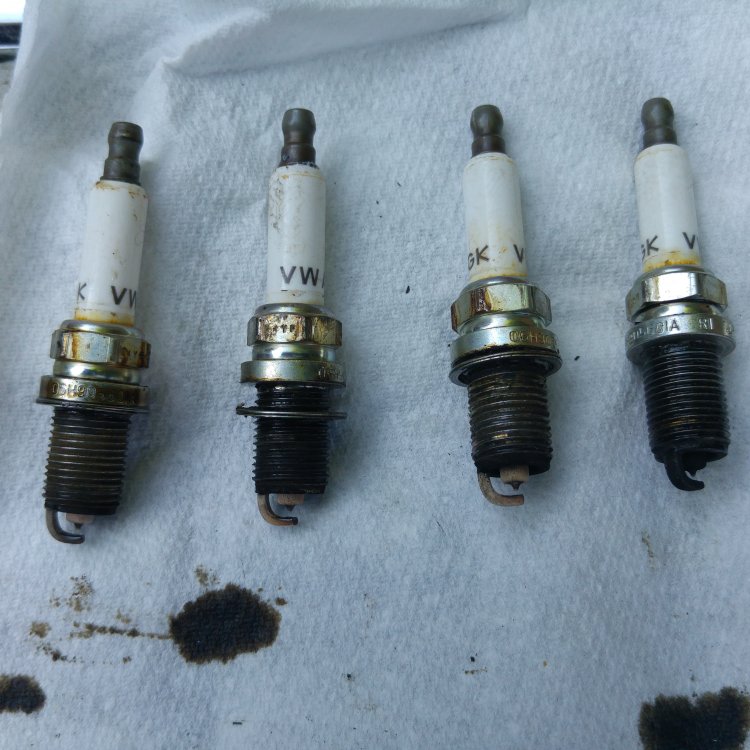

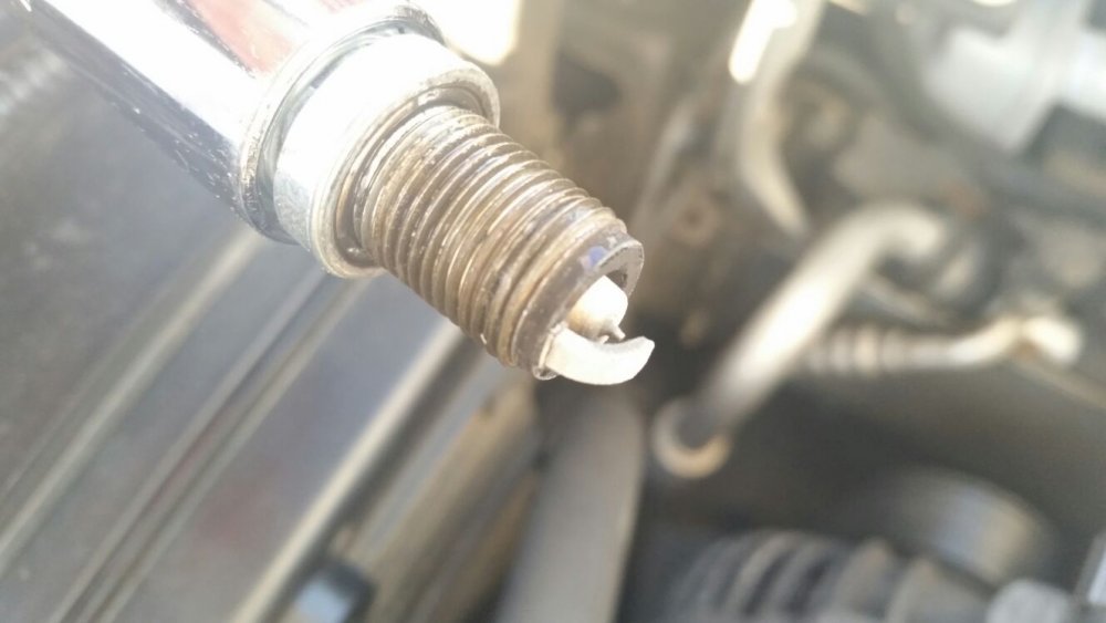

I've replaced the spark plug in Position No 4 (far right) and replaced the coil pack in No 1 ( far Left!) its idling like normal but doesn't sound great.

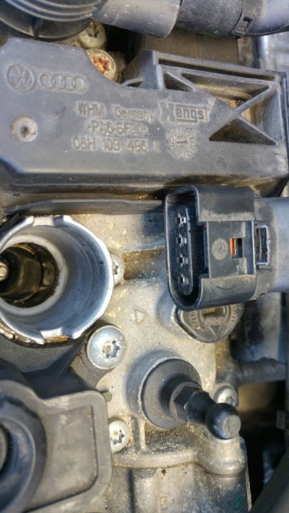

I'm fearing the worst for no. 4. That is a lot of oil that has forced it's way up the thread from the combustion chamber. I can't see what the plug tip is like but it must be burning quite a lot of oil. For it to be causing mis-fires I guess it is down in compression too. You could test, but I sense this is heading into rebuild territory.
:sweat:
Sounds Expensive!
