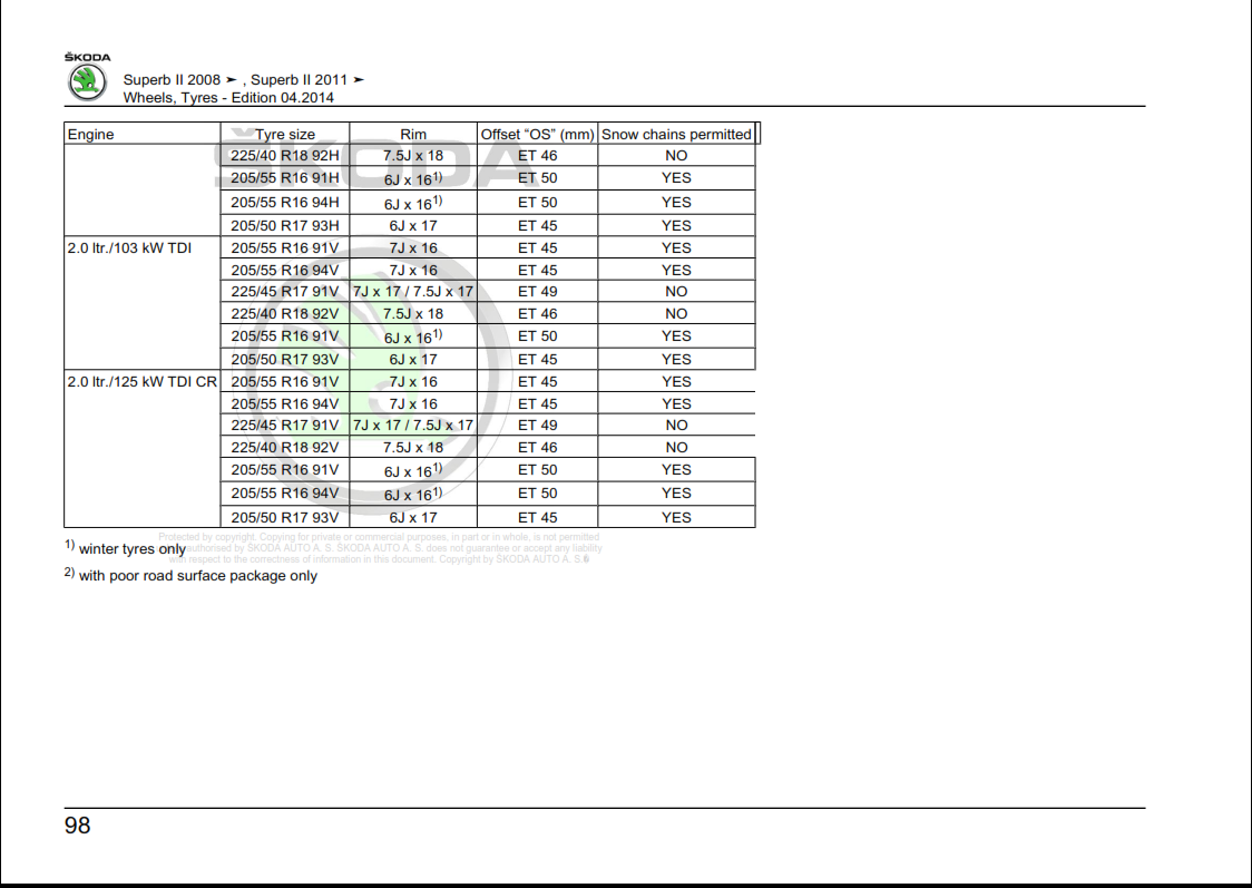

According to ERWIN you can fit any of these combinations:
Thanks, that's very helpful.
I totally see where you're coming from, having experience of the same roads myself on a daily basis.  The standard 225/40/18s are quite harsh on the SII and it never made sense to me why they went with this tyre as standard fit on what should be a refined cruiser.  I also changed the tyres on my last Superb but decided to keep the 18s (it was an L&K and the wheels really made the car) so I went with a higher profile tyre (225/45/18).  They worked and fitted fine however they weren't the easiest tyre to source but really transformed the comfort of the car.  If aesthetics are an issue, this could be an option however the 16s do make good sense for our roads if you don't mind the something smaller in the arches.
