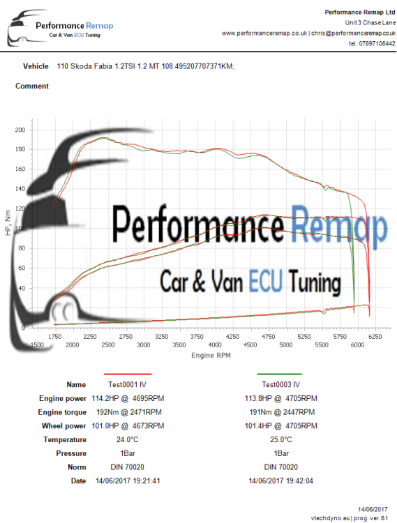

I also thought I would include the results I got when having my car tested on a dyno as the results differ slightly from the graph shown above. The car was running on Shell V-Power during the test, which according to limited research is the reason for the increased torque at low RPM and higher than quote BHP.
To conclude, whilst on the surface VW has made the new engine look more appealing on paper, the 1.2 owners are the real winners. Not only do we have an extra cylinder, we also gain a wider power band, better real world fuel economy and a better noise. I'll take that any day.

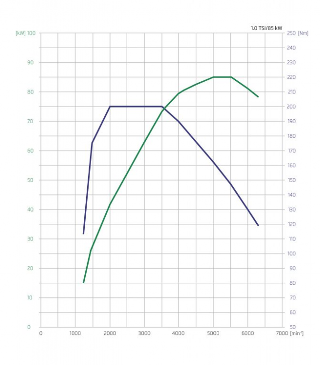

Old thread but i still find the OP:s arguments a bit lacking. If you look at the torque and power curve of the 1.0TSI from a skoda with 115hp. The torque provided is comparable with the 1.2 all the way, you have similar value at 1500 rpm which is 175Nm all the way to 4500rpm where it is down to 175 again. In between you have 200Nm at 2000-3500. The 1.2 manages 175Nm from 1500 to 4000.  Sure the 1.2 has a wider peak curve section but the 1.0 produces that amount of torque too in that rev range.
Power wise the 1.0 puts out 80kw or more between 4000 and 6300 rpm, which the 1.2 manages between 4000 and 5400 roughly.
My question is how is this an inferior engine?  It matches the 1.2 no problem.
Included is an official skoda engine data graph.
More to the point, VAG is a business to make money, they're not a charity. To develop products that are optimised for their intended use (and not pre-engineered for a handful of aftermarket tuners) is exactly the right business decision. The fact you can tune so many VAG engines is a coincidental bonus, not a showroom USP.
