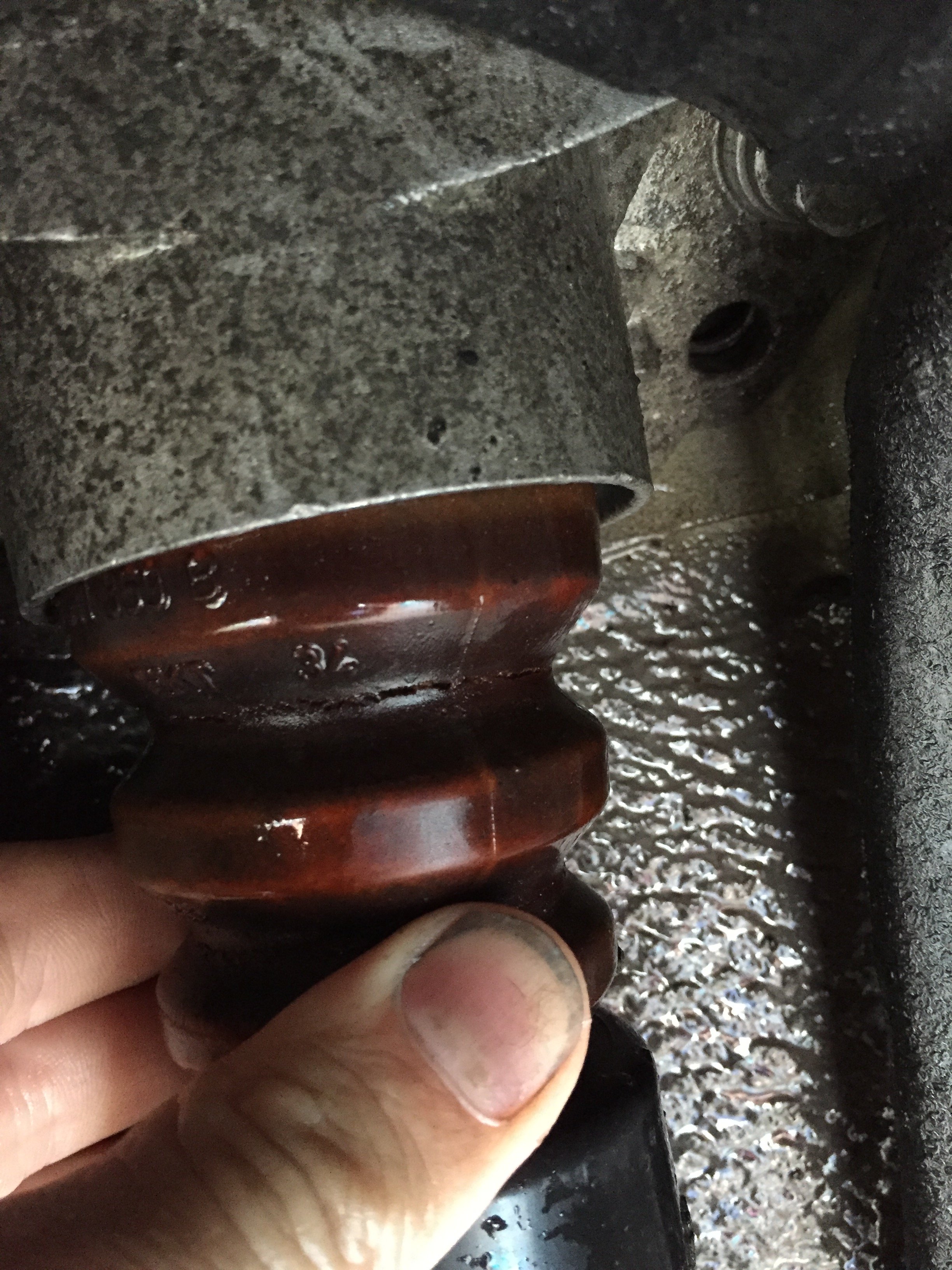

Here are mine at 95,000 miles. I presume they on the way out?
Looks like very early signs of them just falling apart. Since my 1997 Golf, I would have thought VAG would have found something not made of marshmallow for this. I remember replacing 2-3 sets on that hatch.
