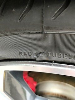

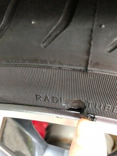

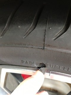

Whilst cleaning my car today I noticed a small amount of damage to the side wall right up against the alloy.
I did go over the mother of all potholes on the way to work a couple of weeks ago, I checked the wheels and tyres but obviously didn't spot this at the time.
Its about 1mm deep and not significant, how ever being of a "risk averse" pursuance I just wondered if anyone else thinks its OK.
Photos attached you can see my finger for scale!
Thank you in advance :)
Tyre damage often results in very varied responses on here, and for good reason.
That looks superficial to me and I wouldn't be replacing the tyre.
If theres no cords showing it should be ok but I'd stick it on the rear ( if it ain't already there ). Safer on the rear
Edited by Auric Goldfinger
Thank you!!! yes its on rear, I didn't think it was too bad but just wanted to check! :)
Agree with the above. Should be fine.
Pop a dot of superglue under the flap and all will be well.
Just a heads up - check the inside sidewall if you haven't already!
As above, I personally wouldn't worry about that damage, it's mainly the rim protection that's taken the brunt. No casing visible, it should be okay.
Thanks All - Will raise a glass (or two) of Hobgoblin to you tonight!!
I agree its superficial and not to the cord.

I had just the same on the wifes car, pretty much the same shape, size and location and it was an MOT fail. No amount of discussion changed it.

I have almost exactly the same damage on one of my 19" wheels (possibly mine is a bit deeper).  When I took the car into Skoda dealer for a service I expected to have to get a new tyre (or two for balance) but they said on the video they sent me of the health check that it was OK as the cut only went down to rubber and not down to cords - but to keep an eye on it. If it starts showing 'cords' then that is when the tyre needs replacing.
I drove about a 1000 miles with it - on motorways, up and down mountain roads with a full load of luggage without any problem.
