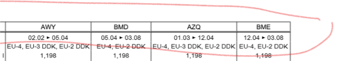

When were the BME coded engines introduced?
^^^ Perfect, thanks.

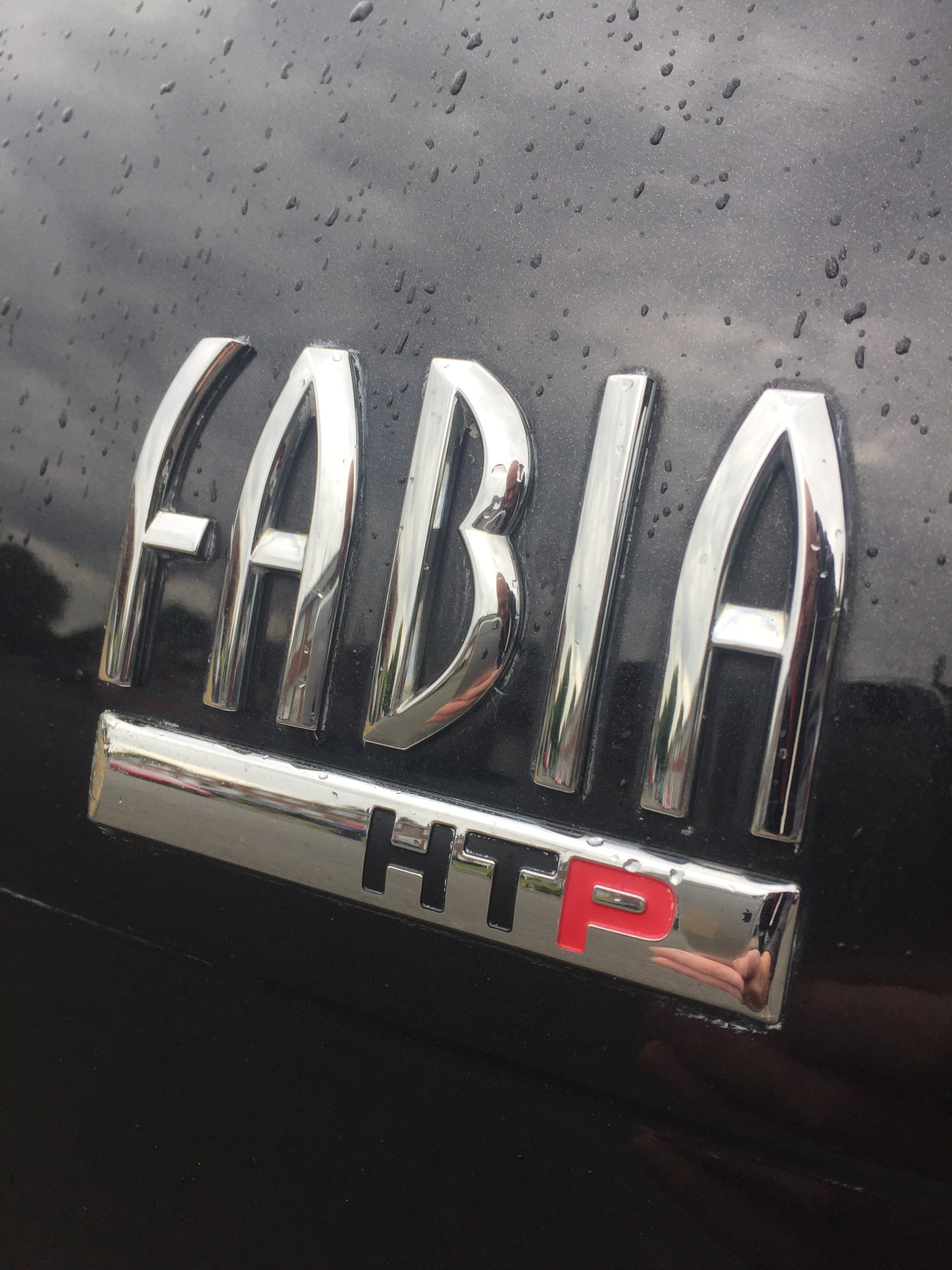

This doesn't distinguish between AZQ and BME but, in case this helps, the 1.2 HTP 12V will have a P on the rear badge :-
