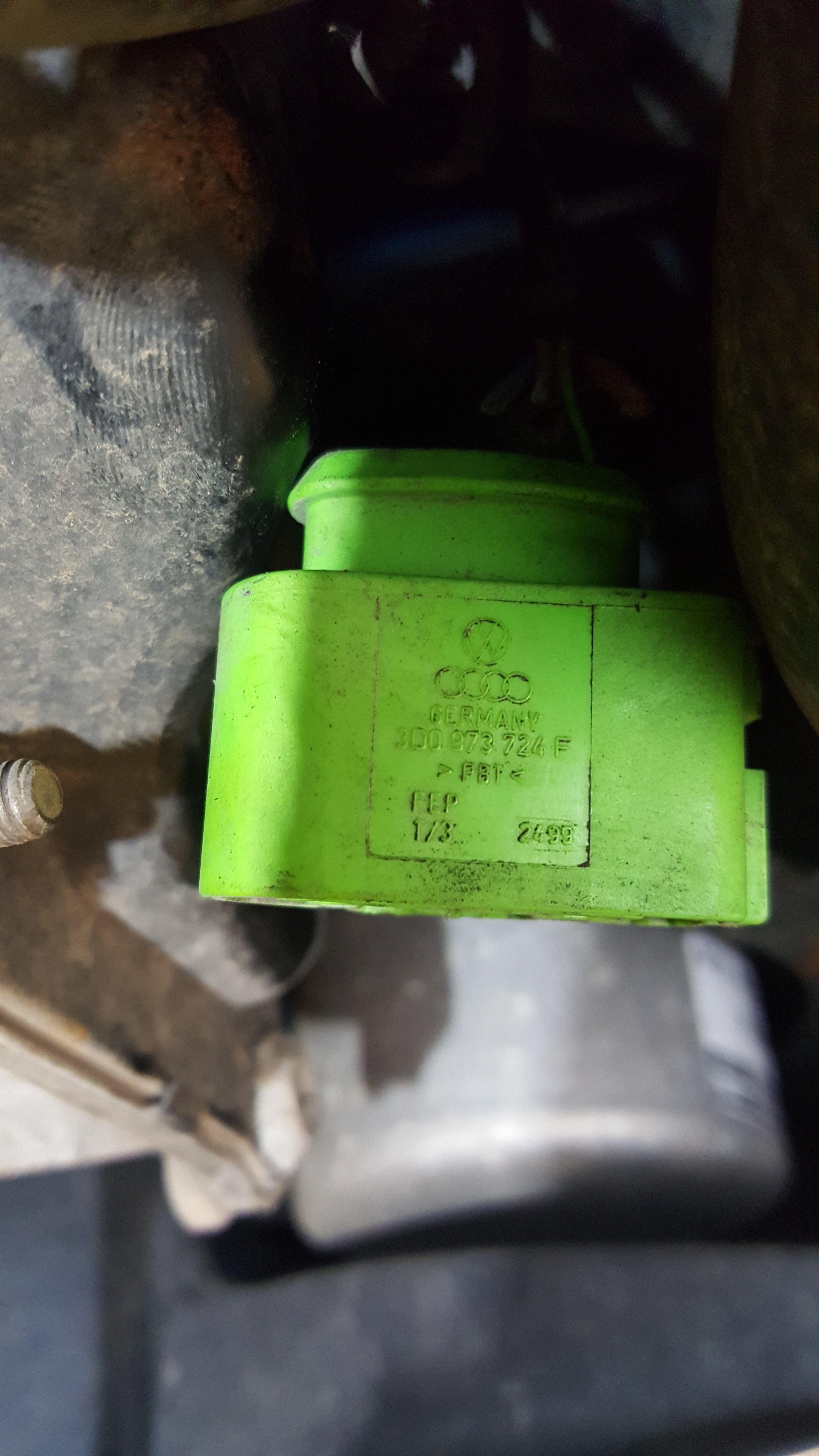

Hi I think i may have same problem as you!       i have no power getting to my compresser and i followed the wires to the battery (under) but so many wires i couldnt really pull them all out,,  my fan has not been on as i have only been trying while the car is cold start... should the radiator fan come on even when car engine is cold while climatic is on?  and to get to the wire you mean would i need to do from under the car (remove engine bay cover?) or can i do from under bonnet?
i also saw a bunch of wires under the battery but couldnt figure out how to get to them!

Found my problem, there is a green plug under the battery (near) it had 4 wires.. only one was attached. :( all fixed now :)
Did you have to take the battery out to get to the wiring?  this thread is going to save me i am sure as i have same problem and it is one of these fixes i am sure,  i found a bunch of wires going to the underneith of the battery they had some kind of cover/conneter but i couldnt see and didnt want to risk pulling them out any more as maybe break somthing, i cannot left weight of battery at monment but can ask my frined if i need to remove battery to get to this area,

Hi,
No I got to mine from underneath the car. Got the car on a ramp and removed the undertray. The plug is behind the big hose and it's easier to remove the hose to get to the plug.

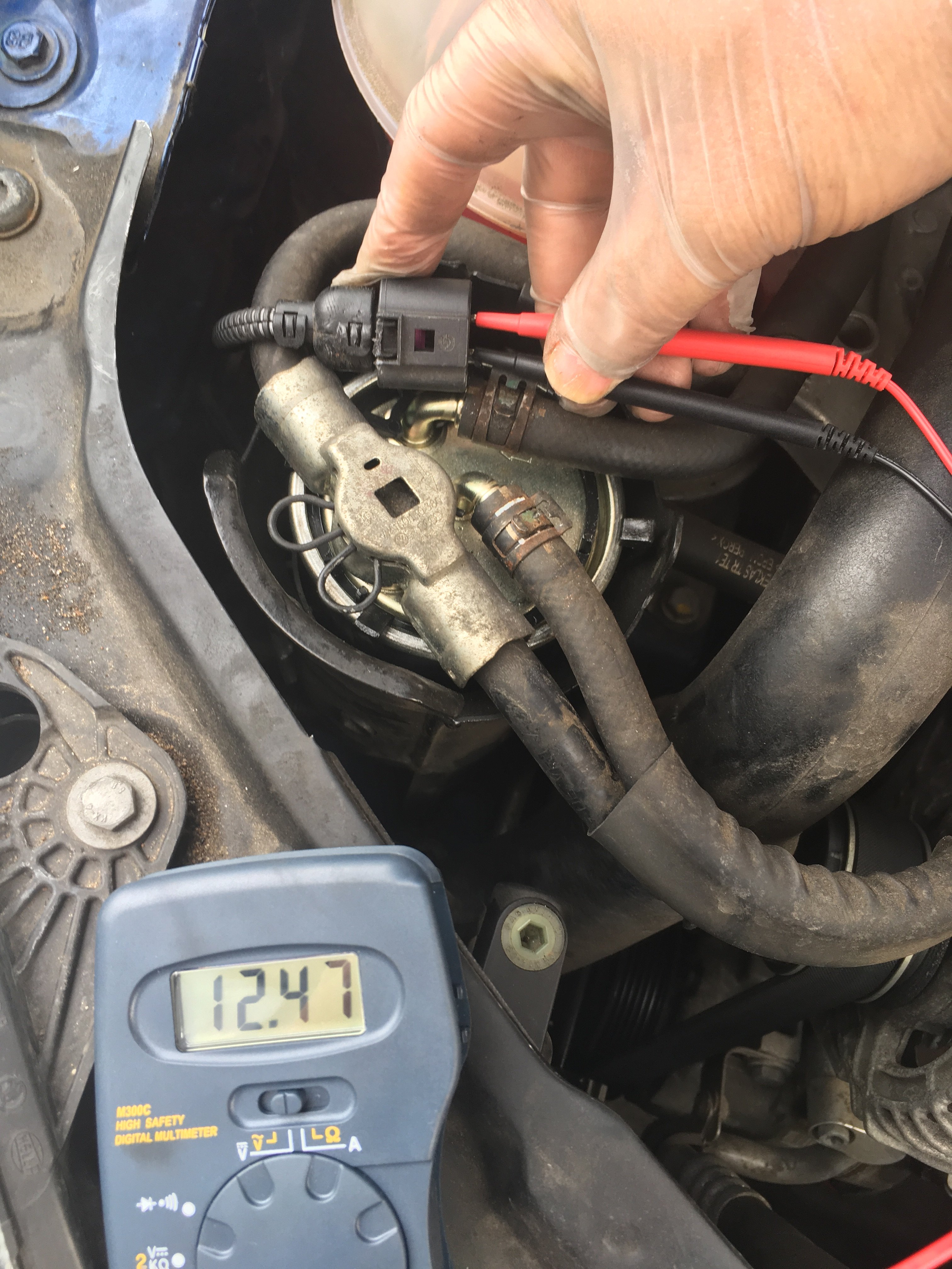

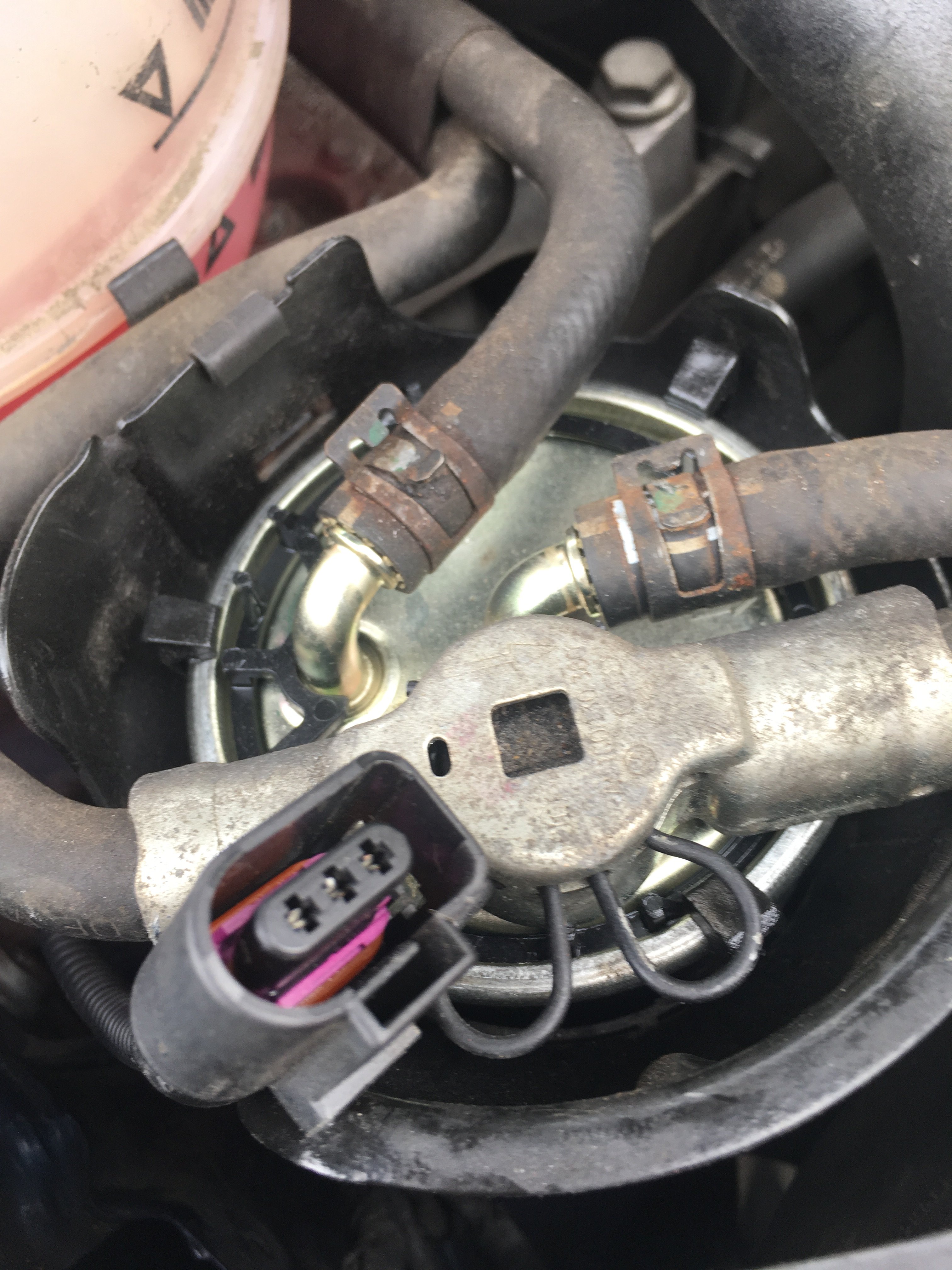

Hi thanks for reply, was tough to get to the sensor , I have power going to it but I don't know how to test it?
Would I get a different fault code for this pressure sensor ?  As my fault code is for the compresser ,,, if I run a live straight from battery to compresser should this fire it up?

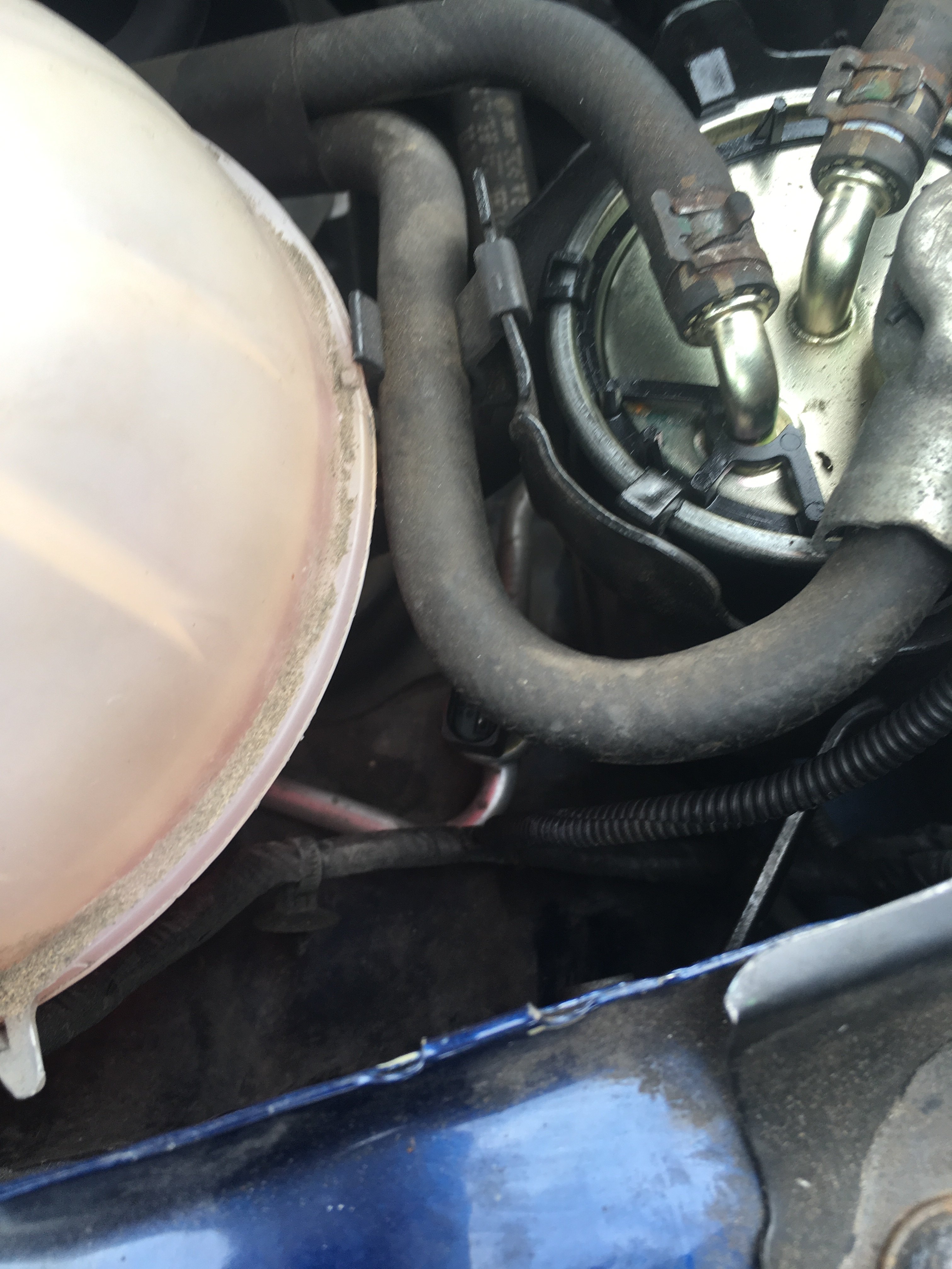

Like before I remove the sensor i should check underneath for broken wire as shown in the other picture?

sorry for all these posts , but i think i was so close to solving this,, , seems i may of made mistake here as i tested the connection as see in the pictures and put reconnected it as i do not have another sensor i can put on it, so after i check i am now getting 2 fault codes!!
382 as before and now 333 also!   i never had that one before and believe 333 is the pressure sensor, i suppose i may of just broken it even if it was not broken before,
