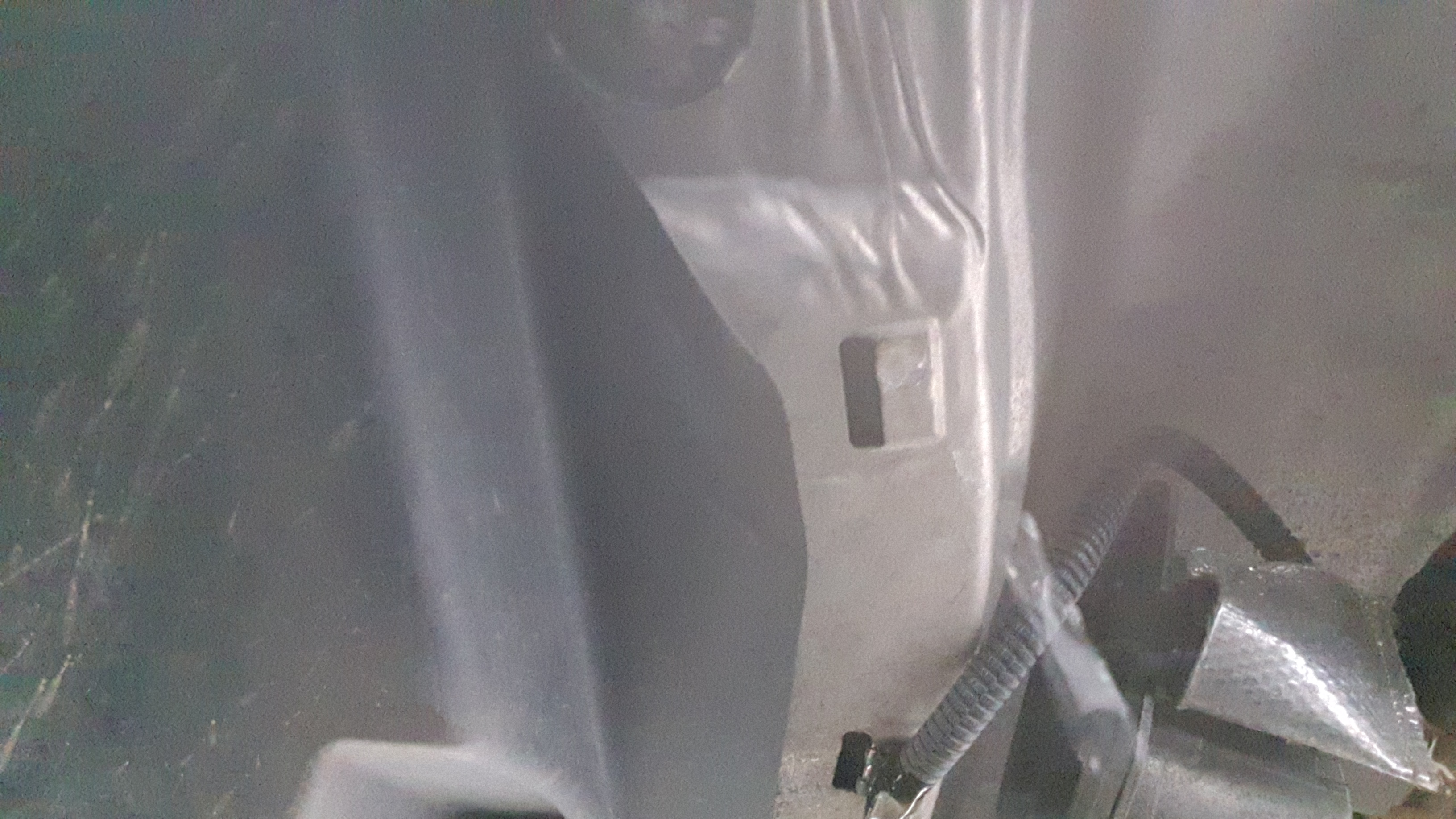

I noticed water leaking from the bottom of my car today. And it was so much that is was creating medium sized puddles under my car. Pics and video attached. After driving home it has stopped, might be worth mentioning I was stationary with the engine running at the time. I have confirmed it is just water and all I have done to the car was last night fill up my washer tank..

Air conditioning on? Could be water from the drain?
The air conditioning was on! I didnt realise it drained that much then?
I'm not saying it is.  But have been caught out like this on other cars. If it's just water then that would be my bet. Others will be able to confirm. Is the water cold?
Edited by Richies83
The water was warm
Could just be air con condensation. Your car is wetting the bed :D

Had a similar problem a few days ago after finding a puddle of fluid on the ground at the front of the car about where the under engine panel meets up with the front bumper mind it had been a very hot day. All other fluids seemed to be at normal levels and no warning lights have come on. Joe
It's not a problem. Any aircon system will need to dump condensate from time to time. Thos systems in cars are no different.
+1
Also it can be quite a lot, depending on humidity and outside temperature.
