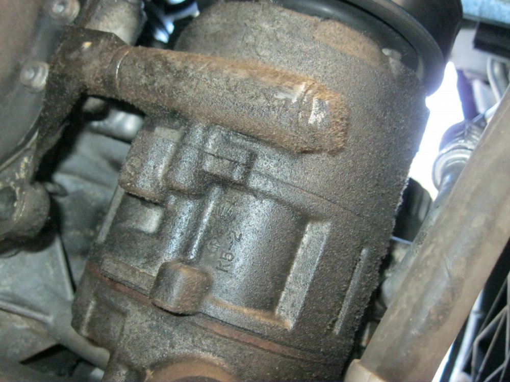

For the last few weeks, I have been having rattling noises from the engine which I now suspect it could be the AC compressor.
Anyways, I was wondering if there is a way to bypass the AC compressor by purchasing a shorter belt for non-air-con system? So I plan on leaving the compressor. Has anyone done this?

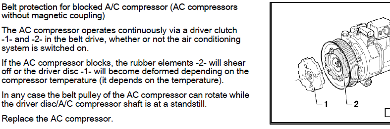

The A/C pulleys are designed to shear off if the compressor jams up, and just spin freely with the aux belt:

Thank you all for the replies. I have managed to record an audio of the noise from the engine. I strongly suspect it's the compressor as the noise only comes on when the heater/air/Ac is on.
What do you think?

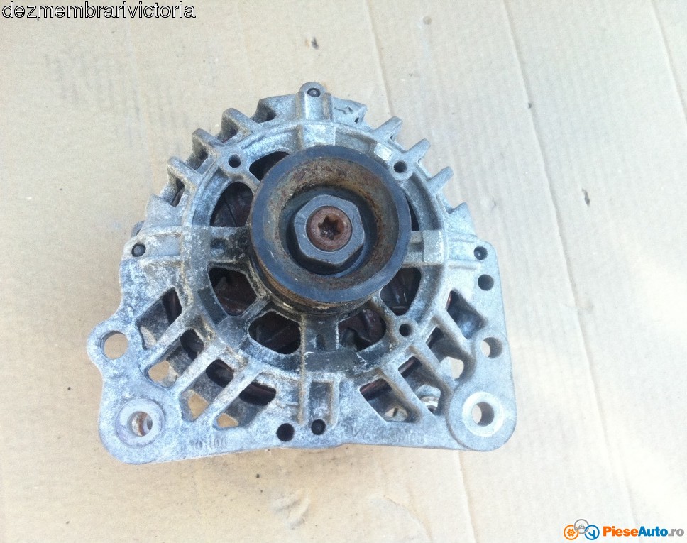

Looking for replacement part, and I'm getting a quote for £60+ for the pulley only from TPS, or a new alternator for £125 including my old unit. I'm contemplating on getting a new alternator instead, as it saves me the trouble of getting the special tool and the hassle of getting it off.

@247 I'm not at all sure your alternator has a freewheel pulley. Compare the appearance of the inside of yours in your photo with those in the videos.
Hi Wino not sure what to compare exactly but the pulley looks exactly like this
  • Sponsor
The image you see before pressing play on the second of the two videos above is what yours would look like if it was a freewheel pulley. Yours is a fixed one, there's no 'innards' there to do any freewheeling.

Thanks for the advice, it makes absolute sense as i was slightly concerned that my alternator pulley looked a bit different.
