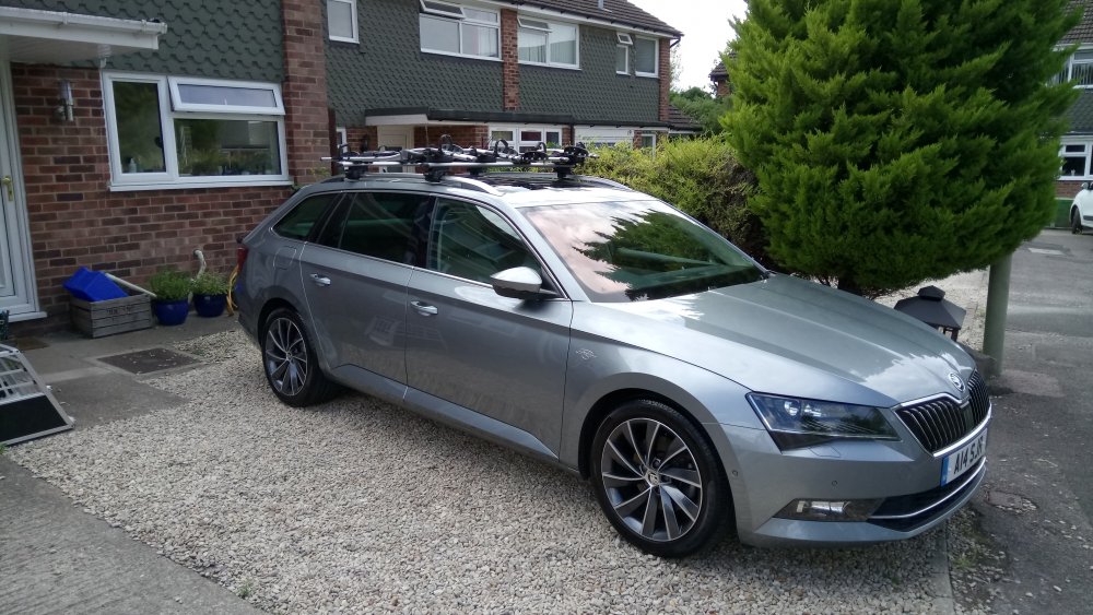

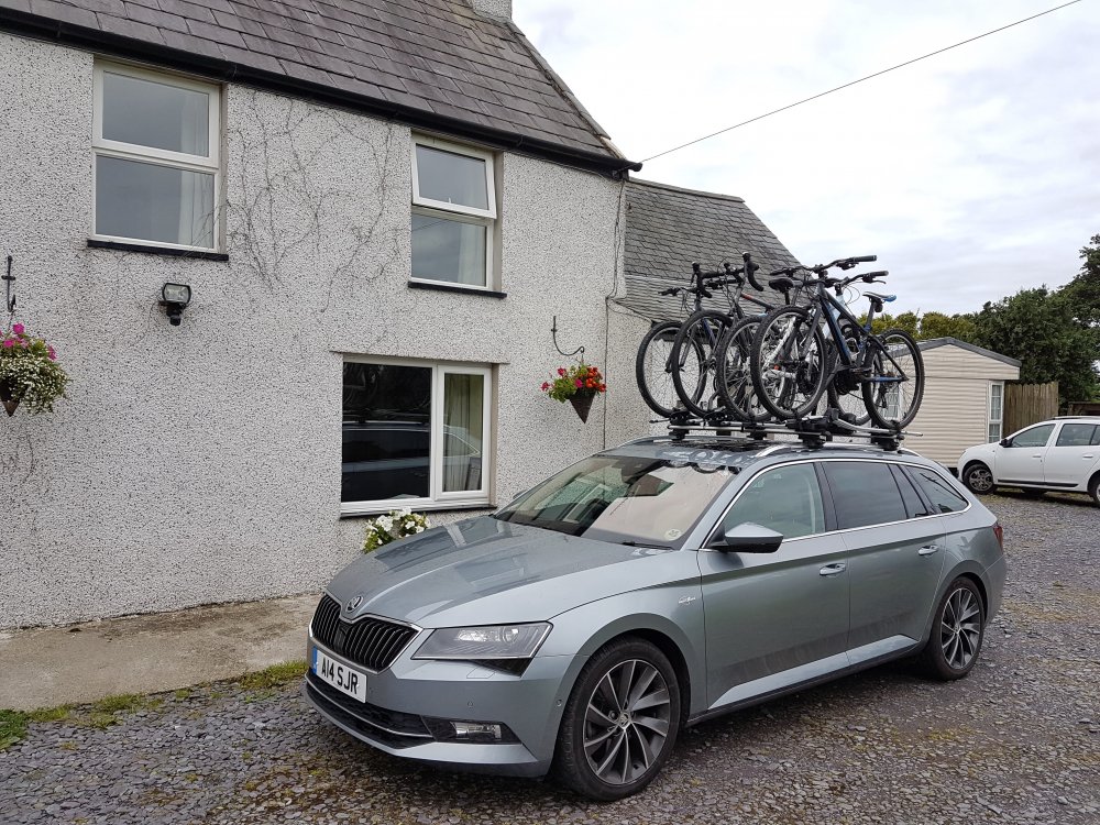

Hi I have used the Thule 757 feet with success to transport 4 bikes, see attached photos, there is still enough room to open roof if you wanted to but you get a lot of wind noise.
Edited by Simon-R
