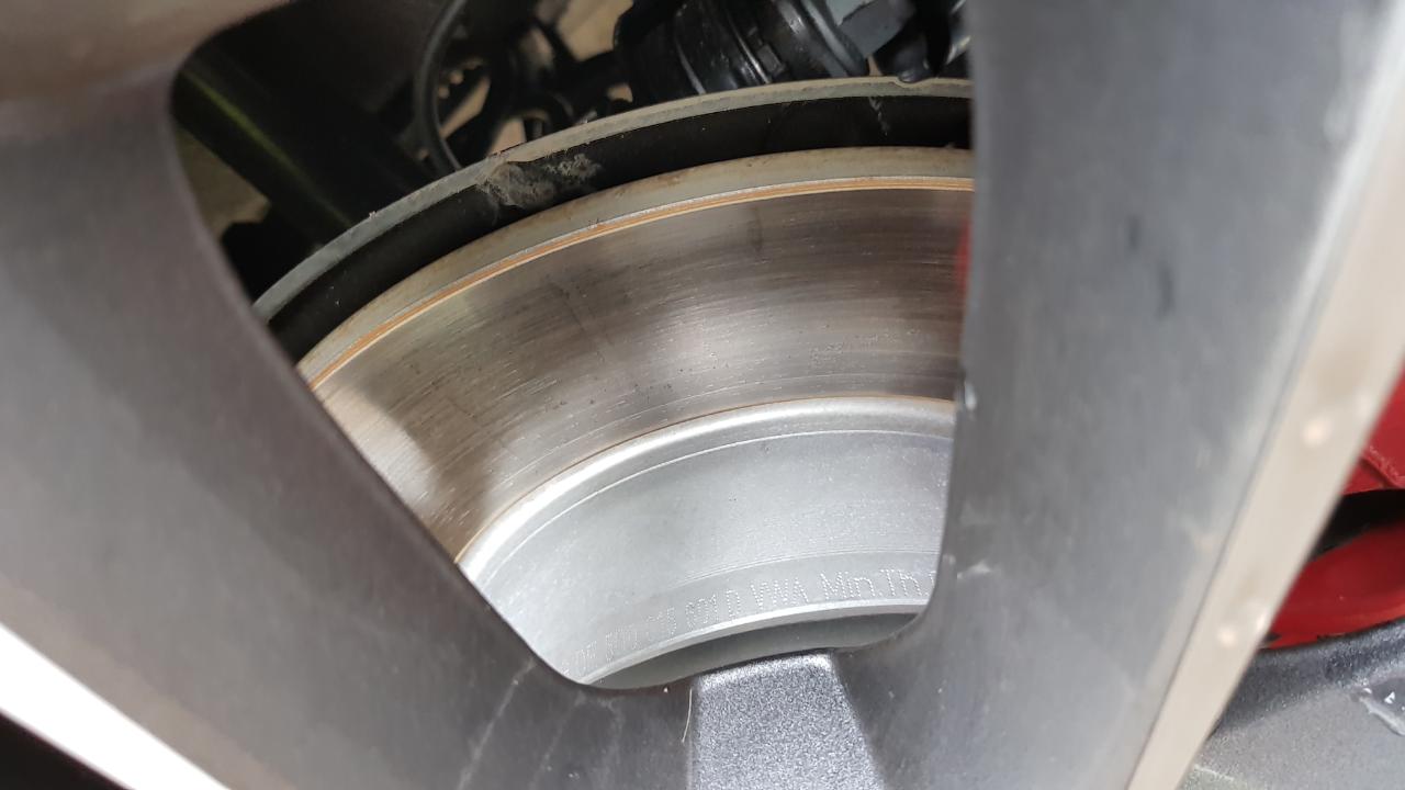

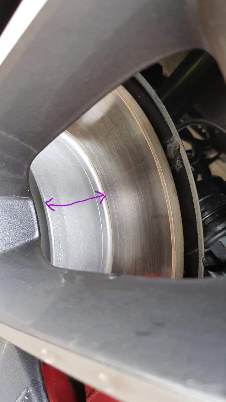

Can someone with a FL car please measure the size between the disc and the wheel? Meaning the space between the disc and where the wheel attaches to the disc.
I will measure mine also and report later.
So you mean the length of the hub basically? Like this? If so, I'll measure mine later this morning for you.
Yes, that exactly :)

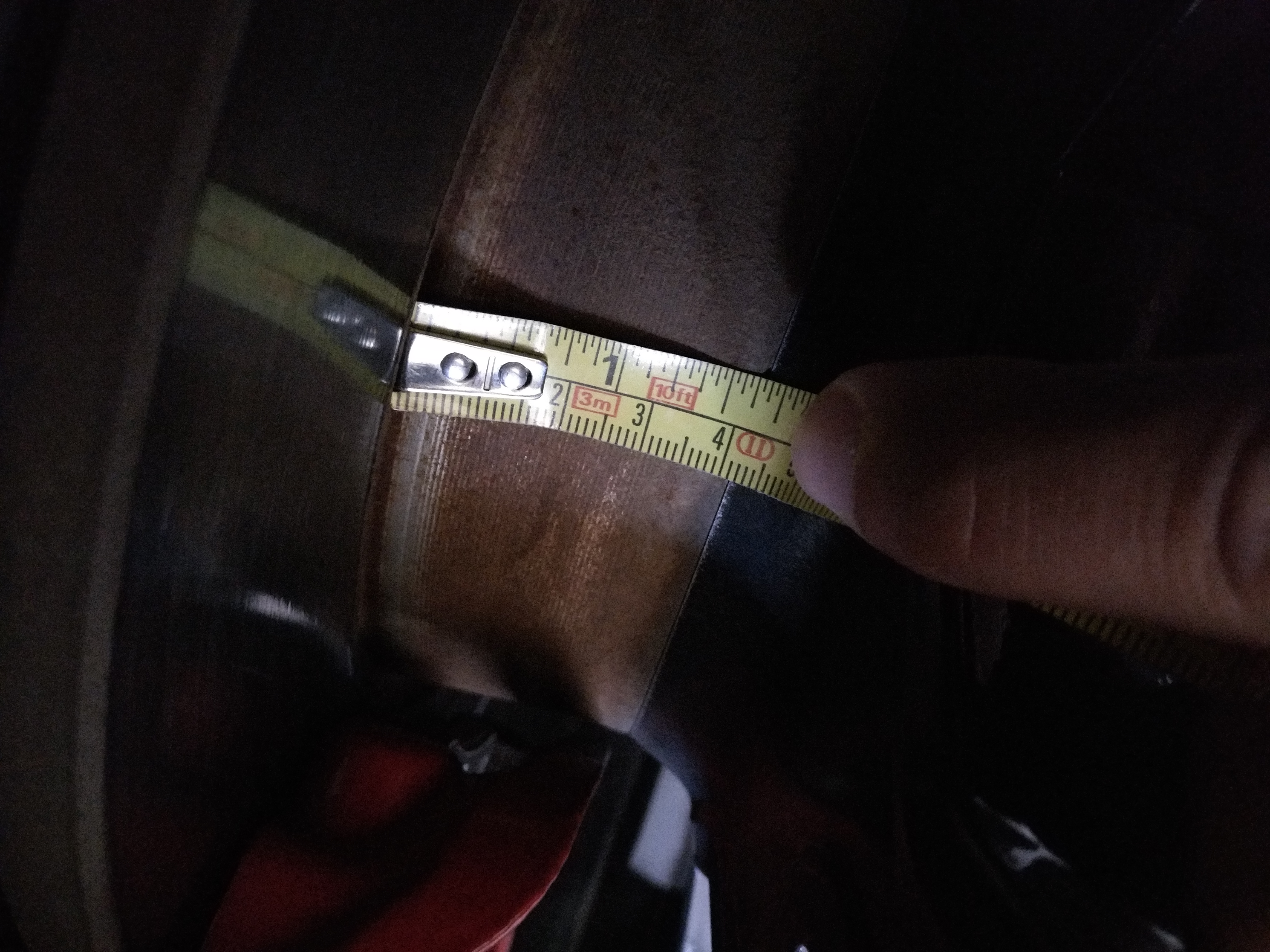

I will be going out in a few minutes so, I can measure mine also and then post here later when I come back in a few hours.
Just measured it as best I can without taking the wheel off. Its 41mm from disc surface. There's a slight recess where the disc meets the hub, but I measured 41 from face of disc to the wheel. Hope that helps :biggrin:
Hmmmm. might be able to go R18/35/255
Hmmm... It helps, but sets us one step back, cause this is from my pre-FL, which means at least the disc is the same size... In other words, it has a different suspension setup on the FL:
