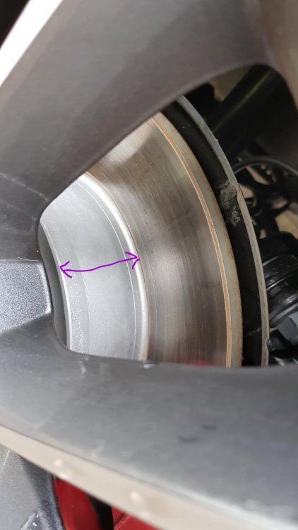

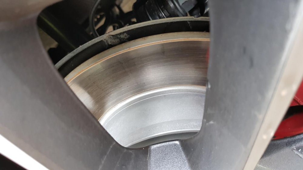

Given it seems it was not the hub/disc (based on the crude measurements we did earlier) it might even turn out the changes are simply too expensive to realistically consider, but let's still try to find out.

...the hubs it isn't, since we have measured those.
