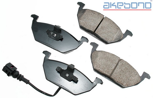

Image of Akebono part:

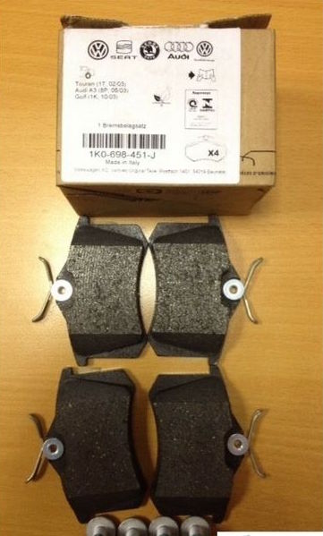

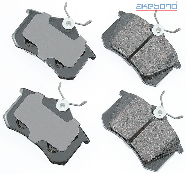

Image of Skoda part:
