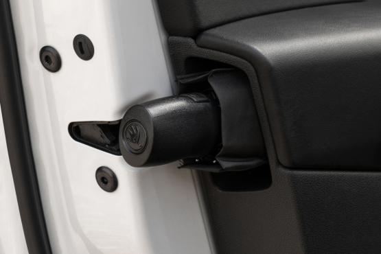

Open the front doors and check on the sides.....the umbrellas are neatly tucked in there.
