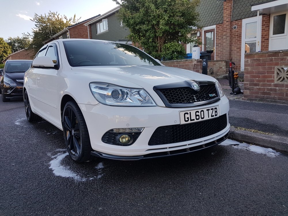

Lovely looking motor mate.

Thanks mate it does look great visually how I want it.. Keep thinking dropping it 30mm on some decent springs h&r... But don't want to loose the ride or ground clearance as it's a expensive splitter my Mrs already smashed it off once with a dead badger...haha..

BTW you have something on the bottom of your front valance which looks like it could be very helpful to avoid damage. I keep grazing over high kerbs and its been annoying me because the bottom of my valance is scraped and I'd like to avoid that. Is that what that part is intended for? I'd like to get one. Where and how much did it cost? Was it easy to fit?
