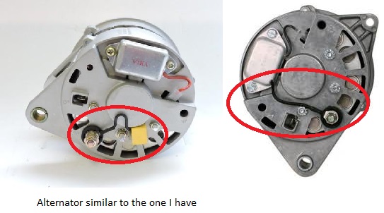

I've searched the alternator's part number (047903015J) on the web and was given 2 different 'versions' of it. The image attached shows the difference. Maybe the new regulator I've got eliminates that 'yellow box' thing which my current alternator has?
The new voltage regulator has the correct code. See below how to connect it.

Hi Ricardo, So basically I 'eliminate' that yellow module?
You can leave it on.

Cool .. I'll try it and update. So what actually is it that yellow box?
The symbol on it says it all. It's a capacitor in parallel with a diode.

It worked like this.
