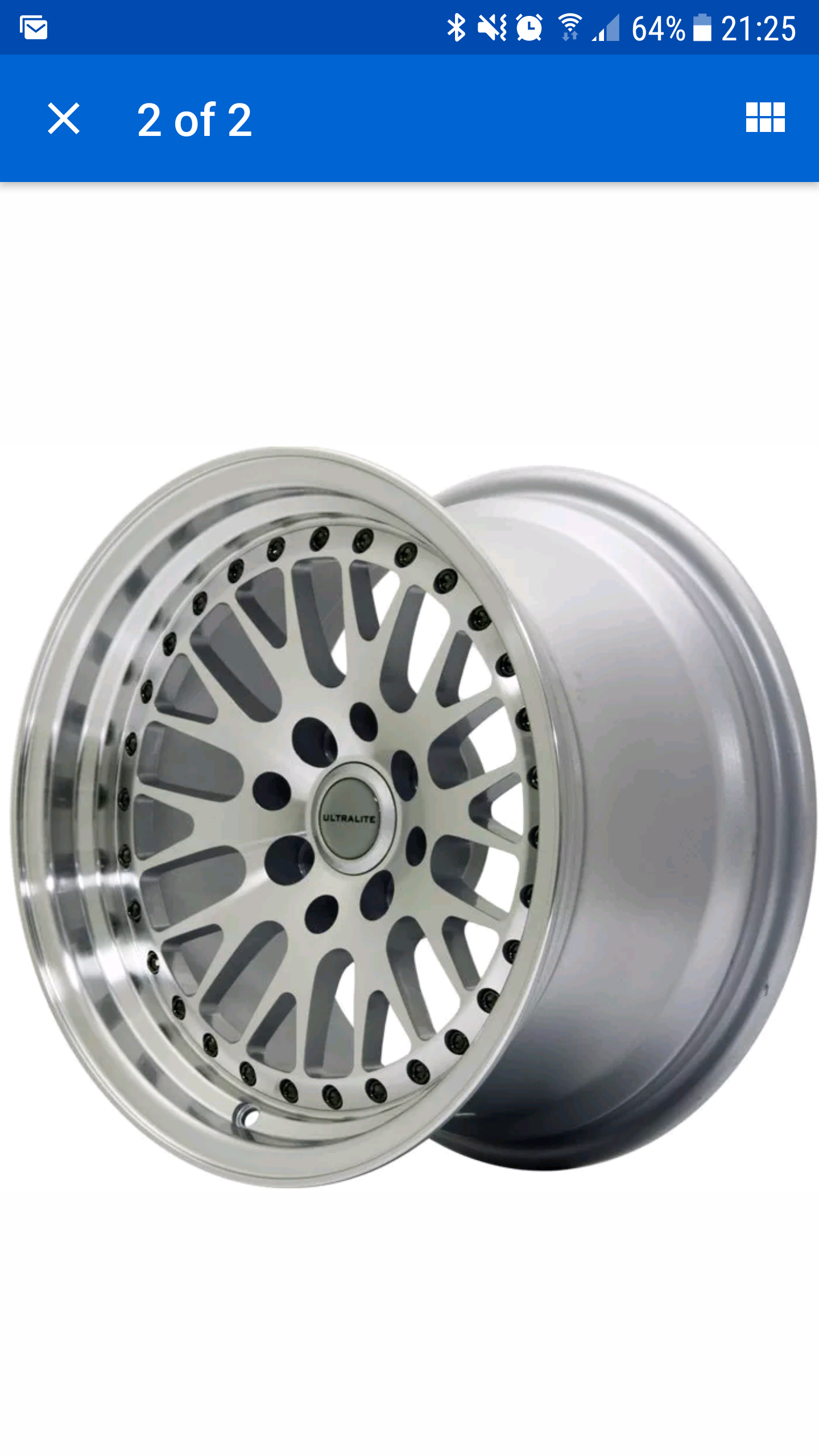

Hi guys just looking for bit of help am new to this too does anyone have any knowledge of wide wheels for the pickup was looking at a set of r15 9j and 8j for it would they be Ok?

Hi if it helps I have 7x15 azevs fitted to mine et 35 with 205/50/15 tyres and the back ones rub the shocks slightly when fully loaded but fine when empty.  They are about level with the top of the wheelarch when looking down from above.
Any wider than that and your looking at spacers and arch extensions
use this site to compare wheel sizes
willtheyfit.com
