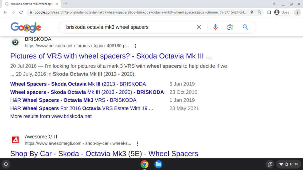

You need hubcentric spacers as they will have the recess and flange to receive and offer the little lip to interface with the hub and wheel.  Do a search on here for them as there are link in an older thread for quality items from ebay.  Yes they can be a pain to line up.  I have a little ali rod (from amazon) that has the same bolt thread that fit into one of the holes.  It's 4-6 inches long and means you can line everything up, chuck a couple of bolts in the other hols then take the rod out to use for a bolt.  Makes life a lot easier.  It live in my car for the emergency situations.  Do a search for "wheel alignment tool" and select the right thread.  I cant remember if it's 14x 1.25 or 1.5.  The extended bolts make no real difference with how easy they are to fit.  In this instance a bolt's a bolt.  Just make sure it's long enough and the right thread and head shape.
