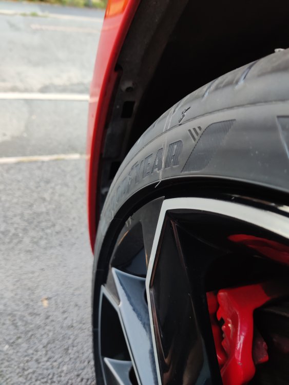

The Goodyear Eagle Asymmetric 5 offers decent rim protection, shown here on 19" rim.
