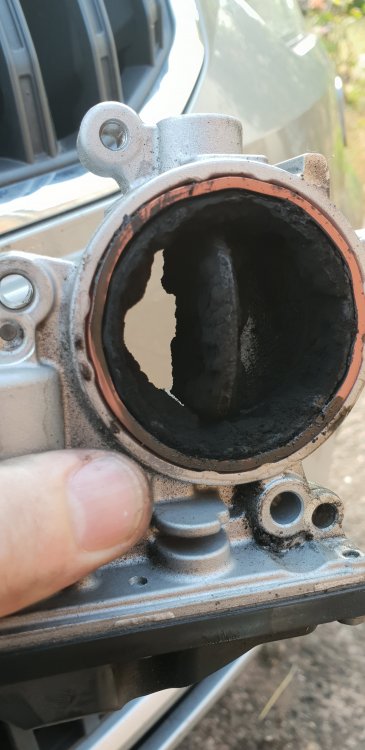

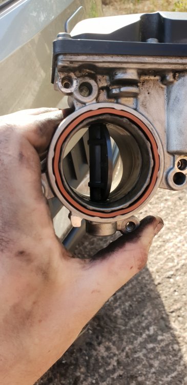

So looks like the Skoda technician may have fixed it. There is a known problem with a scheduled service action on Audi and VW but strangely not standard on Skoda (yet).
What happens is where the EGR circuit connects into the air intake just beyond the throttle, there is an internal nozzle in the manifold that points back down towards the incoming air - directly at the throttle. If the throttle is closed and the egr open then it cakes the throttle body in soot and tar that dribbles down the air hose too.
Fix is to file a new location notch on the nozzle and rotate 180 degrees and five the throttle a good clean with carb cleaner. Did a 5 mile drive with the tech running diagnostics and it didn't have any of the odd spikes I was seeing on VCDS where the throttle seemed to stick. Felt like driving a different car too - better acceleration and less gas needed pulling off.
Will keep an an eye on VCDS for pending faults but hopefully that'll be a fix. Was frankly amazed how clogged the throttle was for 3500 miles on the clock (see pictures although some soot had been removed before I took them).
Was also told that that the two local garages fobbed me off - if I had driven to them after Skoda assist they are obliged to look at the car within 48 hours and provide a courtesy car.
  • Sponsor
Yeah, me too. :blink:
Unbelievably filthy with regard to the mileage.  It might be a fix, but certainly not a good solution to the original problem.
I'm hopeful that turning the nozzle to point into the engine rather than the throttle should help but I'll probably get the garage to take the throttle off next service and check it again.

This was done under warranty by a Skoda technician at the roadside through Skoda assist. You should have three years to get this covered under warranty. No cost for me.
The job isn't hard although the unit needs unbolted from the back by reaching under it so the chance of dropping bits is high. Moving the nozzle just needs a notch filed out and the whole block cleans nicely with carb cleaner. Also needs the service light cancelled out.
While a competent garage could do this, I'd play hell with Skoda that this is a standard service action on other group vehicles.

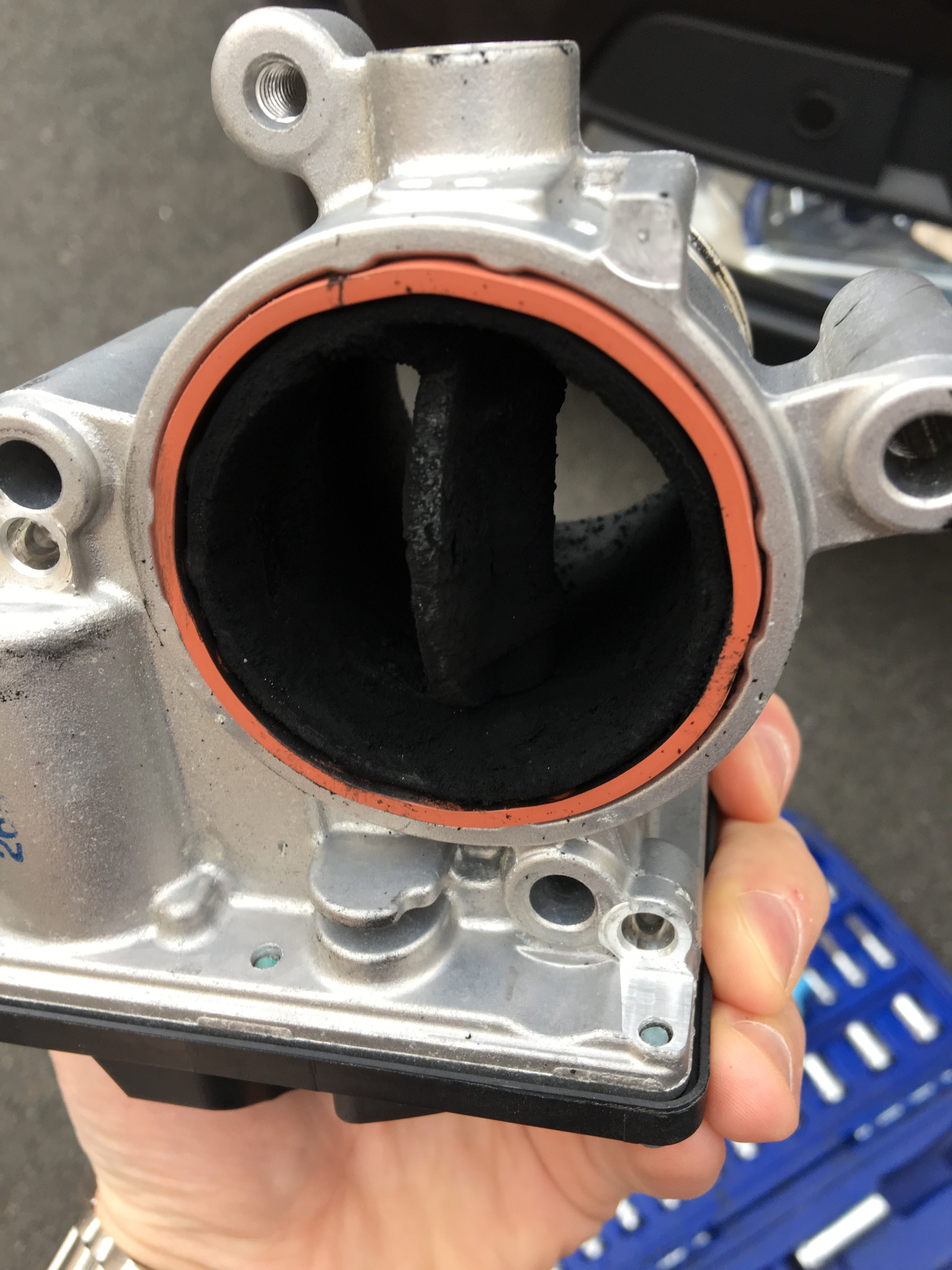

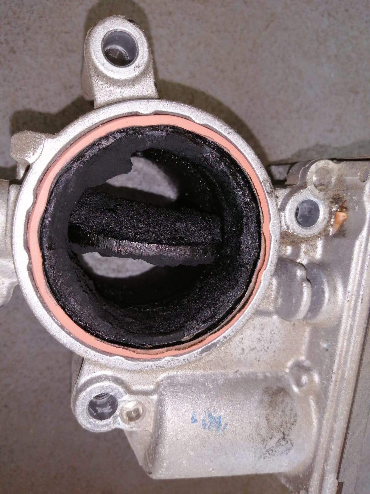

Many thanks to tkerby and Yeti_Stu for the guidance and photos.  Found similar amazing amounts of black crud in the throttle body on our 2013 45000 mile Yeti, cleaning has improved performance and cleared the engine light.  Nice simple job - if you have the dexterity of a surgeon, the hands of a small child and the strength of a wrestler!
Mark

Just had same problem. Fault code was P012100. Was sorted within 24hrs at Skoda Bradford. Thanks to the team there. Credit where credit is due, always get great service.

We had this code twice over a 6 month period - car cutout completely, but restarted afterwards. Code both times was P0121. Our local Mr Clutch cleaned the throttle for £80 which seems a fair price.
Our Yeti has had all the textbook problems - Clutch breaking the gearbox, pinhole rust on the doors, drivers airbag sensor, noisy air intake - the internet has been kind with all the solutions!
Just a note to say it’s a 63 plate 4x4 2.0 Yeti Adventure - and this had not been cleaned before.
The mileage would reveal far more than the age, how many has it done?
Mine looked like that at 82K miles, the emissions fix had been done but I dont know how long or how many miles before.

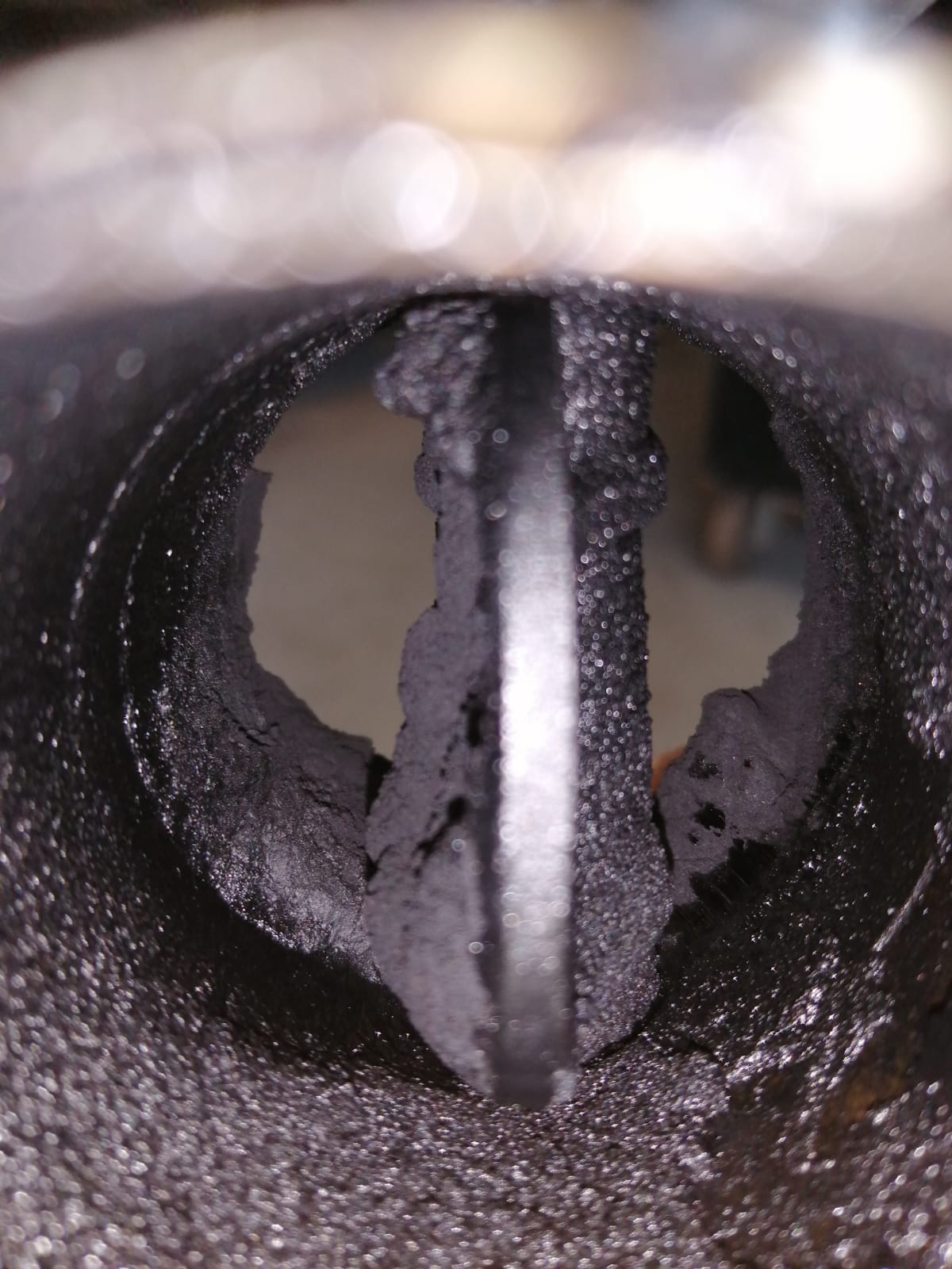

I have been meaning to expose it again so I can put an endoscope down to see if the clag had gone as far as the intake ports & valves, I have done 10K since the clean up so it will be interesting to see how much has returned & if I need to clean it again after a year.
69,000 miles. (Honestly shouldn’t have bought a diesel! 🤦🏼‍♂️😂)
I think that mine had either been cleaned before or had done a lot of motorway miles, it will be very interesting to see how much crud a year of lockdown journeys has added, I have now fitted an EGR emulator/simulator so there will be no more crud but I should remove any that has built up since my last clean.
the car drove so much better afterwards and the fuel economy increased by about 12%!

From having this cleaned back in April 2021 - the same errors are coming now end of September 2022 - just under 80,000 miles on the clock.
Booked in to have it cleaned again. Will ask for photos again.
