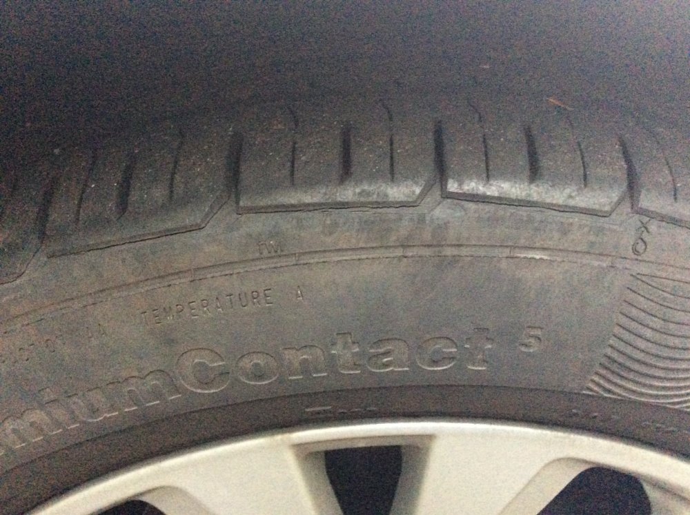

Should I replace this tyre with cracks?
Should I replace this Continental tyre with cracks as shown in the picture? About 5.5-6mm tread left in it.
Yes
your life is worth more than a tyre.  I'd certainly put new tyres on the same axle and if in any doubt I'd change them all.

How old is the tyre according the date code on the side?
Continental tyres are prone to early cracking.
Rear tyres, tyres which are run with too little air in them and
tyres that are regularly cleaned with tyre embellishment cleaner will also start to show cracks early.
Can you swap it from the N-S-R to the O-S-F and wear it out quicker.

Too dark outside just now to get the code printed on the tyre, but I think that it's probably been on since the car was new, which makes it around 4 years old. The car has done 23k miles.
I discovered today that one of my wheels is slightly buckled (said wheel was on O-S-F and was moved to N-S-R), so I'd resist swapping. Also, tyres on rear axle are Altimax as opposed to Continental.
As as well as purchasing a new wheel, I'll probably get two new tyres for the front axle. Anyone got recommendations for where to buy the wheel and what tyres are good?
Car is mk7 Golf with tyre size 205/55/16.
Date on tyre is 1813 (18th week of 2013), so probably no chance of Continental doing anything about it.
looks alright for now, personally I would change it, but I do a lot of high speed motor way. if you're just plodding round town at 30 all day should be ok for a while.
