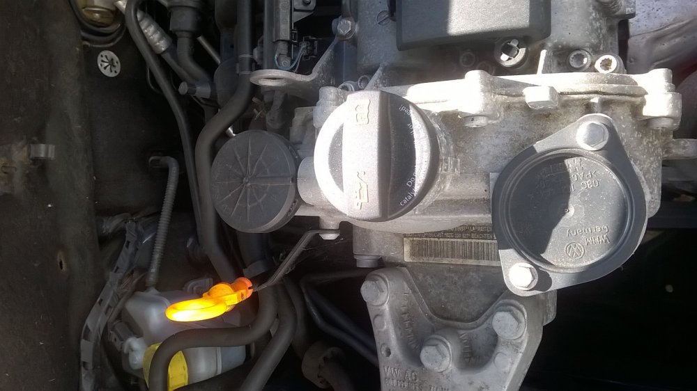

Partner has just come home and informed me the car engine has started to be pretty noisy.

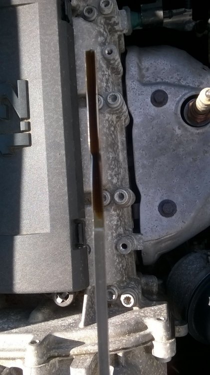

I just checked the oil level and the dipstick is suggesting there's pretty much no oil. The car was only serviced about 500 miles ago which included an oil top up and I had checked the dipstick once it was serviced and it definitely was full with oil.
Any ideas? I presume the noisy engine is connected to the low oil levels. But not sure what's caused this.

Is there nearly no oil on the dipstick when the engine is stone cold?

its a 1.2htp, I checked the oil when the car was slightly warm

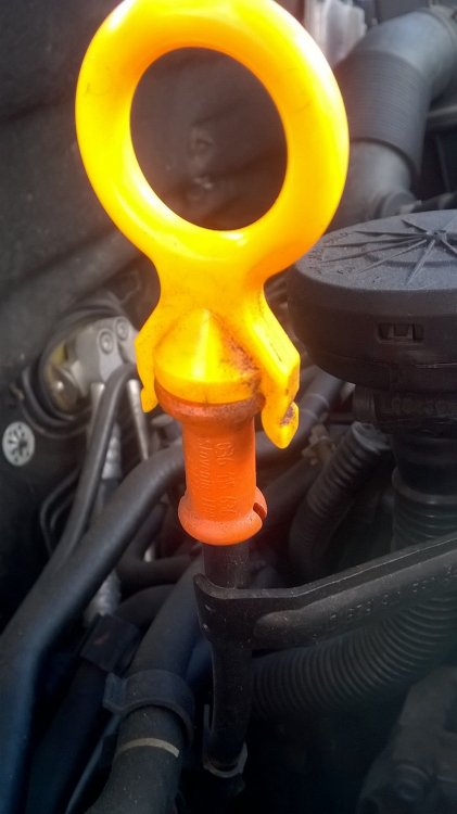

@Awayoffski done a quick check and can't see any obvious signs of oil which has leaked. This is so confusing. Only thing that seemed dirty / Greasey was the plastic undertray which is under where the bottom of the dip stick ends. But wasn't sure if that's just dirt from the road
