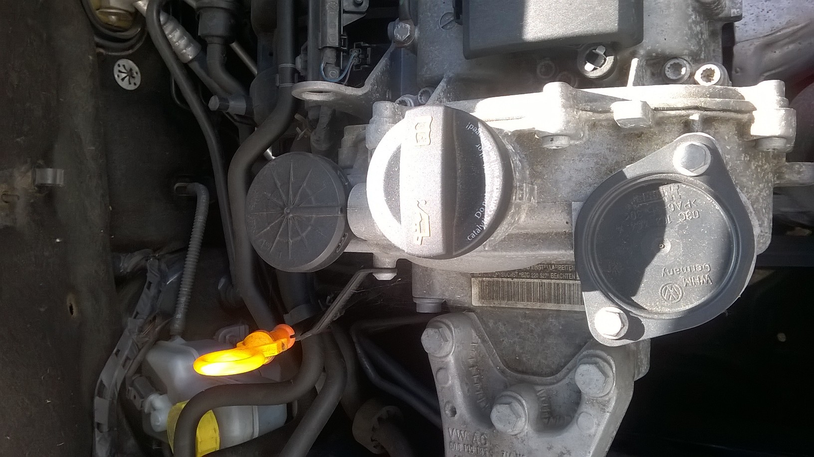

@Wino ok thanks for that! And not to sound like a complete novice. When taking the oil filler cap off, it looks like this. Is that correct? Thought it would be more of an opening if that makes sense? For the oil to go into, as was going to purchase a funnel to make it easier but don't think one will fit in there

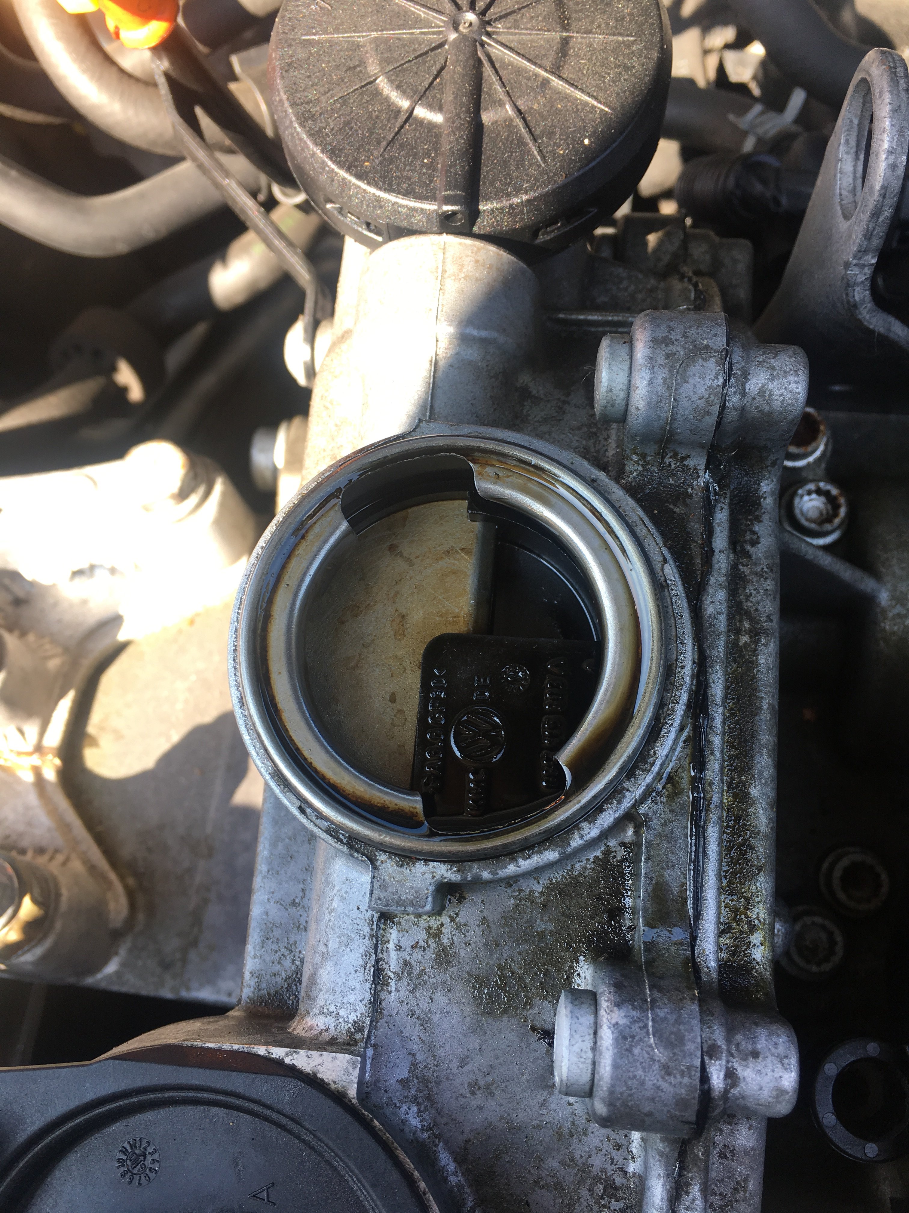

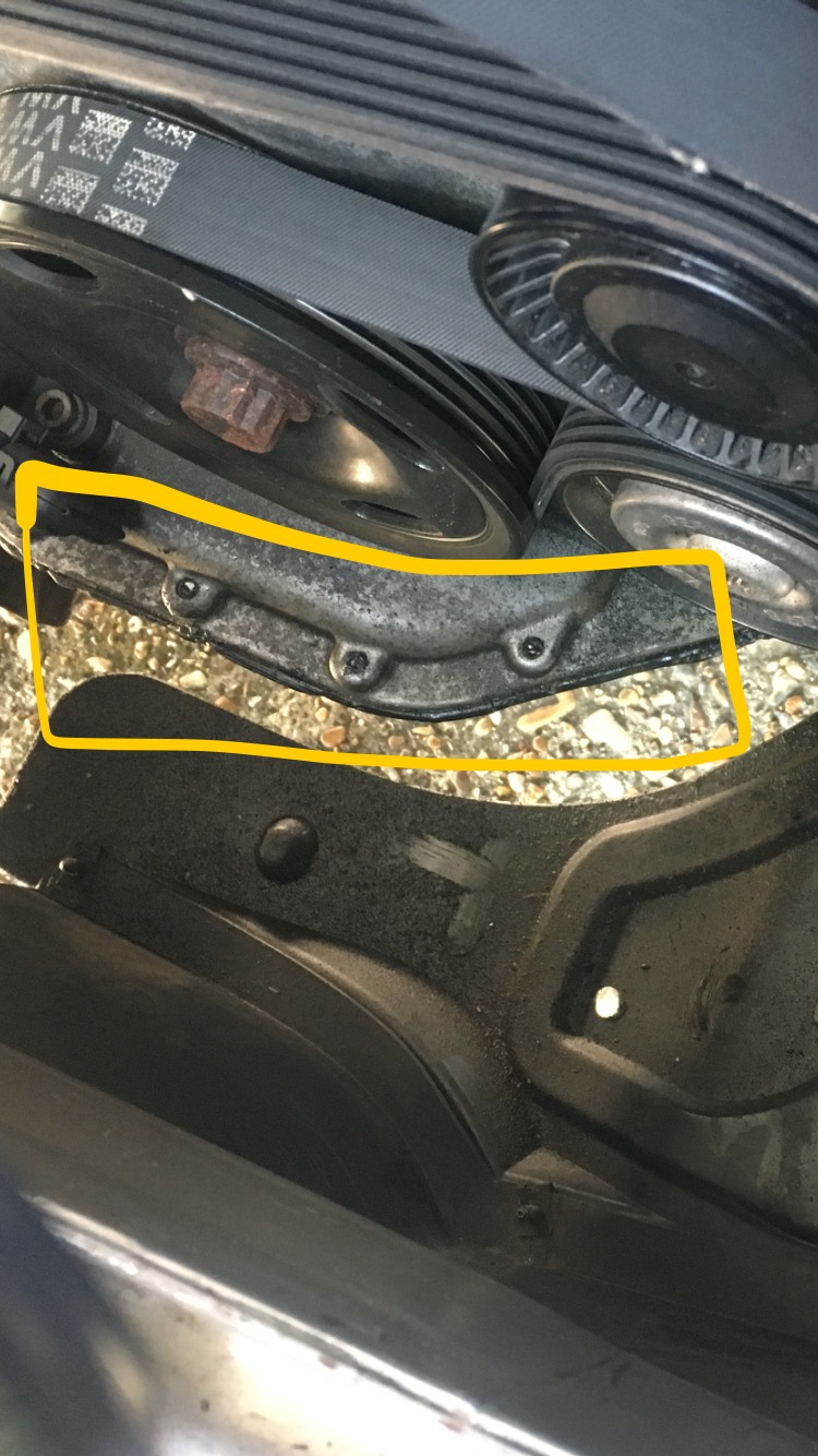

Also I've now noticed around he engine, there's bits of rubber exposed slightly. These are oily to touch, could this be the issue?  (Such as in that picture to the right of the oil filler hole) and in the second picture where highlighted.

Funnel is a good idea, but you (or an assistant) will have to hold it vertical while the oil is poured.  Pour slowly too, as it takes a while to drain round that spiral bit.  Might be an idea to transfer some out of your oil container into a smaller jug.  Pour in a pint, wait 1 minute, check level on dipstick, pour in half a pint, check level. Repeat until level is in the right area of the dipstick.
The chain cover, cam cover and sump are all sealed with RTV type silicone, rather than traditional gaskets, so some evidence of this sealant is inevitable.  Not sure that yours doesn't look more prominent than the factory original, will go have a look at ours to compare.  Yours may have been worked on since it left the factory.  The sealant near the filler hole may well have got oily due to spillage from careless pouring at the last service.

Right ok that makes sense, that's good to know as wasn't sure if it was some sort of gasket that was exposed.

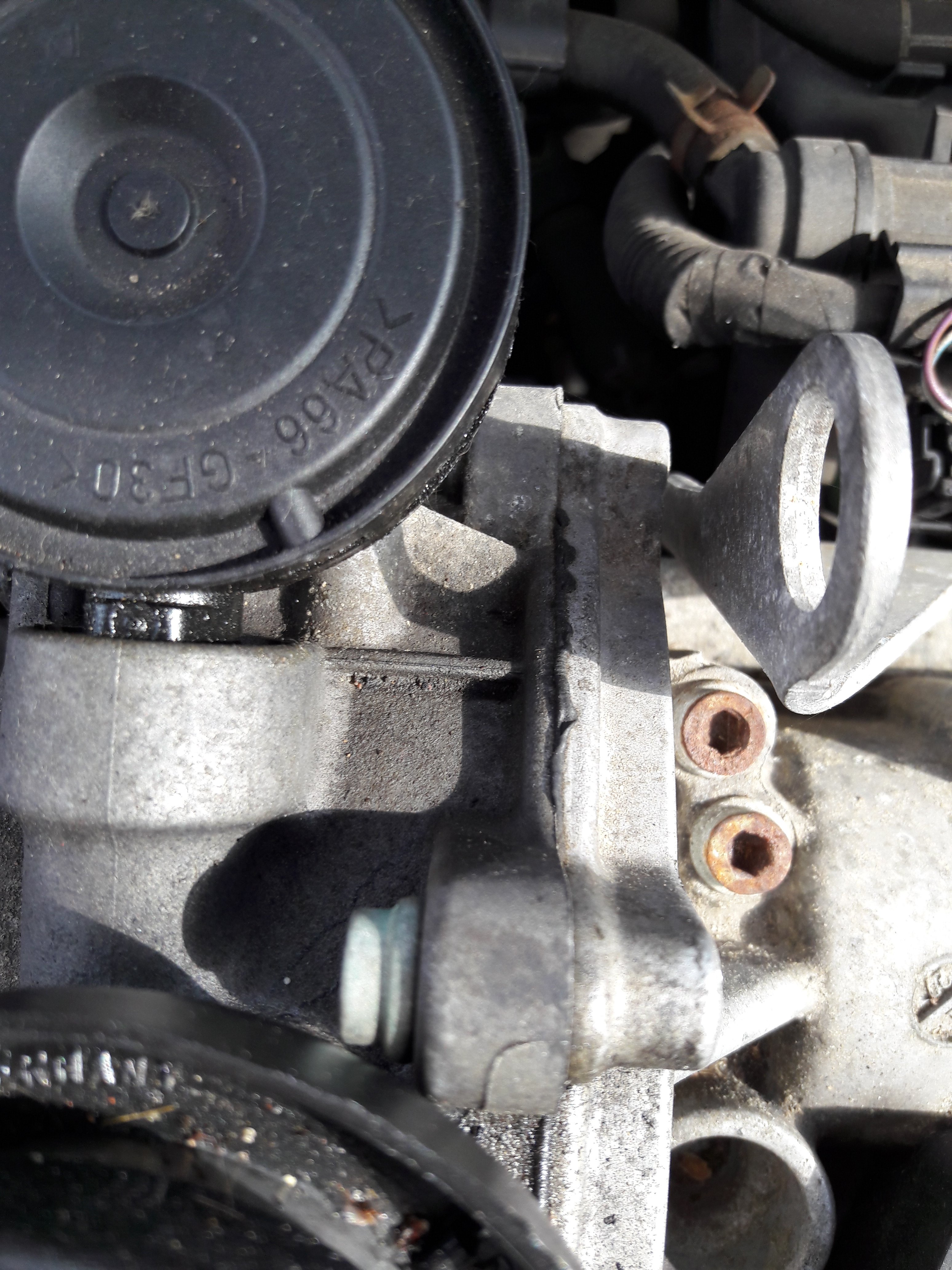

Just taken a couple of pictures of ours for comparison, will upload shortly.

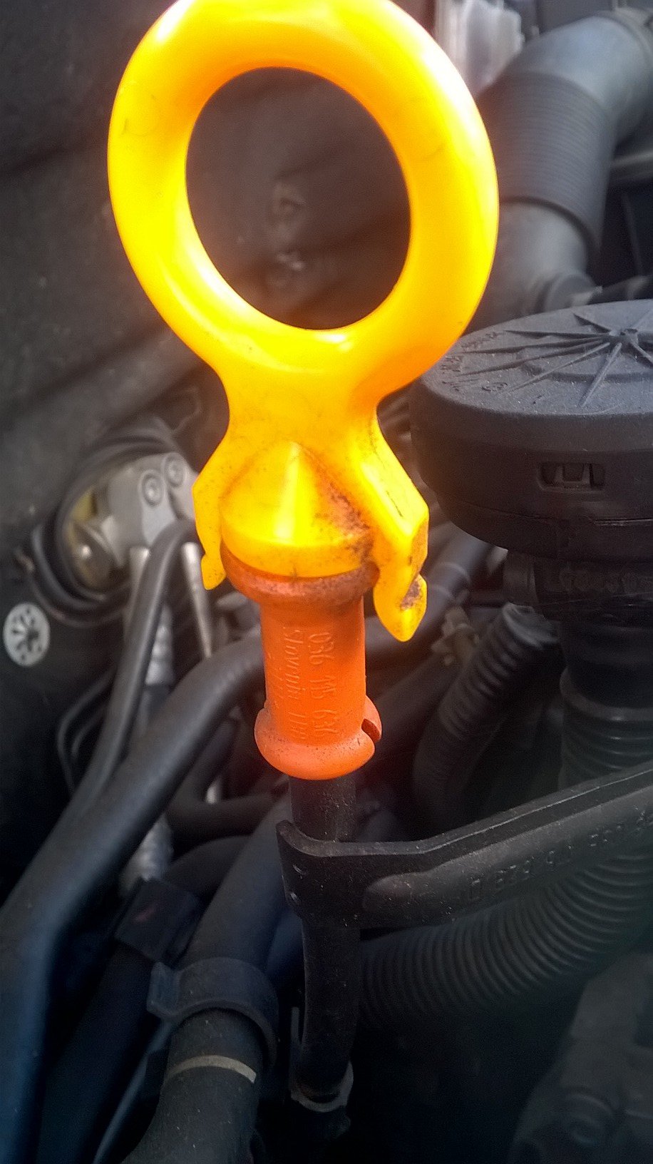

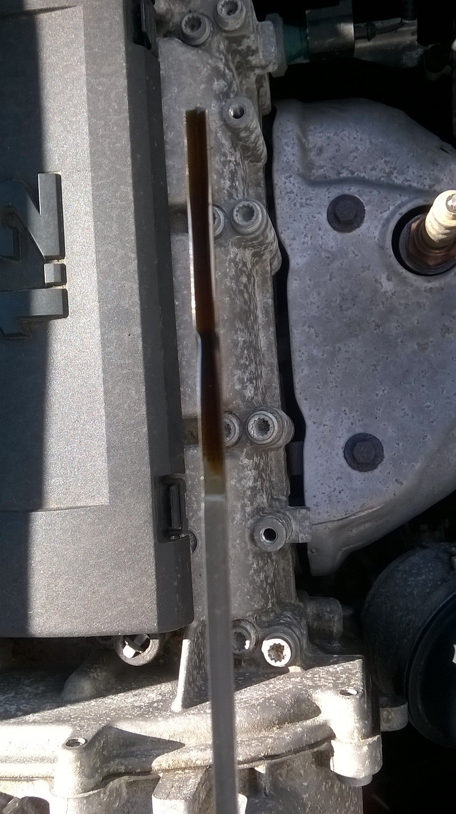

Can you post a photo of the level on the dipstick currently?

Different coloured sealant on the sump than yours, but that may just be a different part number used in the history of these engines, ours is 2005.

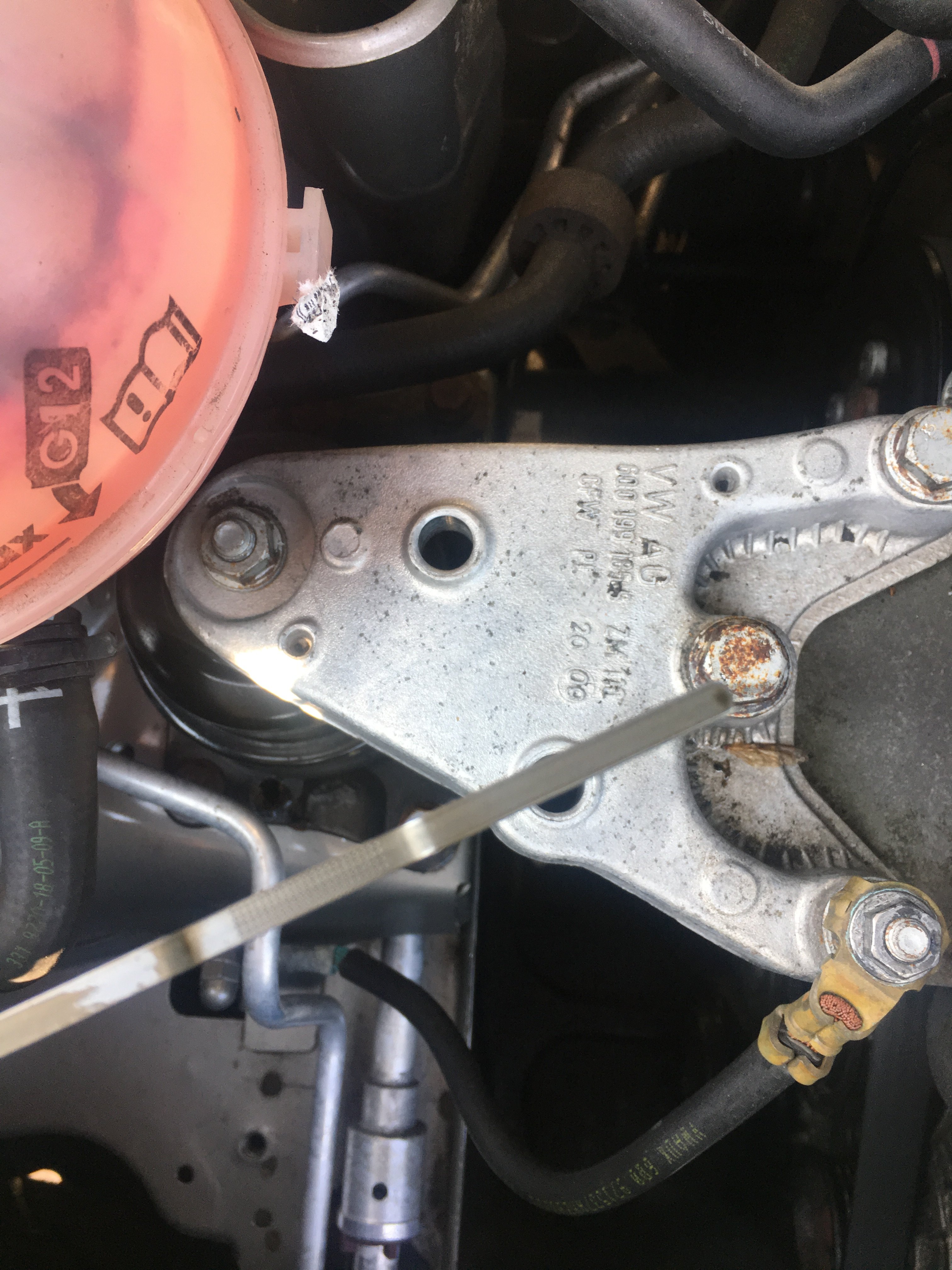

@Wino thanks mate, level on the dipstick is non existent. And no no history of anything repaired like that. I'm surprised the oil light hasn't flagged up yetIMG_5607.thumb.JPG.746c8e9ad81d2ac587036e76d20be3ea.JPG

There probably isn't an oil level sensor, have a look at the sump, anything on there with wires going to it?
@Wino ah ok will check that out, just presumed there would be one as per the handbook. But guess that's pretty generic

By the way, in your dipstick photo, there's an earth lead coming off the engine mount that looks - in the photo - like it's just been cut off. Presumably that's just the way the photo has caught it?
Just checked our 2009 Blueline 1.2 12v.
WP_20170902_001.thumb.jpg.6fe6a24f95d565176228851d40ce9c26.jpgWP_20170902_003.thumb.jpg.f614ab52094531bd7375b0518509e106.jpgWP_20170902_005.thumb.jpg.d7f65a6c3a58d08ddb1c141d895e80fc.jpgWP_20170902_006.thumb.jpg.d9a0f510de3d0b1b6d38dd52333eac1c.jpg

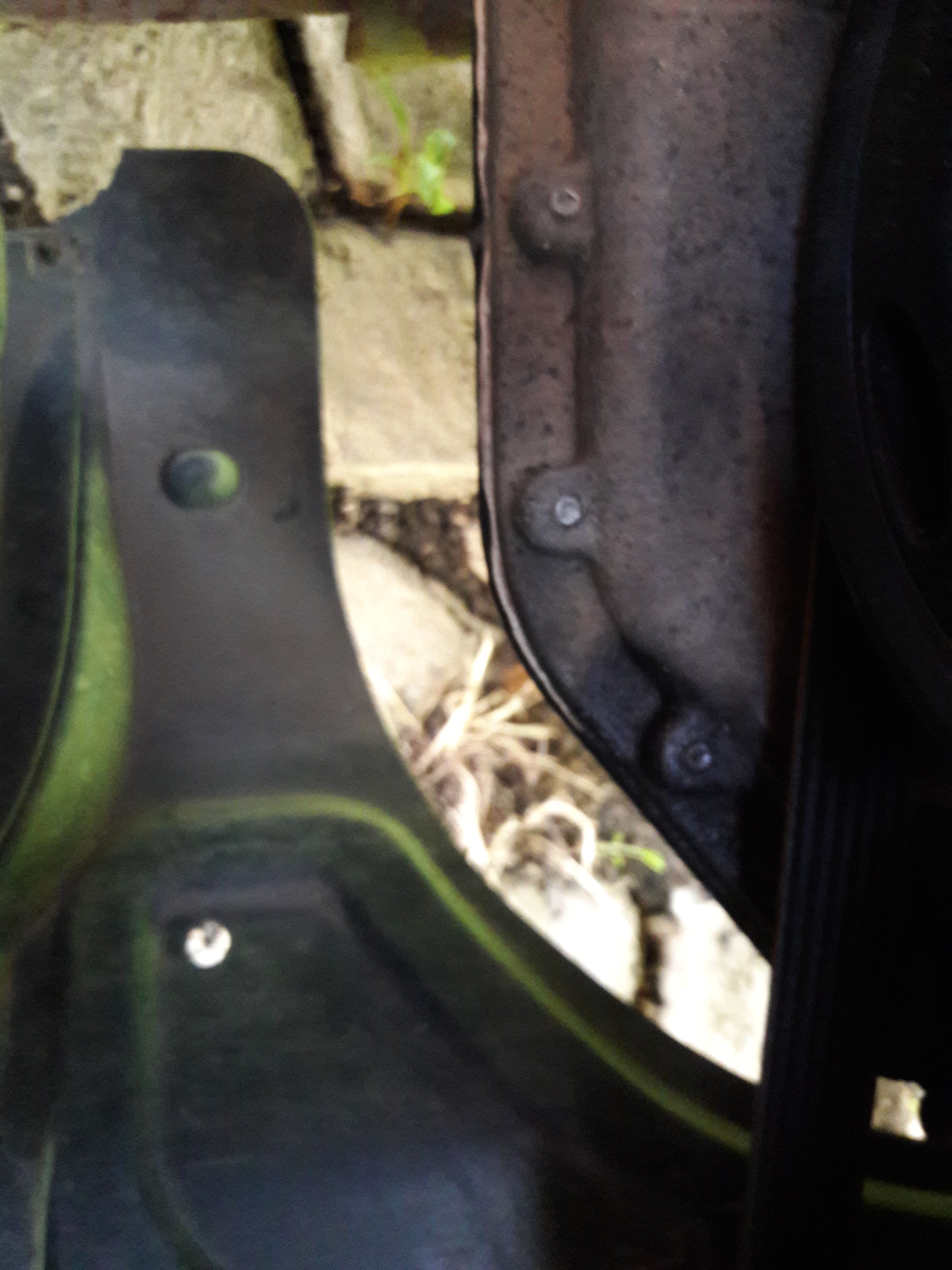

Hi there, sorry to see you are having trouble with your car. This may sound silly but have you checked the sump plug is done up properly because on my 1.4 fabia 2 I failed to tighted the sump plug up enough meaning I lost a lot of oil. I am not sure if this is also applicable but my engine liked shell helux ultra 5w40, you can get 5l for abou £22 on carparts4less.
@Wino just double checked but yeah just the angle of the picture
@moley thanks for the pics helped alot
@fabia88 haven't checked that yet, but have briefly checked under the car and can't see any leaks. What do I need to tighten that up, and does it have to be tighten up to a specific torque?

On our htp the sump plug has a female 6mm hex in it, so a 6mm male hex bit to do it up.
30Nm rings a bell. Will double check that and correct it shortly if necessary. Yep, 30Nm is right.
If it's loose enough to have leaked a load of oil, it should be obvious once you look under there.
