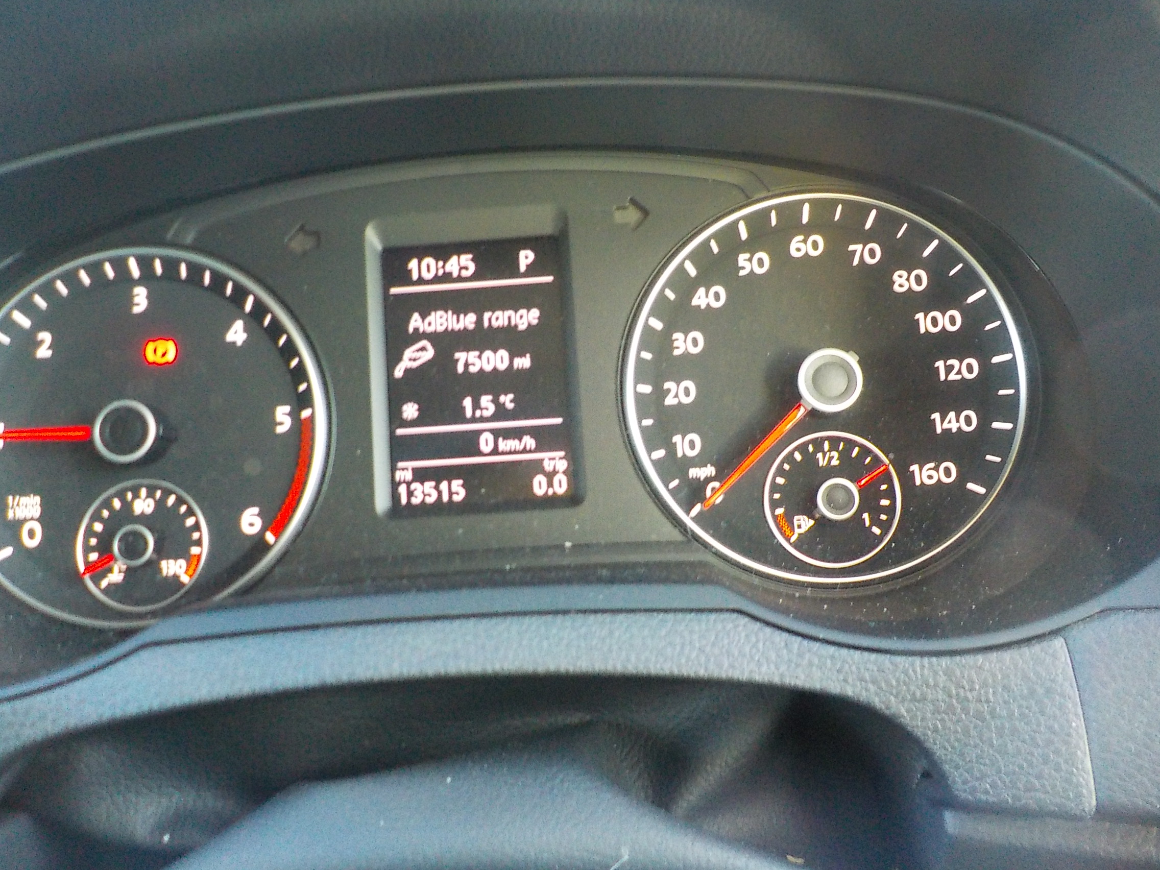

My 150 sport line DSG needs ad blu too.
The counter states 6500 miles until a refill. Car now has 50 miles on clock.
First car car with this so
Does this sound right?
How much to refill?
Does not allowing the car to regenerate (short journeys) reduce the countdown quicker?
Thanks in advance.
I got a MY2018 150 TDI DSG in September 2017, it has AdBlue. Apparently 150 TDIs with DSG and 4 wheel drive now have AdBlue and 150 TDIs with 2 wheel drive and manual gearboxes don't have it.

"Does this sound right?" - roughly - mine started with 7500 miles but went to 6500 fairly quickly

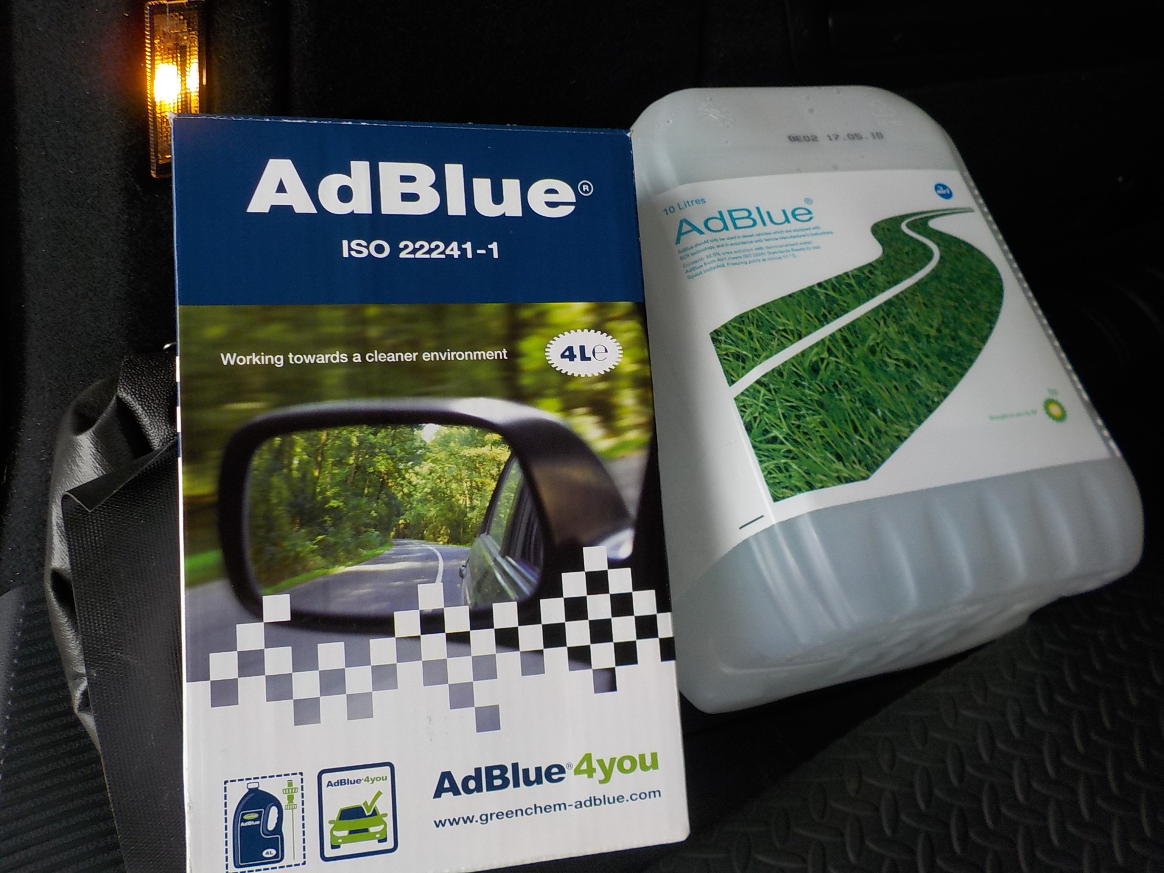

I went to buy some adblue from a lorry refuelling pump at a petrol station but was told the delivery rate was too fast for a car to take as it was specifically for lorries with large volume adblue tanks The forecourt staff informed me that when the normal vehicle fuel pumps are replaced the new ones will have have an adblue filler for cars. I had to buy a 10ltr container.
Some people saying use a forecourt pump and other sources saying the flow is too great for a car. Anybody able to give their personal experience of using the forecourt pump for delivery of car Adblue?
http://briskoda.net/forums/topic/436660-adblue
Welcome.
Use them carefully, or do not use them.
If you do not want to fill into the vehicle at the pump take a Clear 10 or 20 litre empty Ad-blue container with you and fill that carefully.
Then fill the vehicle at your leisure and do that carefully.
Or just buy in containers.

When mine first needed Ad Blue, I bought a hose that screws onto both the Ad Blue filler neck on the car and a 10 litre container and I also bought a 10 litre container of Ad Blue.  I made sure everything was clean and chose a dry day to fill it.  It took three or four minutes standing with the container high enough to feed by gravity, but it was easy and there was no mess or spillage as the hose seals off the filling process.
I bought the hose from eBay
https://www.ebay.co.uk/itm/Genuine-VOLKSWAGEN-AUDI-SEAT-SKODA-AdBlue-Filling-Hose-000012499-For-5L-and-10L/182638478152?epid=895328726&hash=item2a861a0348:g:TY8AAOSw5cRZHway
