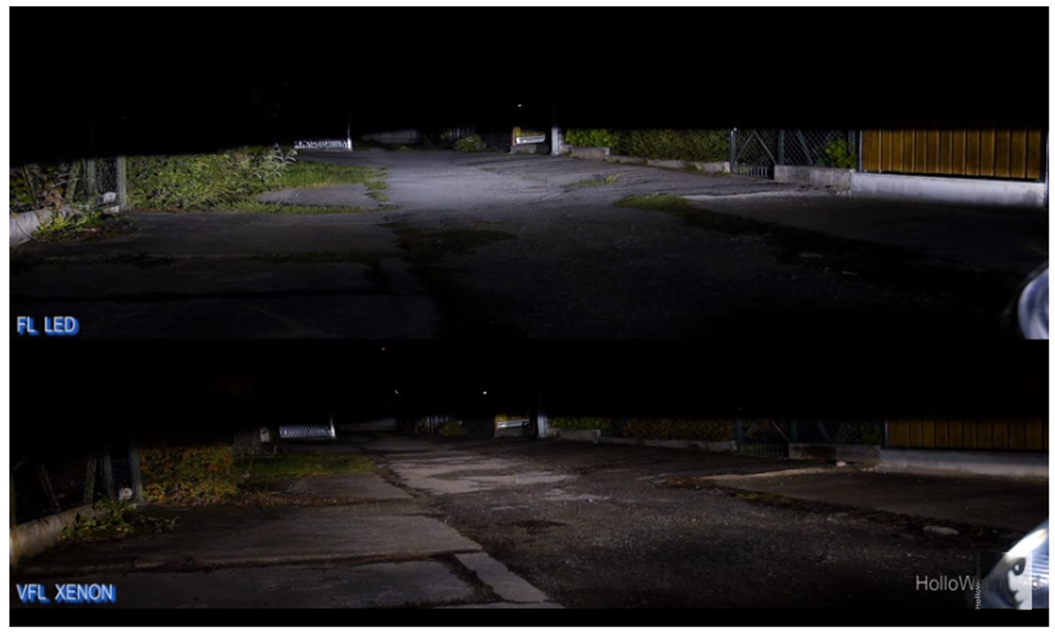

Good comparison video, I enjoy hollowmanvid's videos on his channel.
The initial comparison seems to favour the Bi-xenon, in that the bit closest to the car is better lit. On dipped there isn't a huge difference, but the full xenon beam appears to be better than the LED on full beam as there is a wider spread of light.
Agreed, a very good video.
I too was surprised to see that the bi-xenon's from the pre-facelift do seem to have some discernible advantages over the facelifts LED's...

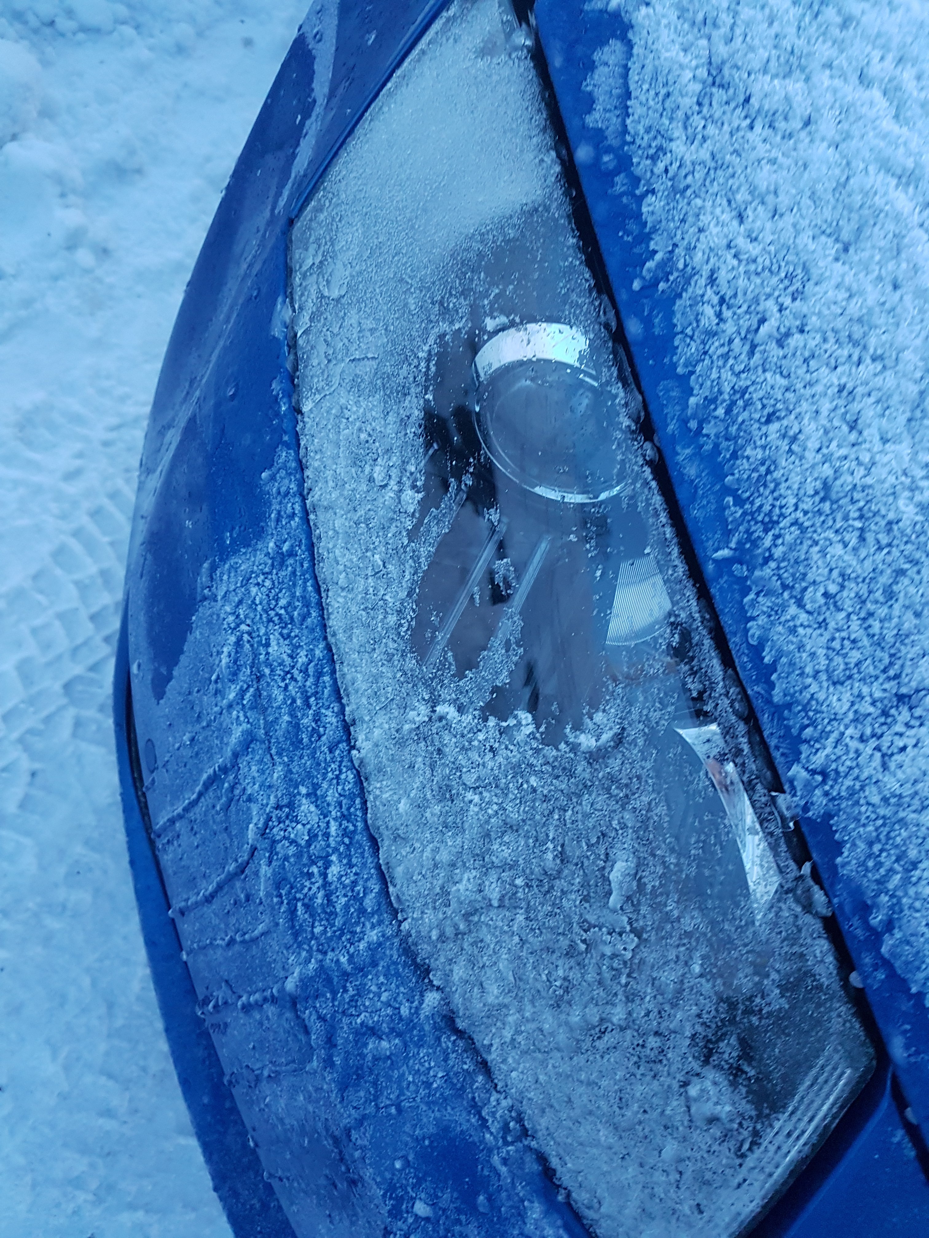

This might not be problem for those of you in the warmer parts of the world, but Im kinda glad i dont have LEDs..
@Gromle, not much of a snow here so asking...
Does the Xenon emits enough heat to defrost as per your picture or this is from the washers?
What about LED...?
