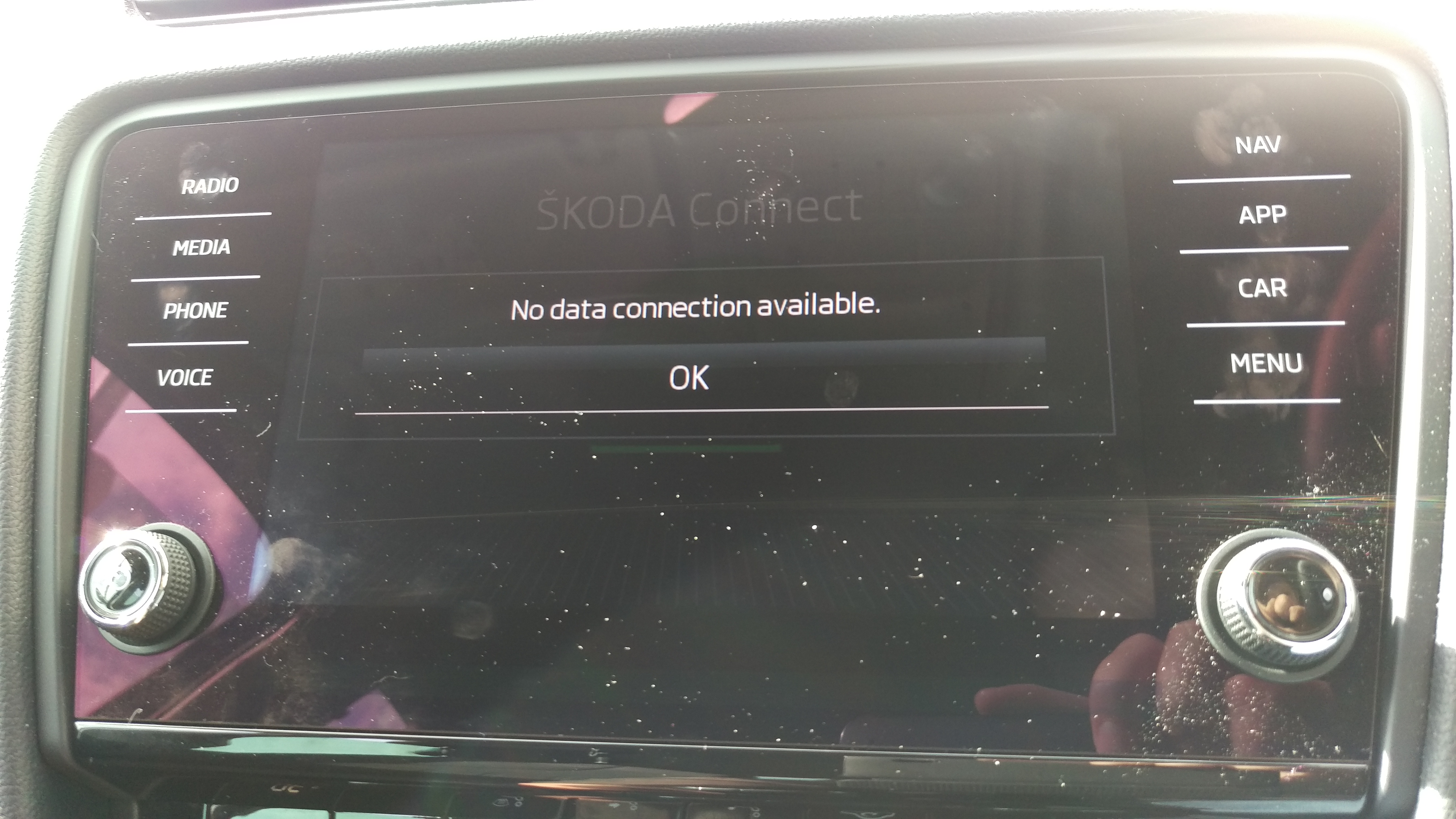

What I see when I go to the menu and press skoda connect after its connection attempt is an error message saying "No Data Connection Available" See the attached images ( sorry for the finger prints and reflections, I did my best!)
I tried resetting the entertainment unit by pressing and holding the power button until the screen went blank.  One time it seemed to work, another time it didn't
Has anyone got suggestions, or should I chase up my dealer and see if they / Skoda UK have any bright ideas?

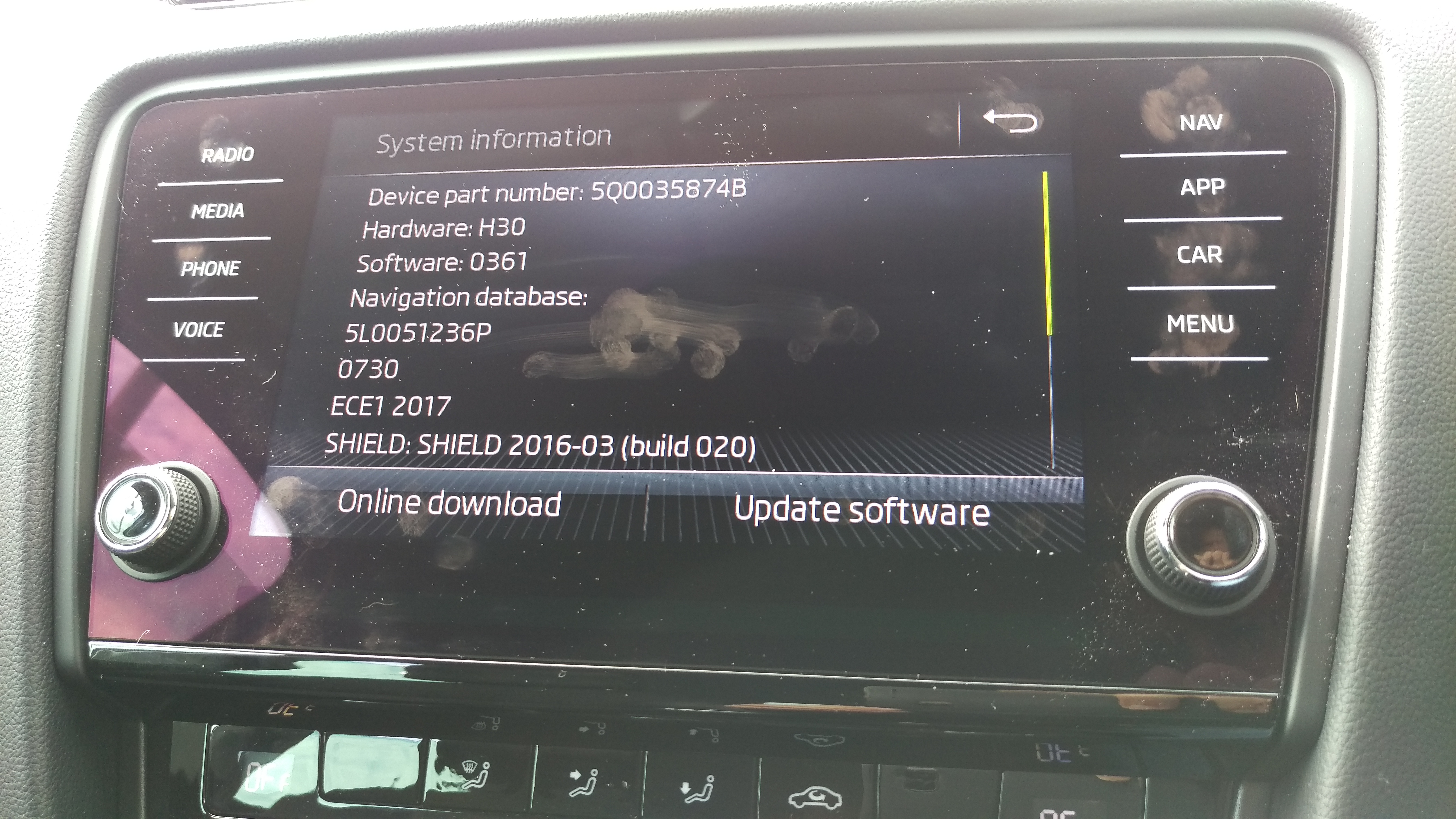

For reference, the System info is as follows
Device Part Number: 5Q0035874B
Hardware: H30
Software: 0361
Navigation database:
5L0051236P
0730
ECE1 2017

On the Amundsen, to see if Connect is working (assuming you already connected the Amundsen to your phone hotspot under Menu-Settings-WLAN), select the Menu button, then the Skoda Connect touchscreen icon.  This the point that I get the "no data connection" message.  If instead all the Skoda Connect icons (like News, Weather, etc) appear, then its working OK.

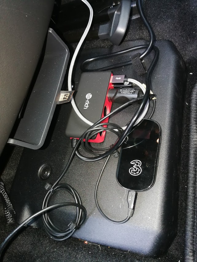

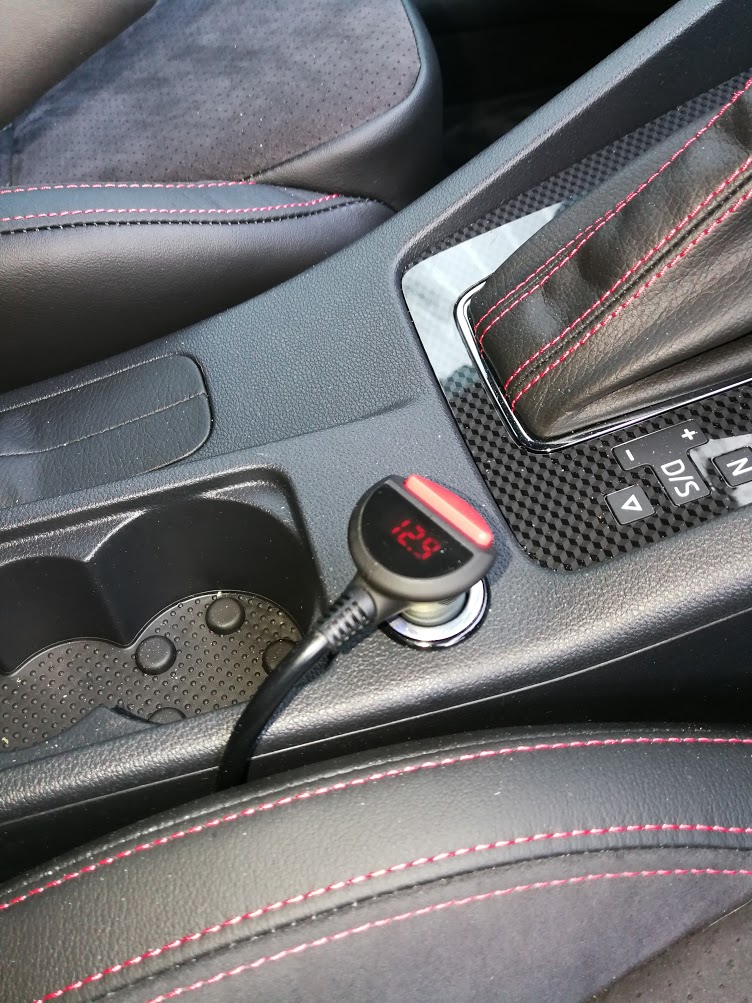

Hi Jannol,
Yes I had mine in the boot at first but decided it would be better under the drivers seat, plugged into an adapter and the cigarette lighter which has a switch and allows me to turn it off when not using the car for a while ( just in case it flattens the battery ) works well for me in both positions good signal etc. you could plug straight into the USB I think although I'm not sure if this is powered with the ignition off. The cigarette adapters are.
2 hours ago, andyvrs230 said:
Hi Jannol,
That does look a good setup. What is it you're using?
Te-Rich 3-Socket Cigarette Lighter 6.8A 4 Port USB Car Charger Power Adapter DC Outlet Splitter for iPhone iPad, Android Samsung, GPS, Dashcam available from Amazon for about £ 12.00 I have got my wifi dongle, dash cam and phone charger lead plugged in. Seat is pulled right back for picture when in driving position none of it can be seen apart from the switched plug in the cigarette lighter socket. ( Depends how long your legs are by the way )
