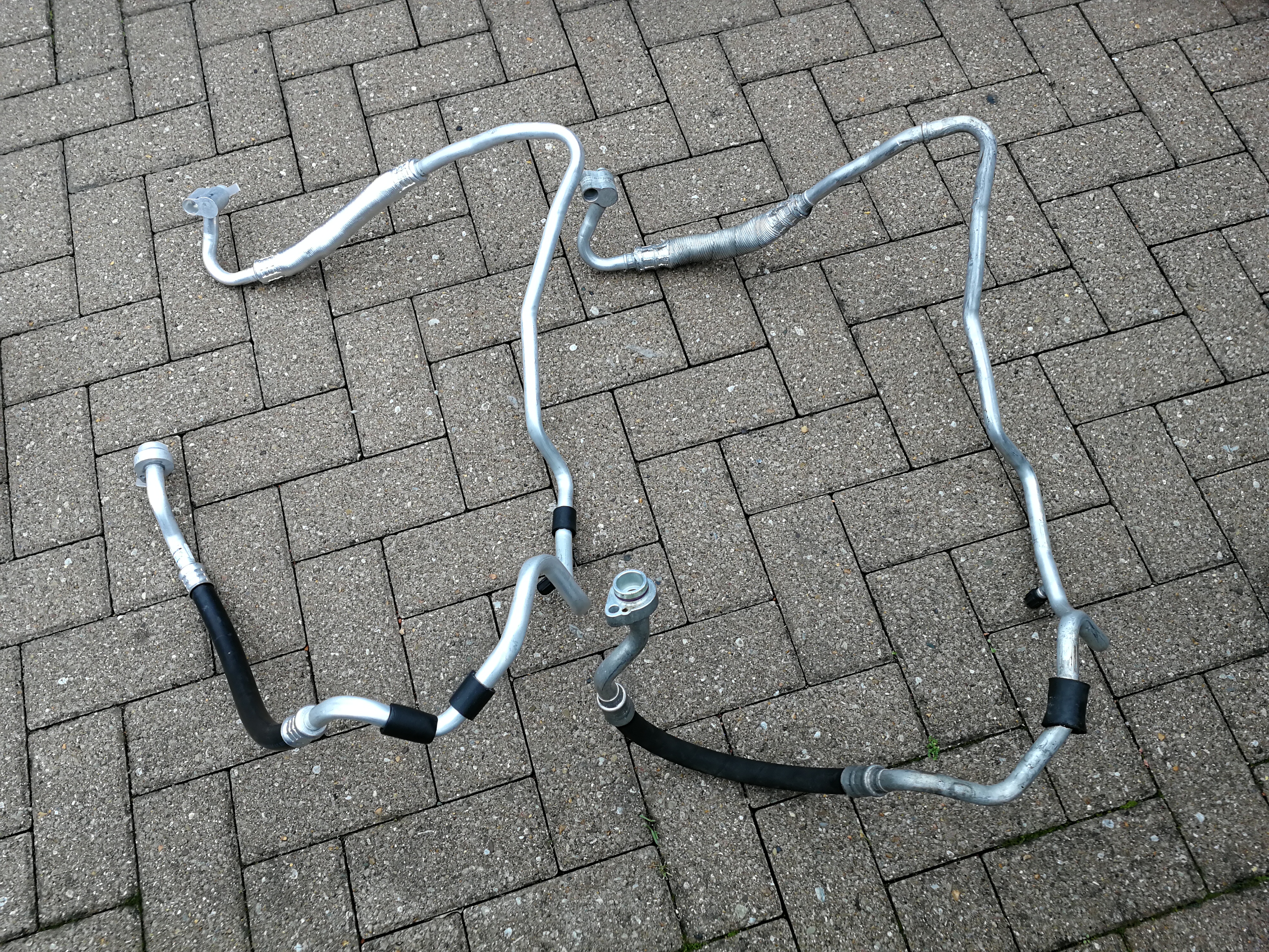

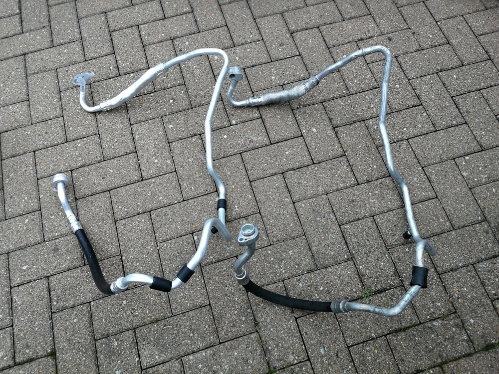

Hi all.  So I thought it was about time I pulled my my finger out and ordered this pipe from the US.  It arrived within a couple of weeks, and to my relief matched the original part very well.  I have since fitted the pipe, had the system pressure tested and re-gassed.   Based on my experience, would recommend getting this part shipped from the US, not only is it equal quality, but it saved me £200.
Image attached displays the new part on the left.
Thanks for everyone's help on this topic.
