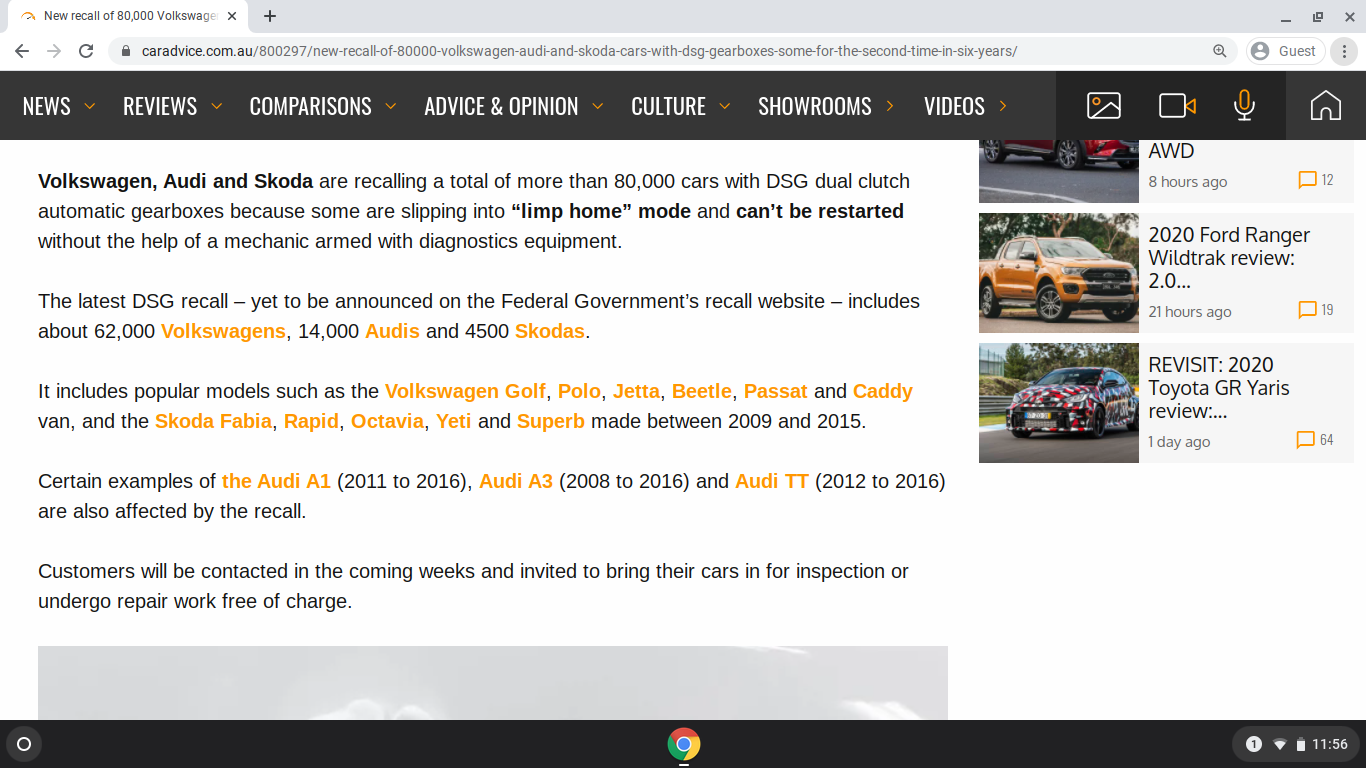

@kimbosabi  The other important thing is you are in Australia.
So have you checked the build date of your car and checked the Recall website to see if your car is part of the latest one on the DQ200 ?,
also best see if there is a software update on the engine.  Contact a main dealer or Skoda Australia.

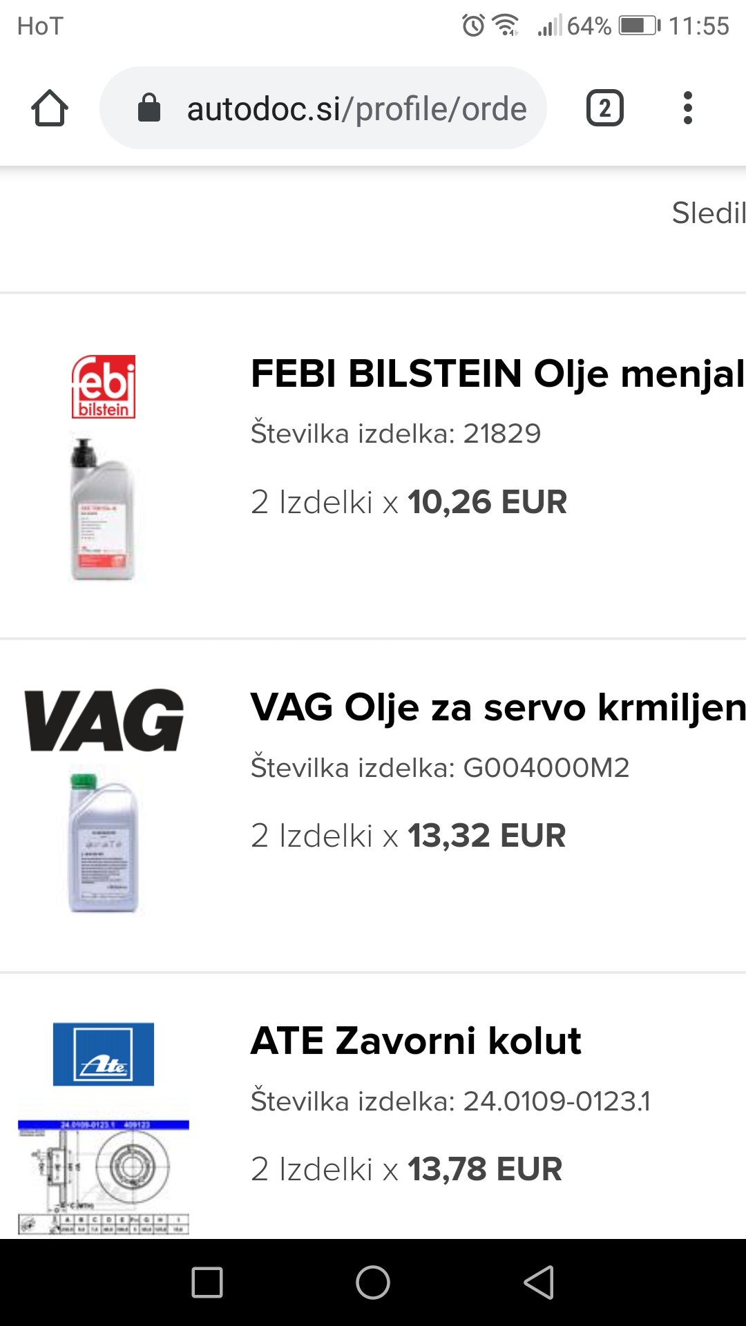

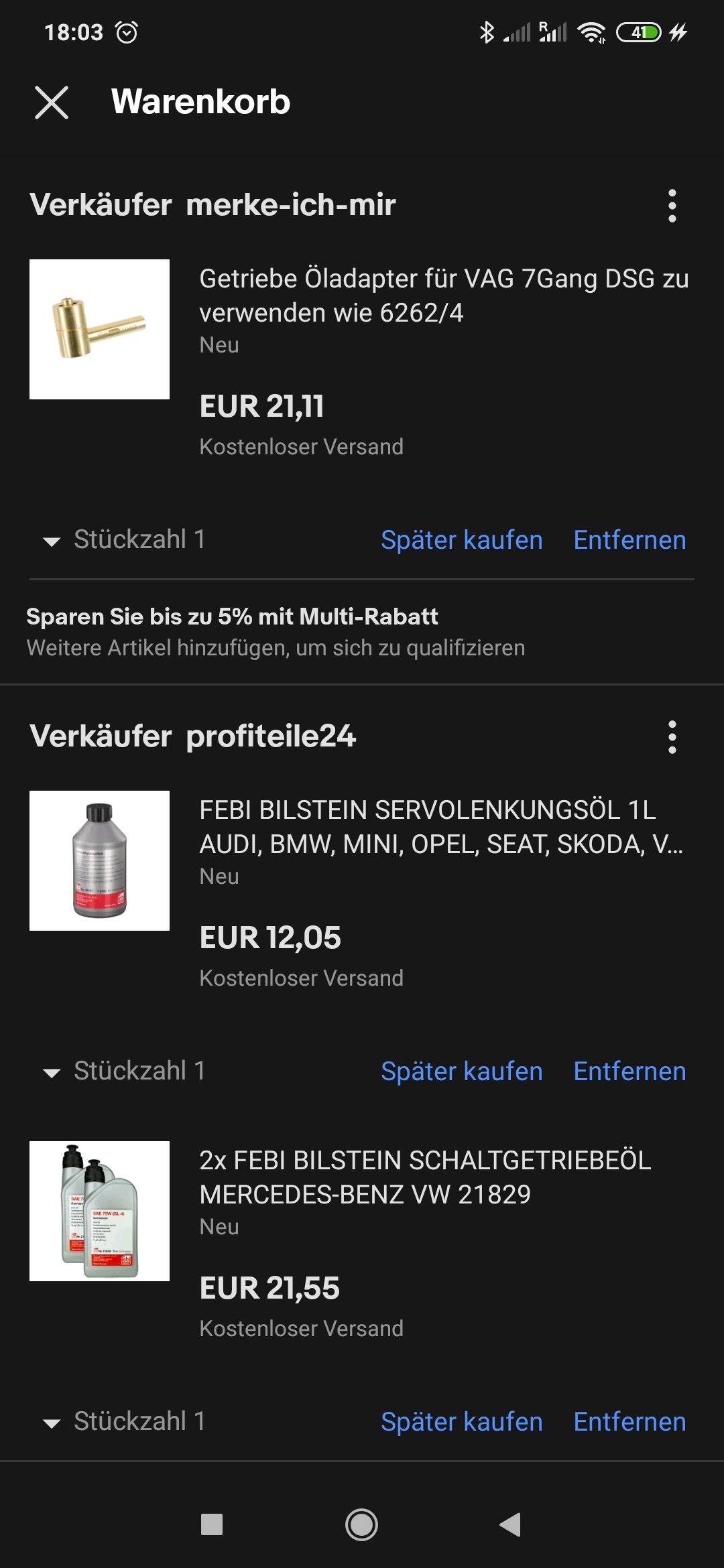

Thanks for your help on the oil change.
I've checked and my car isn't included in the recall. But with 110,000 km on the clock I'm going to change the oil anyway ("filled for life" is a joke on any gearbox!).
Did you use genuine VW oil?
I see the Febi oil matches the requirements and part numbers so was going to use that.
Autodoc...
Ah cool. Thanks.
Found them there. Slightly more expensive here but I prefer the idea of using the genuine VAG hydraulic oil.
P.s. I assume the gearbox needs warming up first before draining?

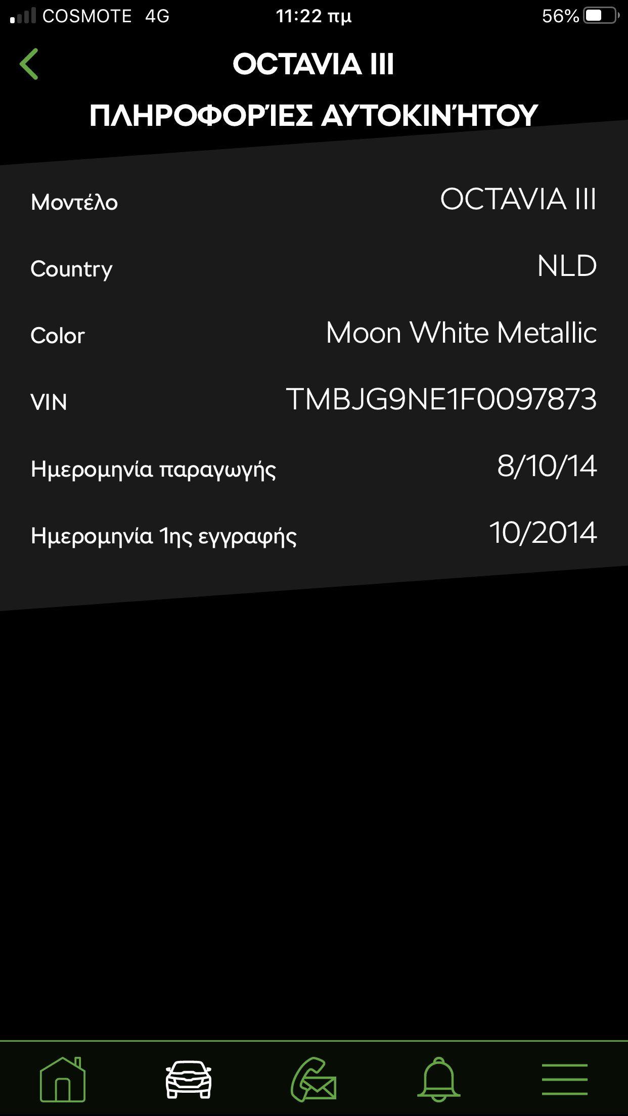

Good evening to all.  I am from Greece and recently 1 month ago I got a Skoda octavia dsg7 1.6tdi with 205,000 kilometers.  when I have 2nd gear at low speeds (1,300-1,700) I feel like it is kicking me.  but only in the 2nd relation.  all other speeds are fine.  and the changes are good they did not hit.  what can this be l?  Does anyone know or something similar has happened to him and he has proceeded to repair and the problem has been solved?  thank you very much in advance!the shazman is dq200 and has not changed oils, nor has it been made by any other kind of winding ...

Your car was part of the World Wide Recall which was a Recall Action in Australia.
Maybe part of the latest Recall in Australia started last year.  Best check with VW Australia if your car should be going in to be checked again.  At no cost to you.
While checking what they are checking they can check out your issue.

Did your car ever have the 'Recall / Service Campaign Action and the synthetic oil changed to mineral and a software update. '34F7' ?
You are going to have to find a mechanic that does know the DQ200 DSG's and what you are going to require doing.
I changed the oil 44,000 kilometers ago but I did not update the software.  if they have it here at all 34F3. I think is better chance me clutch and oil and ask update software.
Sorry i mean 34F7

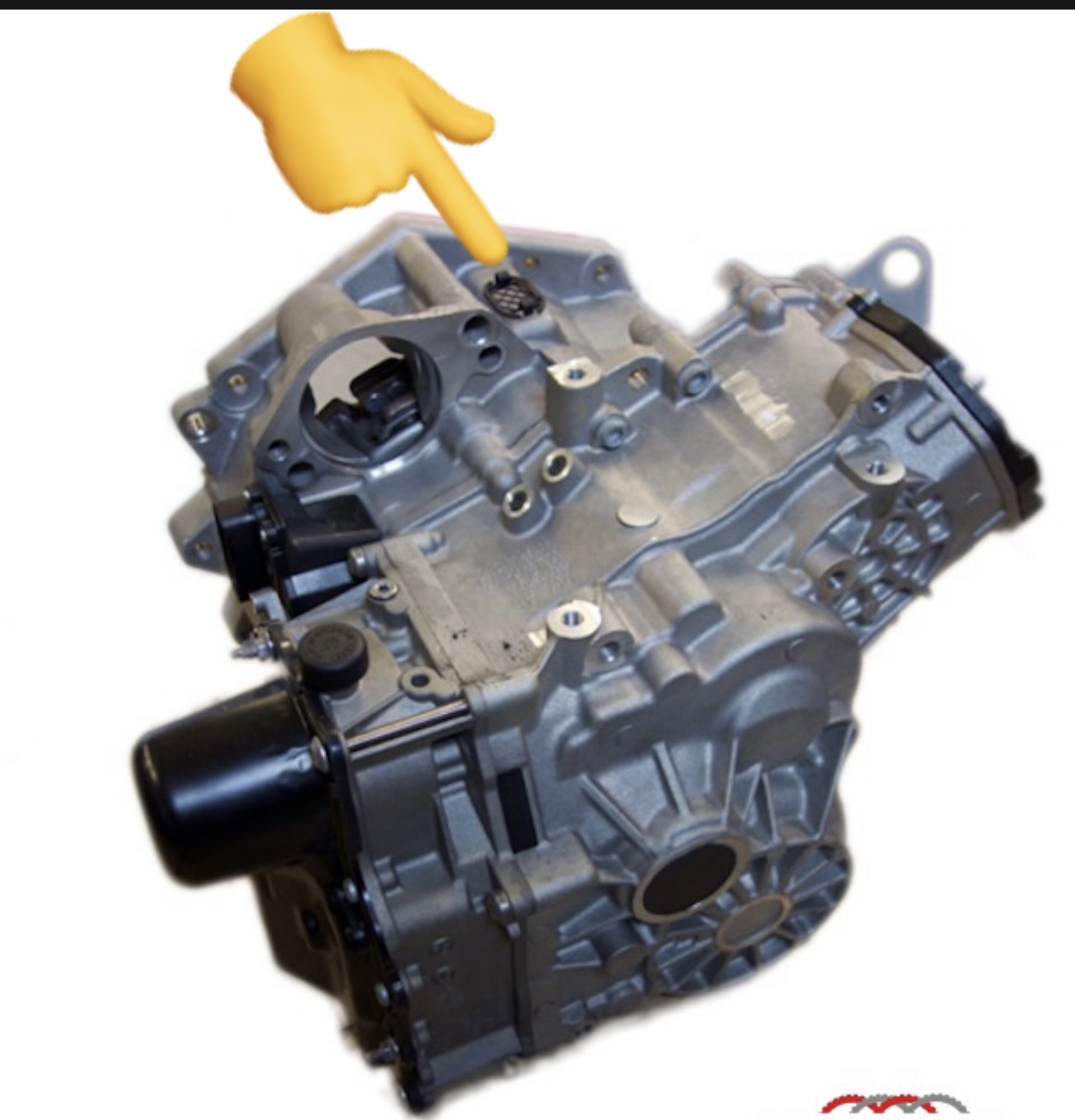

I just want to add a thing about the DQ200 transmissions.
the 1.4TSI engine waterpump are known to leak coolant
my car started at 217.000km
the waterpomp on these engines is on the right side and not like other cars which have it with the timing belt.
If your car starts to leak coolant you would see it on the dsg transmission and there is a small hole on the top of the dsg for inspection or ventilation i guess .
the coolant can leak from that hole into the clutches and fly wheel which can cause a cluch slip.
and if you are replacing your waterpump make sure to cover that hole because when you remove the waterpump alot of coolant is gonna leak inside.
