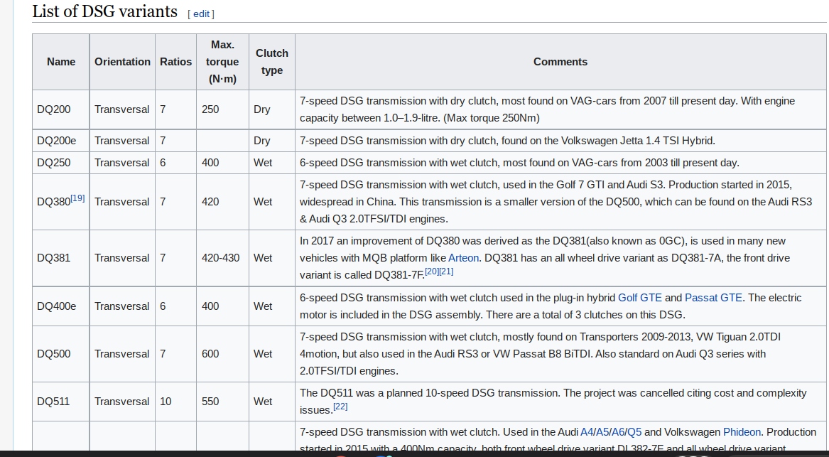

The Mild Hybrids do have the e-DQ200 or DQ200-E.

It’s strange many say that the mild hybrids have the DQ200E but this press release claims it is a normal DQ200, of course press releases can be wrong.
https://www.volkswagen-newsroom.com/en/the-new-golf-international-vehicle-presentation-5609/new-drive-systems-5622
1.5 eTSI with 110 kW and DSG. The 1.5 eTSI with 150 PS can also be combined with a 7-speed DSG (DQ200) as standard. It has the same output figures (110 kW between 5,000 and 6,000 rpm) as a TSI with the same power but without 48 V technology and DSG. The also identical maximum torque of 250 Nm is available within a range from 1,500 to 3,500 rpm. The Golf 1.5 eTSI accelerates from 0 to 100 km/h in 8.5 seconds and has a top speed of 224 km/h.

In North America & Australia VW Jetta & Skoda Karoq got the 1.4TSI with 8 speed TQ Auto's.  so no idea what these Jetta are that got e-DQ200's.
Maybe they never did, but VW Group did speak of DQ200-e's.
*Maybe someone had too many e.s.
My error,
It was the DQ400e in the from 2016 GTE's & the Audi, Plug in Hybrids

I can't see why they can't just use a plain vanilla DQ200 with a mild hybrid engine. All the mild hybridness is contained in the engine in the guise of the belt driven oversized alternator / weedy electric motor.  Add a bit of a lithium battery (0.7kwh iirc) and some electric power management and all you have is yet another ice engine. Just stick a standard DQ200 on, maybe tweak the dsg software regarding coasting etc.
Hybrids like the GTE or iv are completely different architecture
