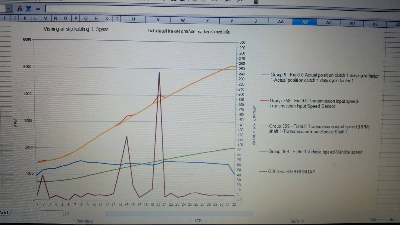

In Denmark we are a big group of people and we are also having trouble with slipping clutch in the dsg7 dq200 gearbox.
I have made a log with vcds.... this is made in 3 gear manual from 1500rpm full throttle..... tried to do the same test and see what happens
Can you add the engine torque, MAP G31 sensor before throttle body and MAP G71 sensor on the intake manifold values also to one graph? Maybe also G28 engine rpm sensor?
