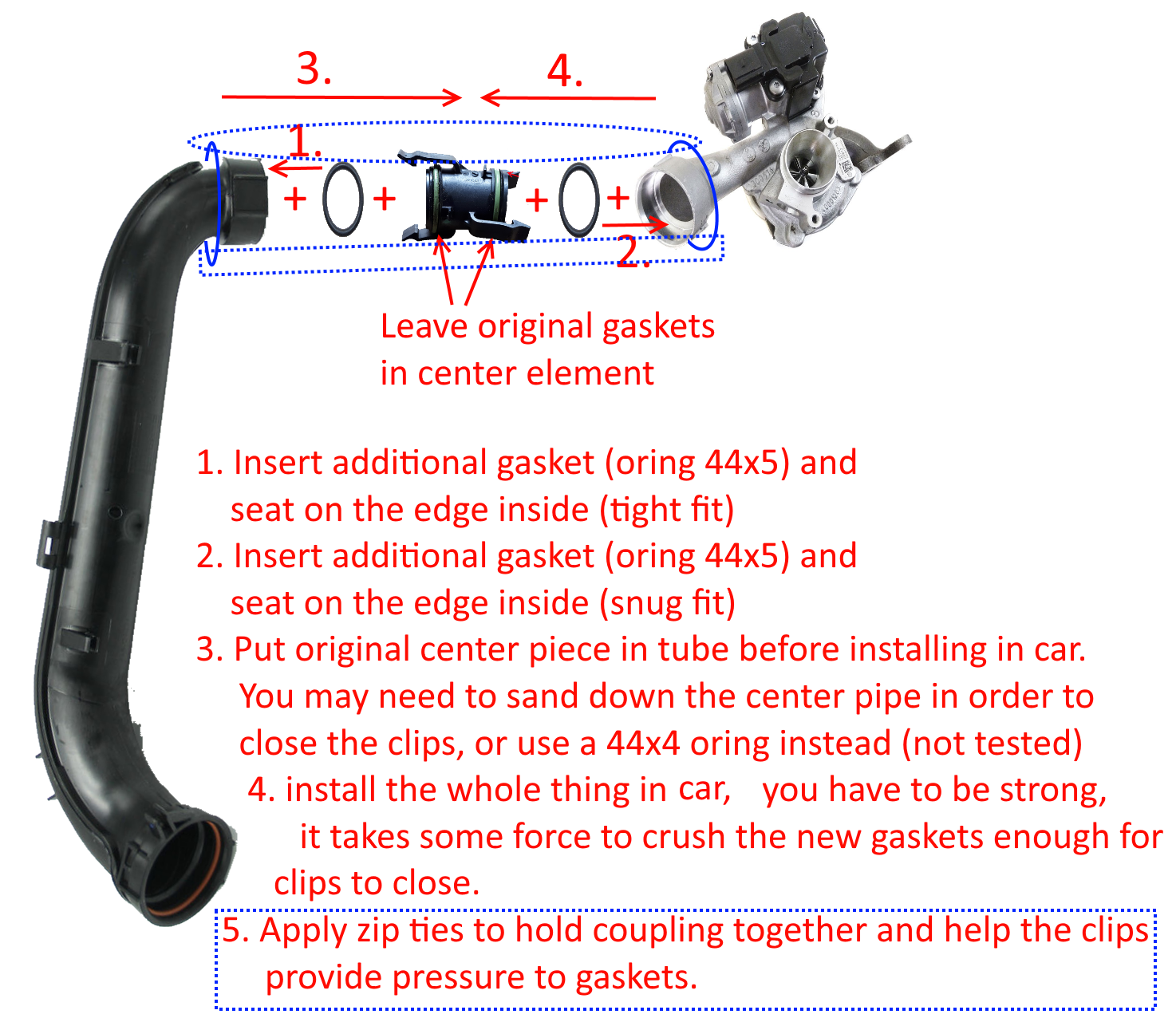

Ok, due to multiple variations of the proposed fix I have tested, this has been the most successful, and cost effective and trace-less from outside (excluding zip ties), and also no sealant is needed.
The first test with this setup has reduced the slips by 90%, but I still get some. I will see how it will go in next week or so.
Have you leak/pressure test the connection and actually see that there are leaks there? And testing again after you have added more gasket and see that there is any difference?
Please read again the first post, yes I did a leak test...

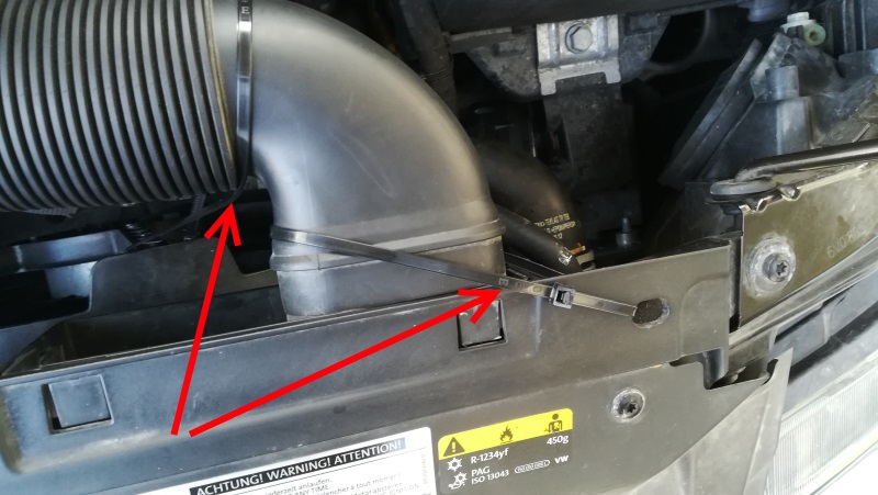

It turns out, that the boost leak is not the only coulprit here, and has been discovered actualy by acident when I think about it now. But as my evidence on the boost pressure hose being rubbed and a slight channel has been formed in the place where the gasket seals the coupling, it would only get worse over time, so this needed to be addressed with extra gaskets and zip-ties. See a few posts before, where a drawing shows my solution.
After this modification has been made, as I said there has been a 90% improvement of the problem, but that remaining 10% was still noticable, so I dug deeper into resolution...

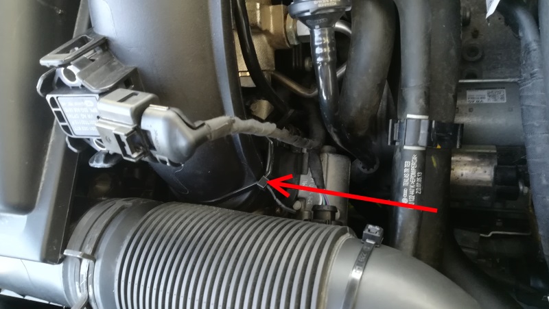

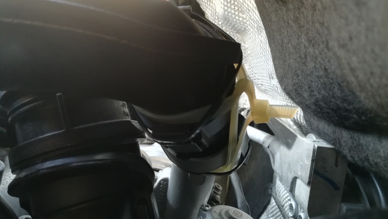

Do you remember the intake tube from the front mask to the air box... Well it was still making noise, because I have used only folded paper to fix it, obviously it was not enough.
So yet again I have taken the trusty zip-ties and also put them instead of the paper fix. And viola... no more buzzing sound and no more slip from gearbox.
What then does sound have to do with clutch slip you might ask? I do not know, but it does a hell lot with the knock sensor... If I can here the buzzing sound in the drivers seat, the engine knock sensor obviously can also.
Where do I see a problem? Well I gues when the resonating sound is in sync with the vibrations of the engine piston ignition and the knock sensor is to sensitive and mistakenly thinks that there is knock present, then the ECU alters the ignition phase and also injection quantity and so on..., which in result equals surging of the engine,... I think you know where this is going...
So if anybodi is interested, how they can try this cheap DIY solution with almost no cost, a few zip ties is enough...
The extra gaskets are not a must for a simple test. If the issue is resolved at least by 50% by just using zip-ties, you are on the right track I gues...

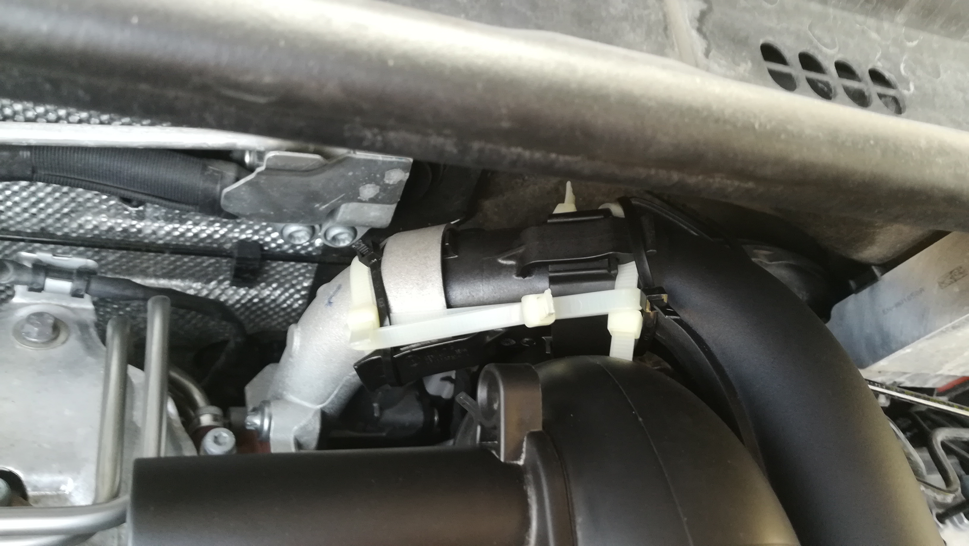

The zip-ties must be fasten quite hard to eliminate the chatter. See pictures below... The white ones are much stronger...
I will however revise some of fastening points to be more stealth, but at least for two weeks I will leave it as is, since I have enough tinkering with the car at the moment.

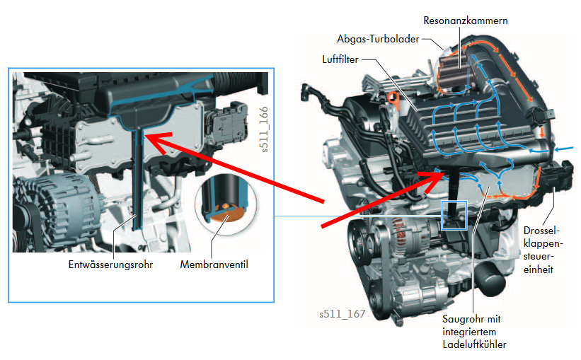

Please also notice that I recommend, that you also zip-tie the folowing item also (just in case, a nother item that is designed quite flimsy):
Ok, as I said, for me, case is closed,
For every body else that has this problem and will do this simple fix and is kind enough to at least say hi and results he has achieved, it would be very helpfull for othere people also. Do not be greedy...!
For VW group engineers, please make a research regarding this and alter your software to make the knock sensor a little less sensitive to other chatter sounds...
Have a nice day.

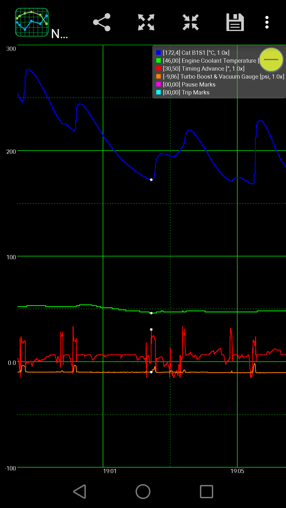

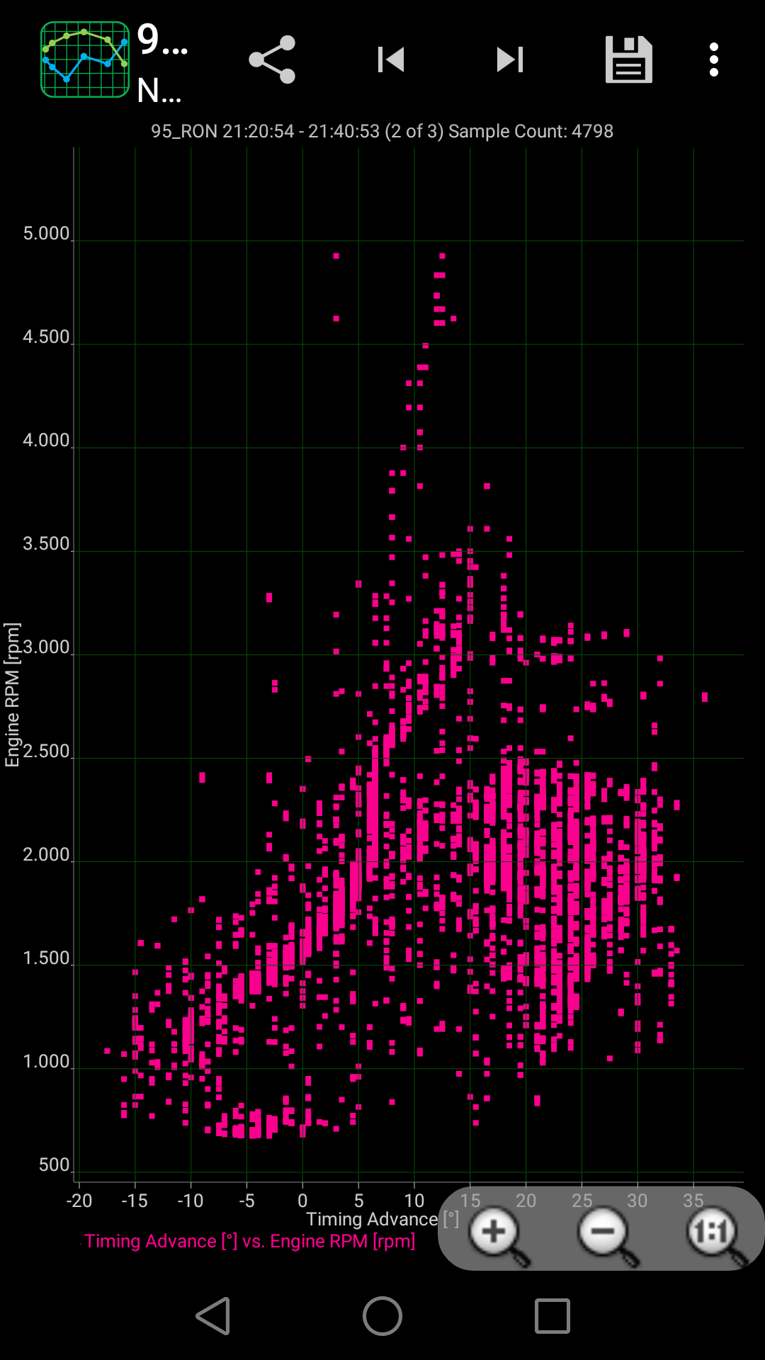

I was wondering if you ever made any logs via OBD of the timing advance. If you would log the events, it would clearly show up as a retard during the whole faulty/slip sequence. And which would even further prove your theory, which I am inclined to agree with, because some knock sensors can be over sensitive (or actually the software controlling/listening to it), and looks like these TSI's might not be an exception.
I am still waiting for the postman to bring it to me :D It is taking forever for the packet to arrive (obd tool). I also want prove this with a graph.
The only problem is that the knock sensor is a b**** to replace... the intake manifold has to come off, if it is faulty.
I want a graph before I go buy a knock sensor and waste my time replacing it.
Thats cool, you can do quite a lot with it. I have it for about 1 month, and it is a great tool. Should help you for sure. But be vary. You might not see all the sensors that are actually in your car. For example I cant see the MAF sensor and oil temp sensor, even tho I know they are in the car (obiously). But I can see it on other cars, so the problem is perhaps not the obd tool. Looks like the ECU doesnt want to show everything to these basic devices. Tho it would show on VCDS. But ofc the price difference is huge.
Some of my examples.
