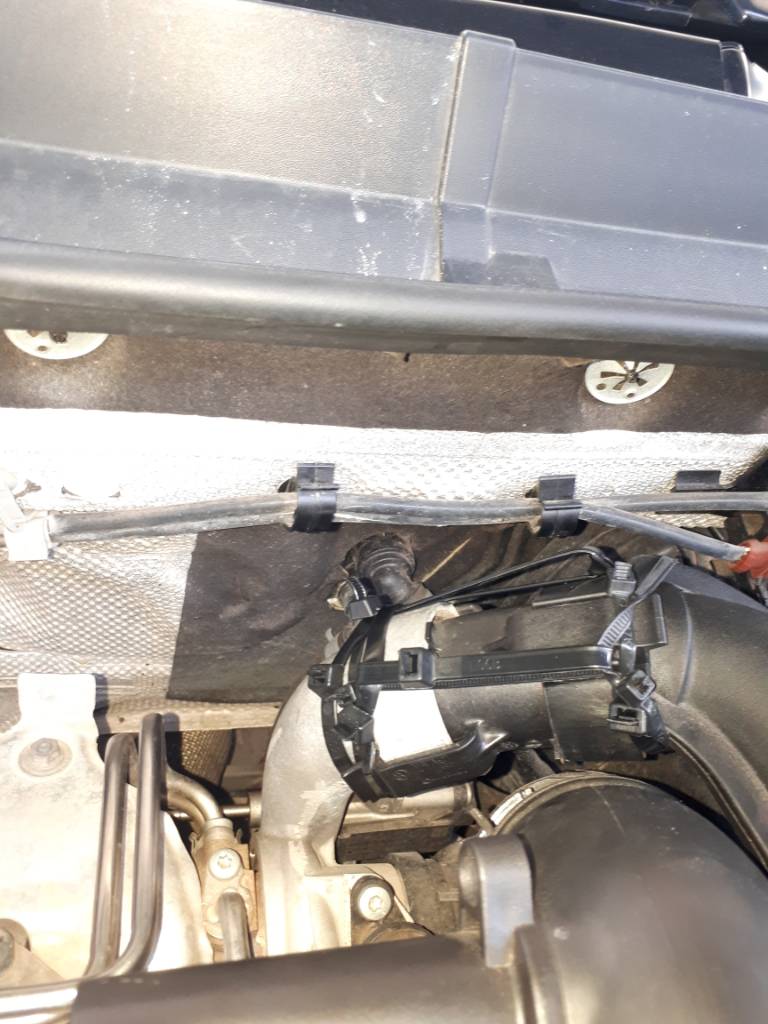

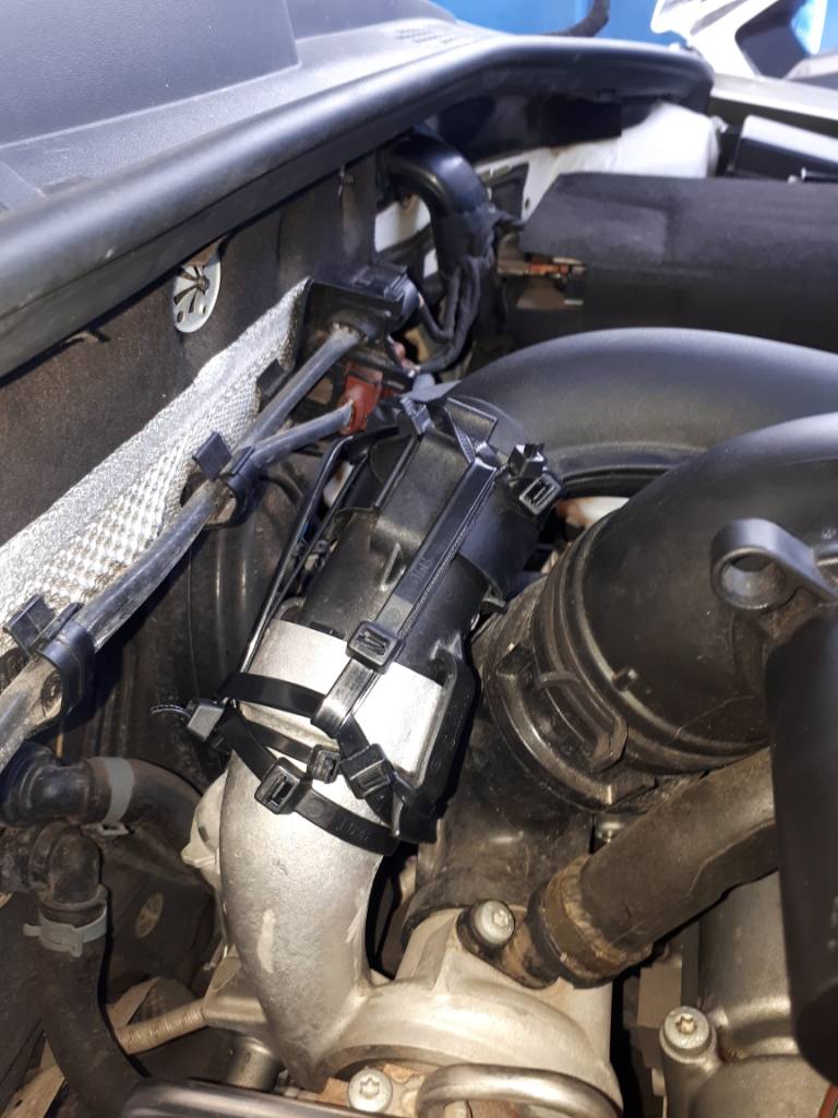

  • Hi again...   Another note... At the lower picture, please notice the small plastic spacers that are molded into the adapter hose. Mine were rubbed off to quite an extent due to vibration of

At this moment my car is completely stock, no zip ties no extra gaskets, since I went ahead and again tried the dealer approach, but this time another one.

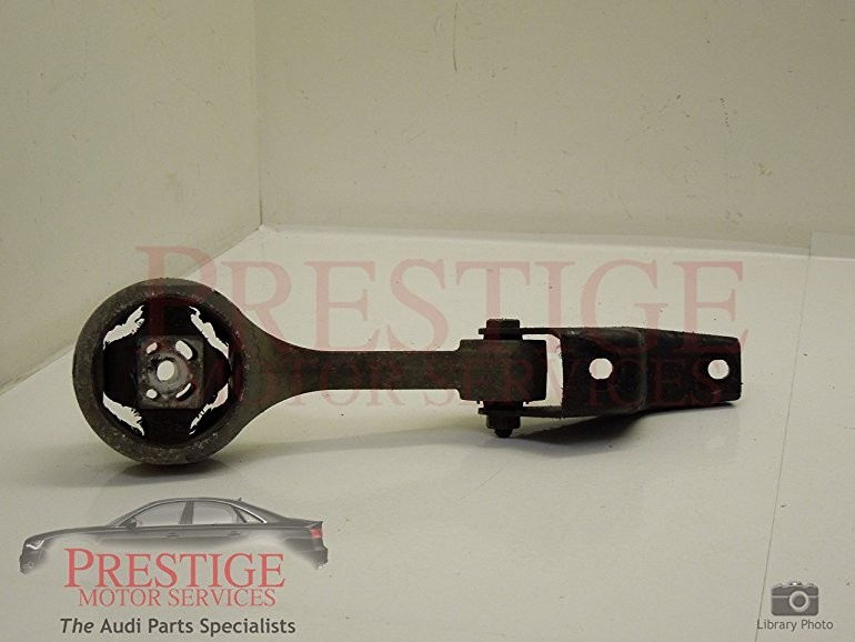

The main difference between forward and back is in the dogbone engine mount on the bottom. It has more rubber on back side than on front... the below picture is a worn one but the difference is more clear.
33 dakika önce, krigl dedi ki:
İleri ve geri arasındaki temel fark alttaki köpek kemiği motoru desteğidir. Arka tarafta ön taraftakinden daha fazla kauçuk var ... aşağıdaki resim aşınmış bir model ama fark daha net.
