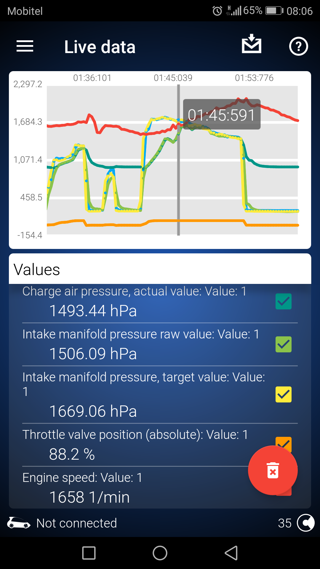

I observed the pressures via the OBD11 and the pressure builds up to 60bar, then it slowly goes down to 40 bar and then the cycle repeats itself. this is no mater if it is changing gear or not, but in meantime, the clutch plate pressure varies upon the load of the engine during the same gear drive. All this seams normal to me unfortunately.

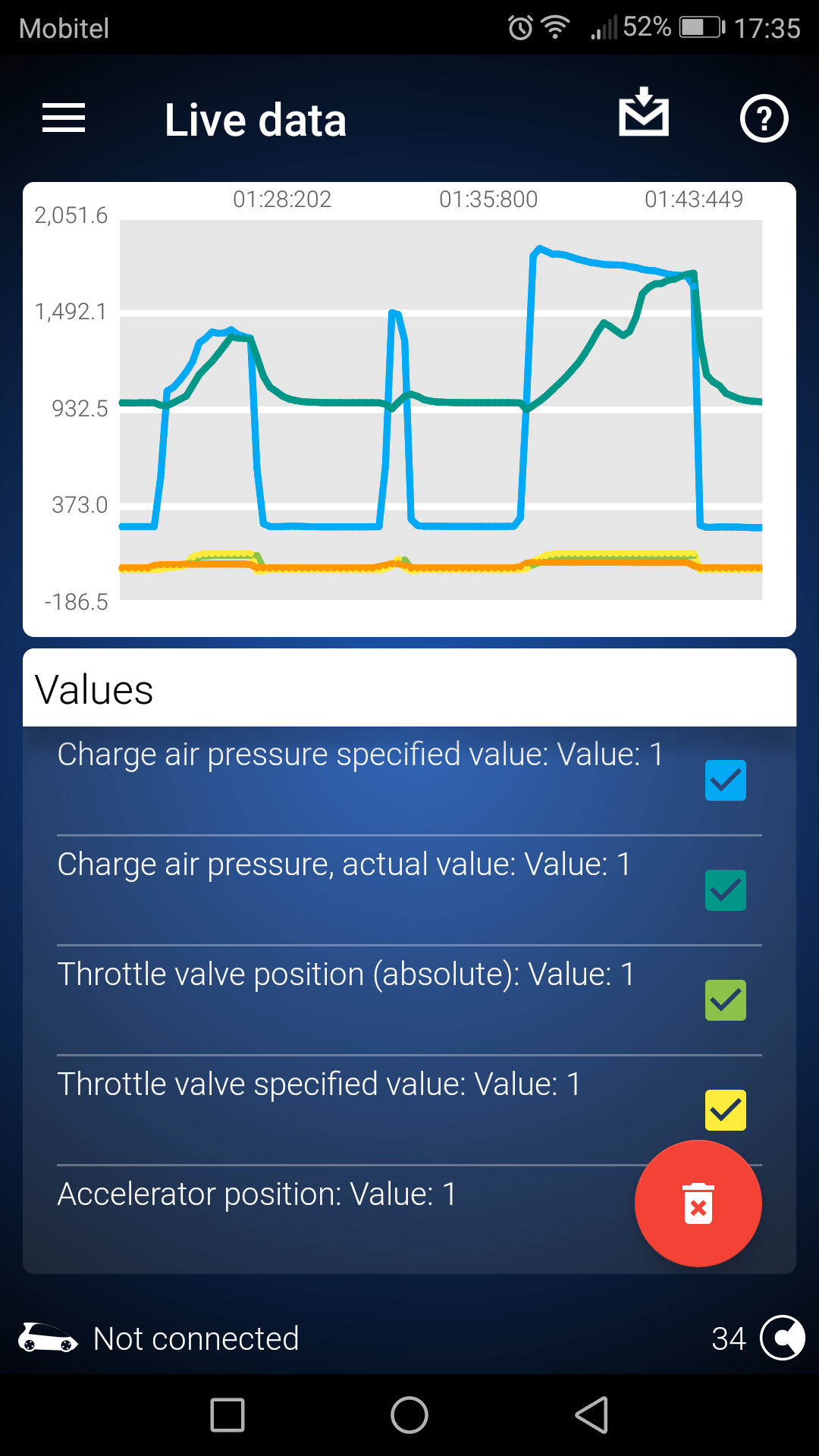

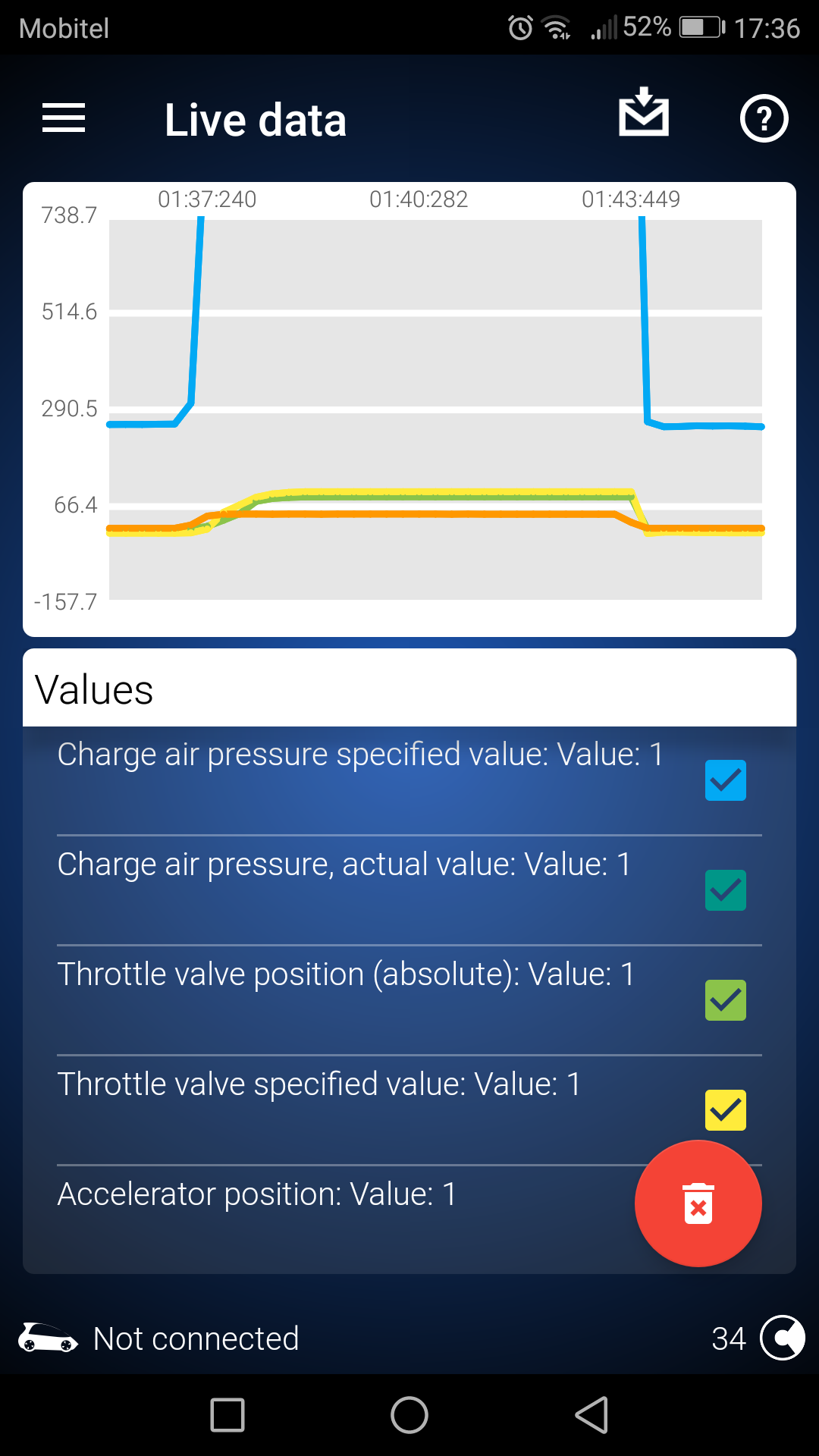

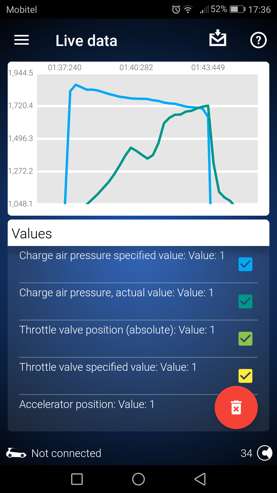

This attached photos that i did today with the obd11 live logging seem quite strange, what the actual boost does in the region when it drops, that is the point of a slip feelt.
I have to put my original mods back on and try again to see if it is any better.
There i trown a bone for further chewing and discussion...

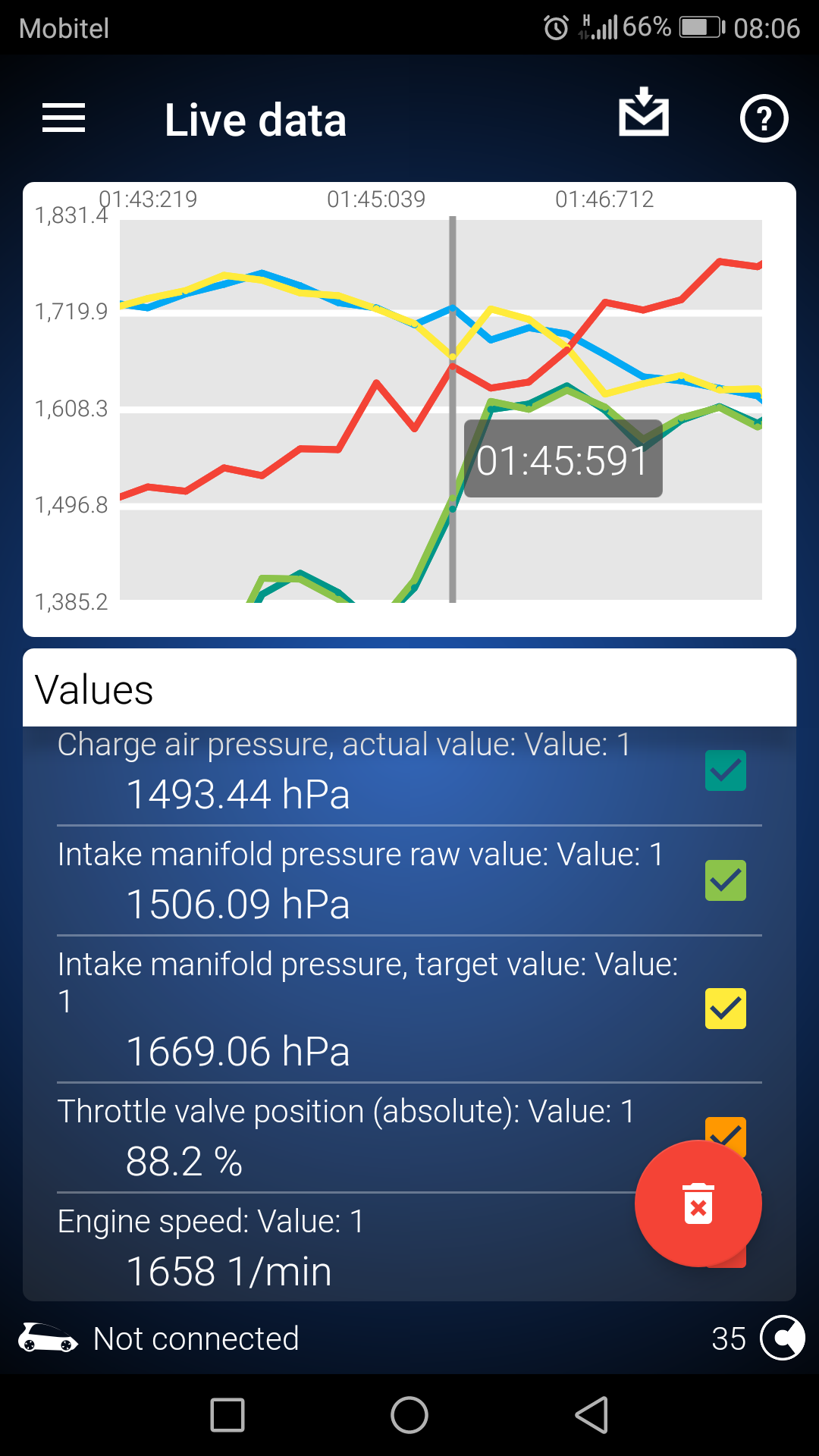

Problem is, that I am strugling with my graphs of boost, why it behaves this way, this is from this morning... I se a pressure drop on requested on the intake manifold and am wondering what causes this...
The throttle valve is open constantly during this time.
