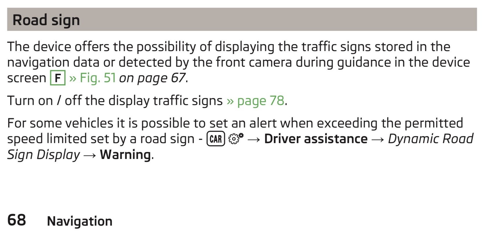

On 12/10/2017 at 03:27, BillyJim said:
With TSR enabled you can set an alert if you exceed the detected speed limit by a preset value in the range of 0-9 mph or 0-15 km/h.
How do you enable /set up that?
On 10/07/2018 at 00:49, BillyJim said:
Thank you!!
