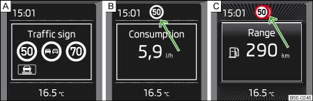

Yes!
A and B are the mono MFD, C is the colour version.
When active, Traffic Sign Recognition (TSR) will display up to three road signs at the top of the MFD - B and C.
If two or more restriction signs are active they will overlap and only the first significant sign is clearly visible - C.
Traffic Sign is an option that can be enabled/disabled in the infotainment and, if enabled, can be selected in the MFD's scrolling "Driving Data" menu to clearly display all signs - A.
Road signs that TSR recognises and displays are speed limits and 'no overtaking'. I have yet to see it display any other type of restriction sign. It can recognise conditional limits, such as when wet or during specific times.
The 'when wet' is common in France and Germany.
The time-specific limit can be found on some stretches of motorways in The Netherlands. It won't display the actual time but rather a small clock symbol below the limit sign.
TSR signs can optionally be displayed on the infotainment's navigation map screen.
The road signs overlap on the map screen like they do at the top of the MFD but you can tap on them and they will slide apart for about 20-30 seconds, as shown below.
