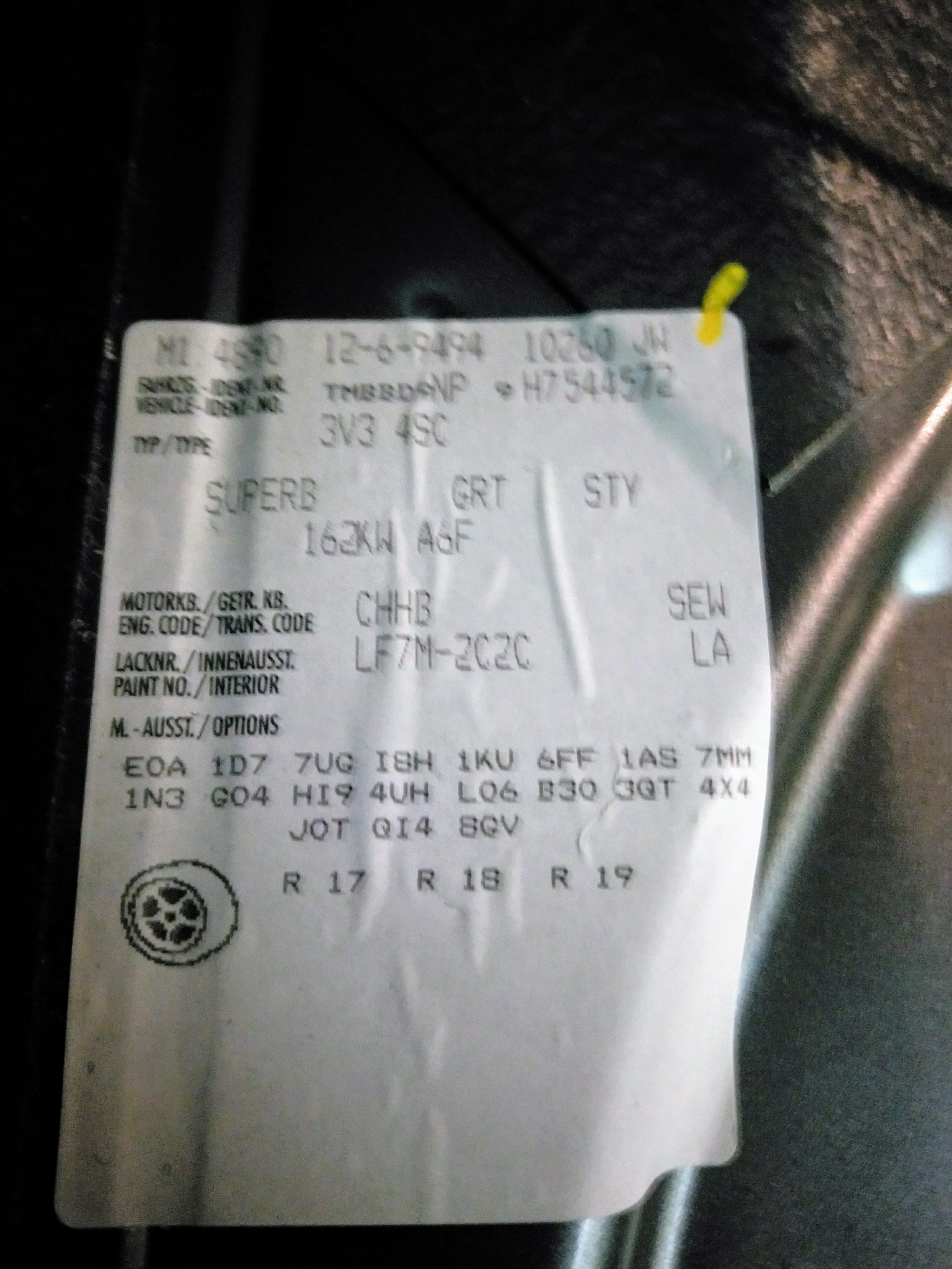

If you are unsure to the actual power, the sticker that goes u see the boot floor would have the engine power in kw.
Other than that the audi pedal mod stated above would help with the hesitation of the throttle
@roo can you please detail where to find the sticker ?
How is the mode set?  Sport or Eco?
Not looked on mine but I would expect the sticker to be on the metal under the boot floor.   Sometimes repeated in the front of the service book.
In the boot floor....

If you have the AdBlue tank next to the fuel tank, you have a 190.
MY2018 150's with DSG or 4x4 now have AdBlue.
Ah, I didn't realise this. I wonder what the reason was that Skoda felt they had to put AdBlue on the 150BHP engine.
