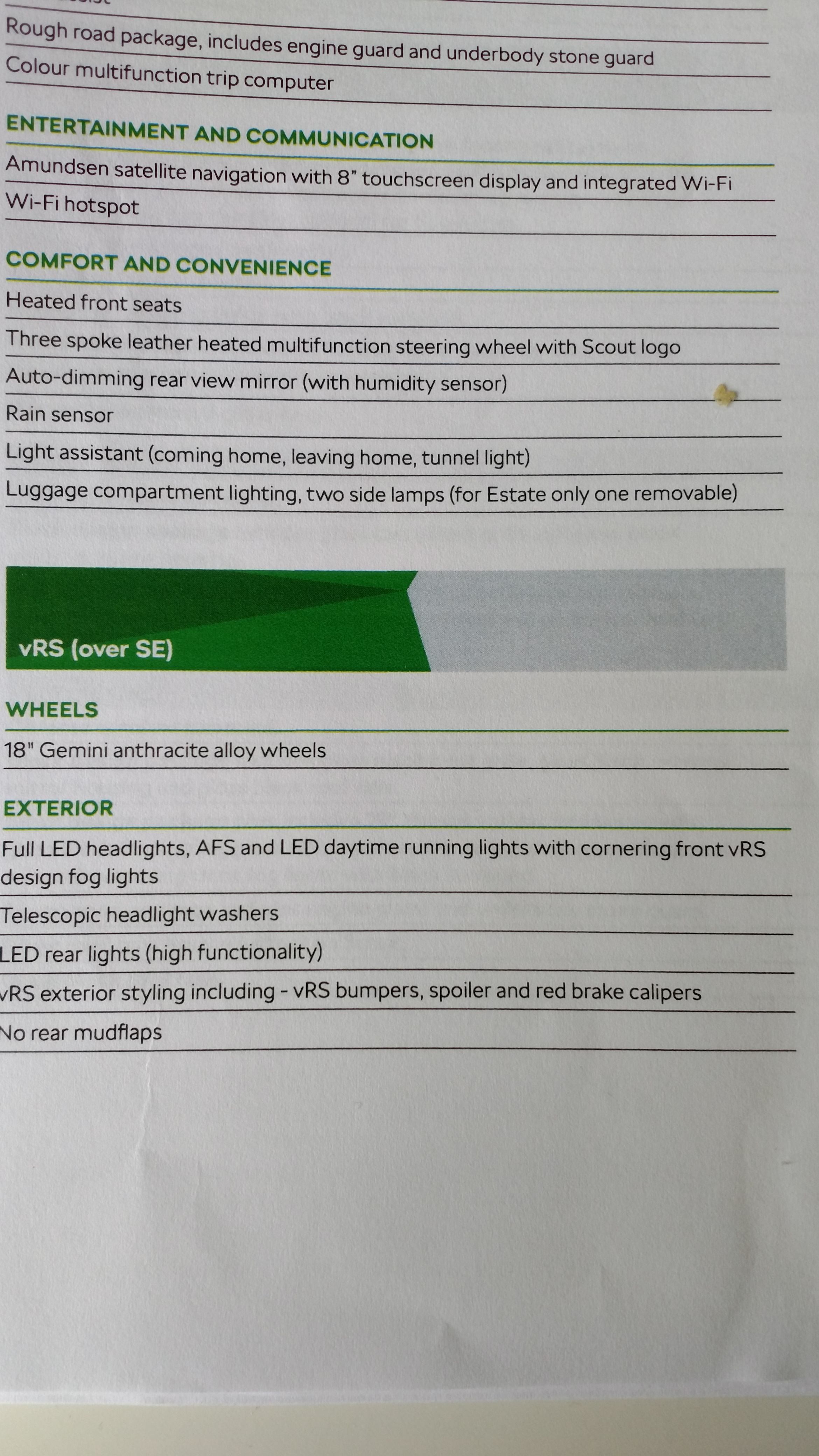

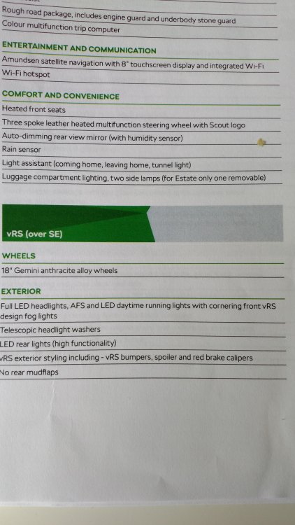

Here's the brochure I was given at time of ordering. It confirms cornering lights are standard on both vRS'.

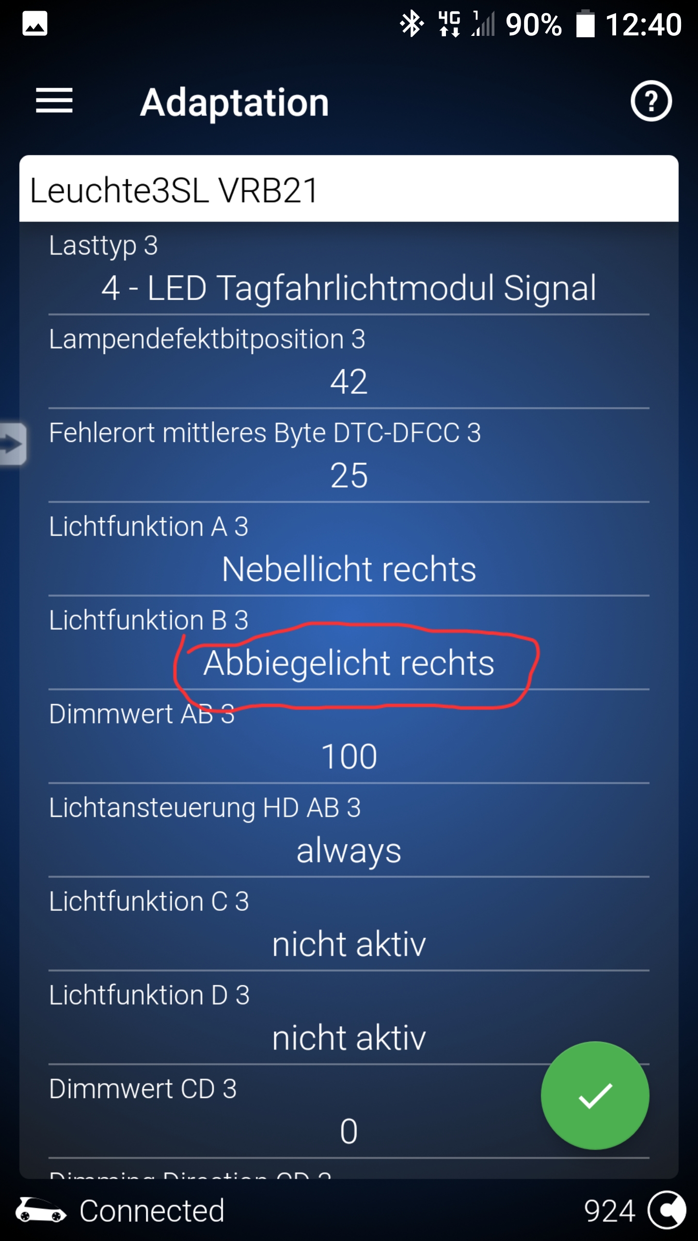

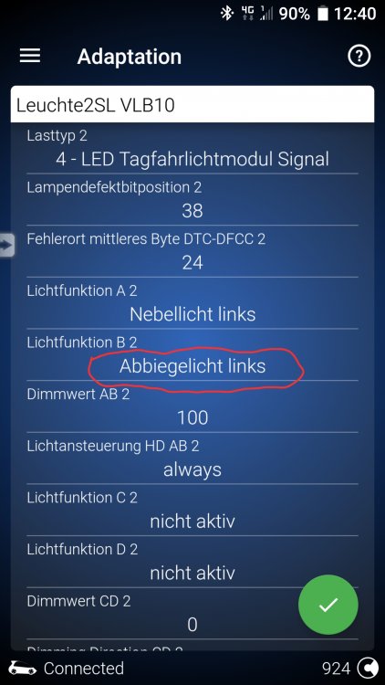

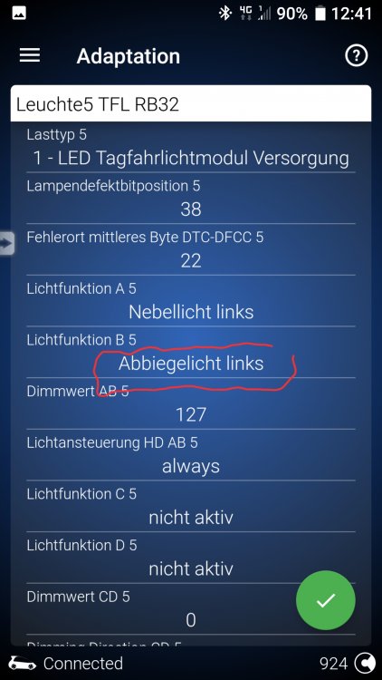

Try this
Worked on my FL VRS.
Hi
Thanks for this, I assume that this is the OBeleven Pro system you are using to do this?
Yes, obdeleven pro.
