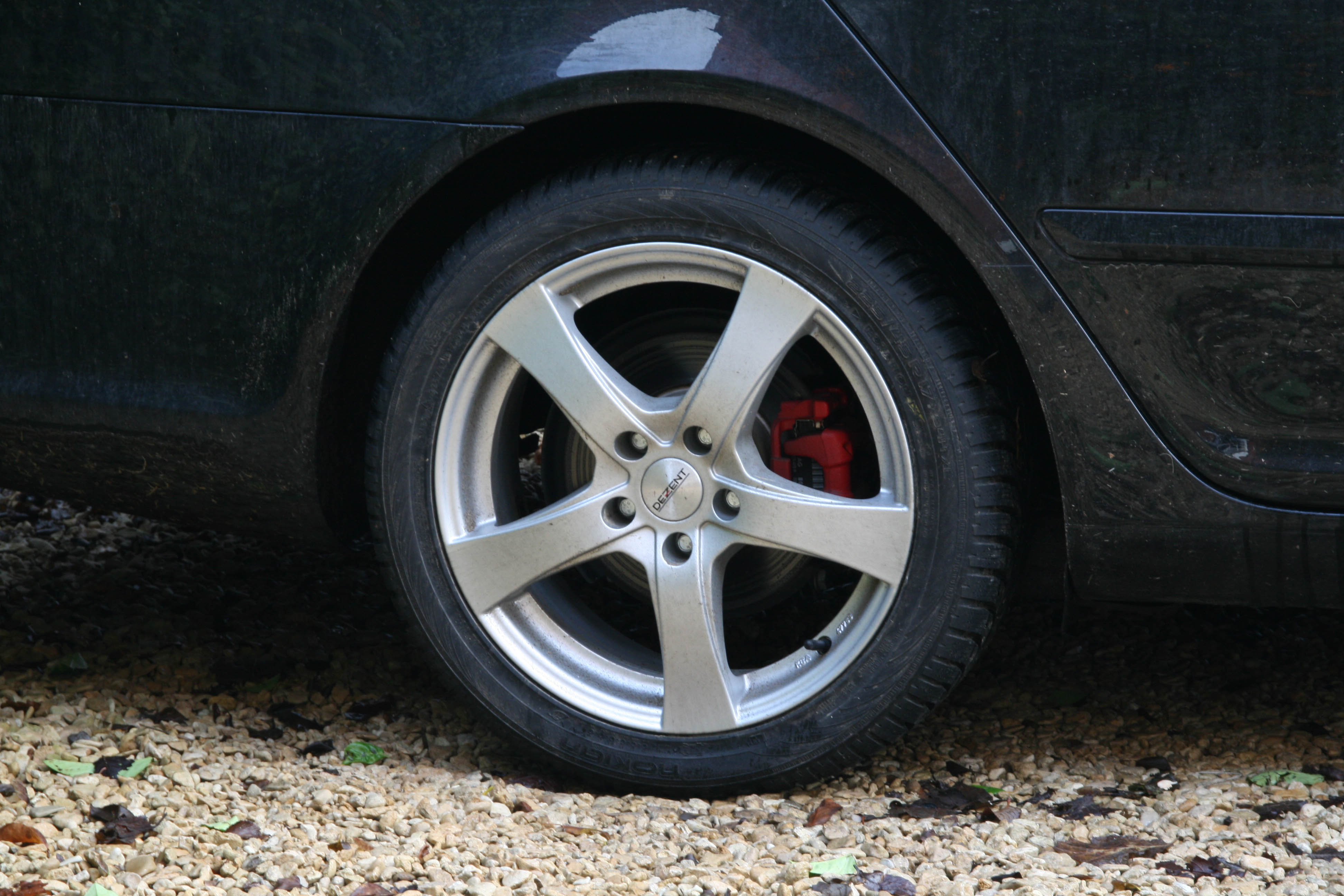

I do think that original look the best! But - my winter tyres came on these wheels. Some think they look good but I think they look just awful!

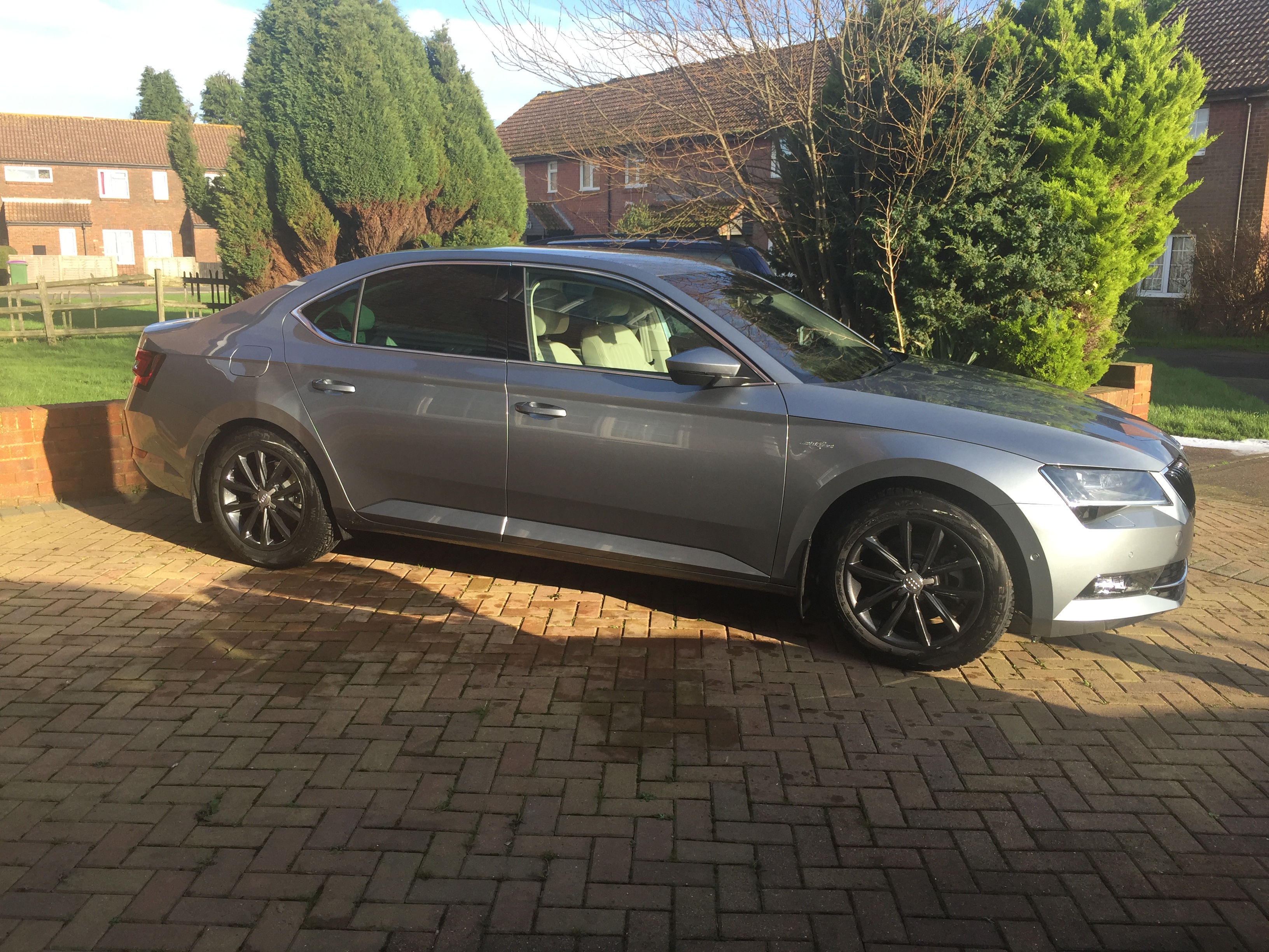

17" but unsure of width - matches specifications anyway.

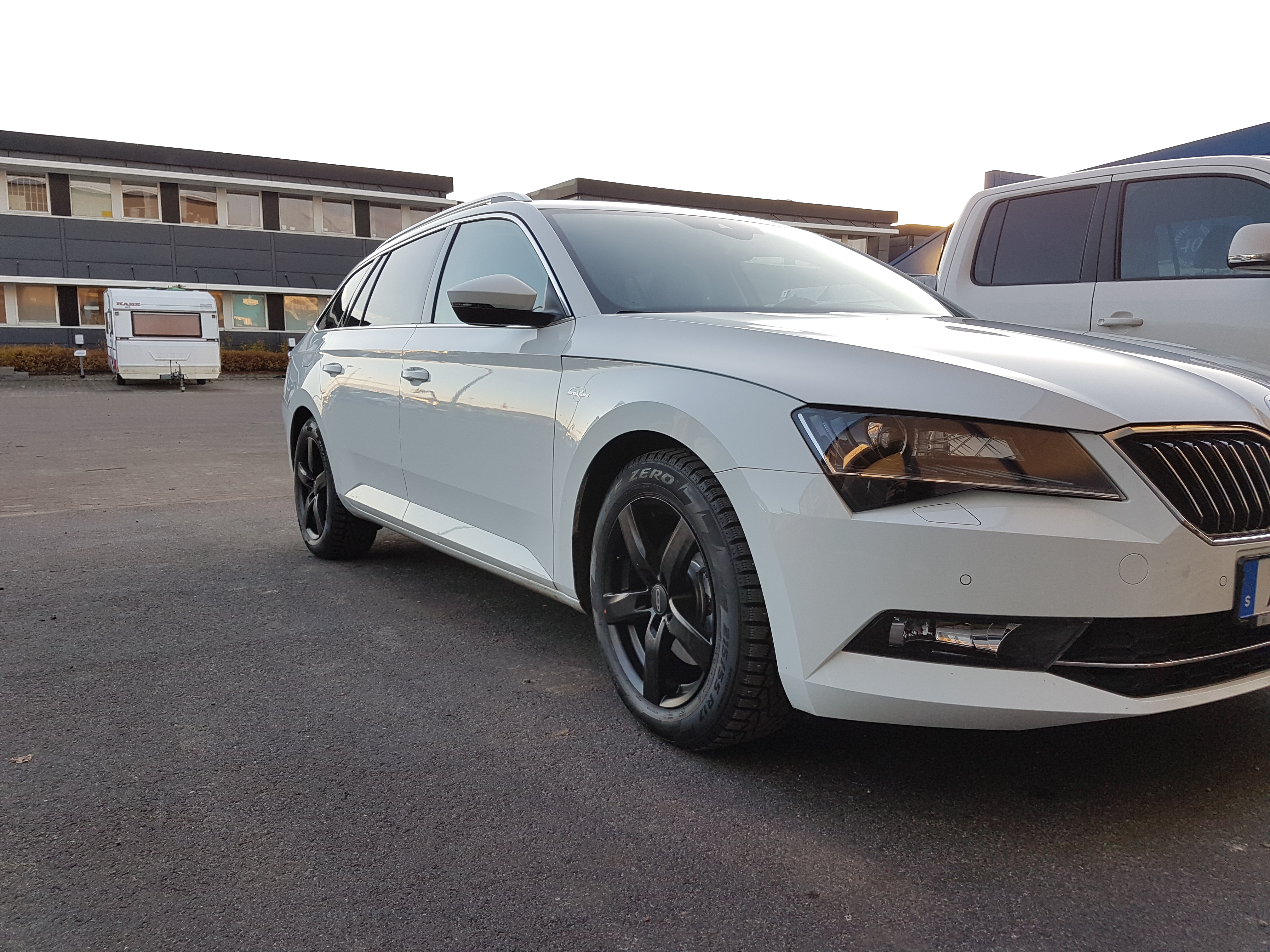

You are completely that about that! I should have ordered my wheels by myself but I let a colleague do it - the result is what you see in the picture. Not very nice, not very good but it does look awfull :)

Sounded quite sarcastic.. Posted the picture as "some" people think that it looks good with something similar to these wheels even though I don't.
Anyway - Size is 215/55 R17 Pirelli Ice Zero (studded).
The added height of the tyre and maybe softer sides makes the car very "wobbly" when turning compared to 18" standard wheels.
Apology's for how my post  came across and I appreciate your input to the thread.

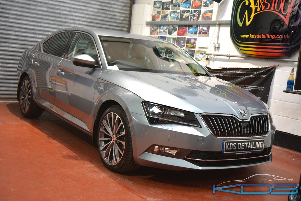

When I bought my S3 (190 L&K on 19s) I used some 17” Audi TT wheels, but if I’m totally honest I thought they looked a bit lost compared to the 19s.
L&K 19s:
17” Audi TT:
So after the first winter I went for some 19” SportLine wheels / Nokian winter tyres:

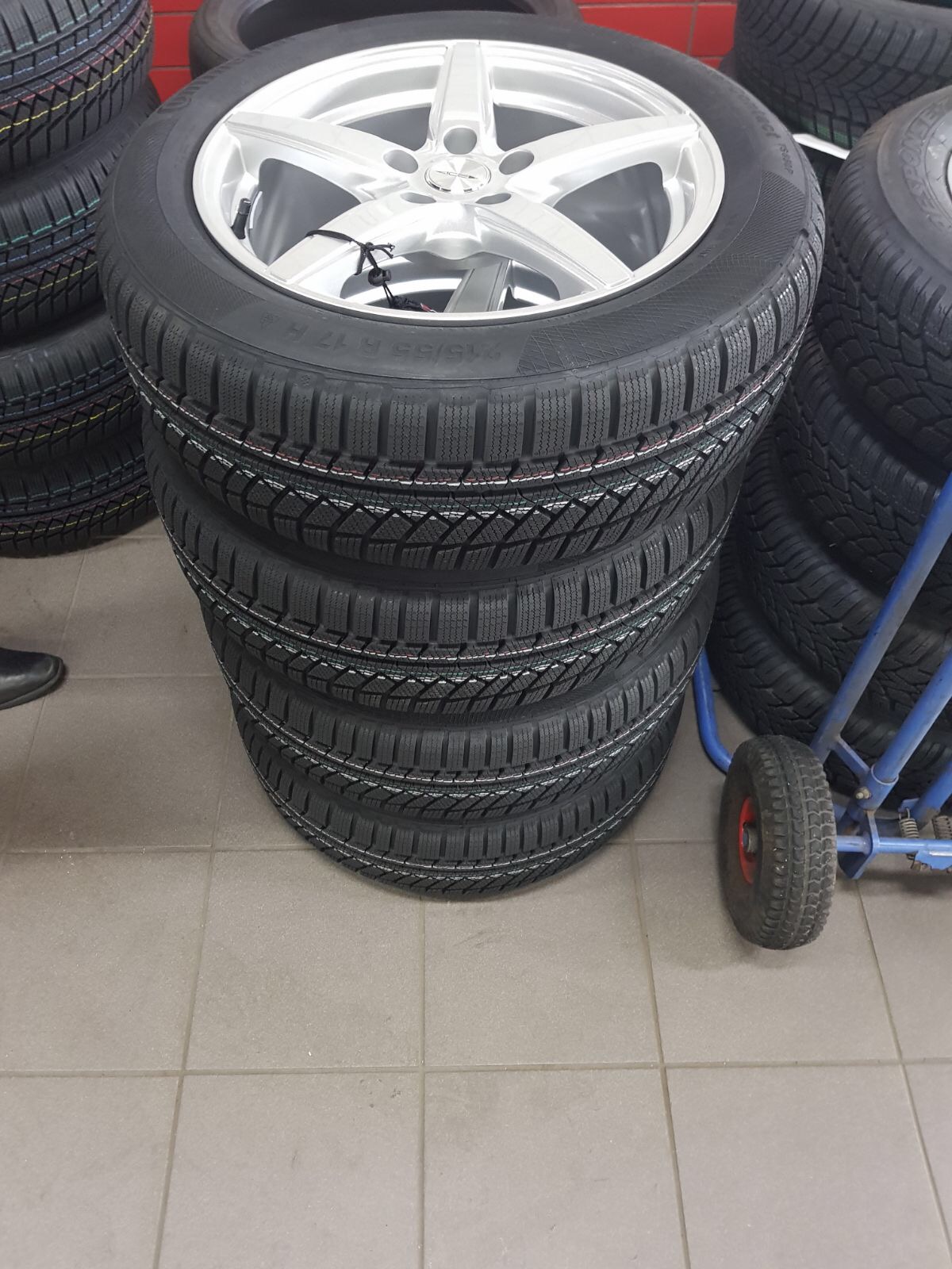

For me it is important that winter wheels are easy to clean - so I went for a simple 5 spoke design with no ridges or grooves.  I can clean all 5 winter wheels in the time it takes me to clean one summer wheel.

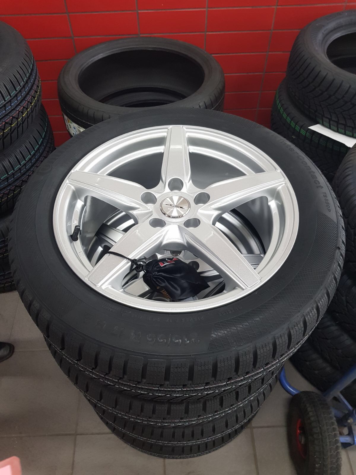

Same for me. Haven't picked them up yet. Dealer's pictures below:

Very similar to my Dezent RE 17x7.5 ET45 5x112 which cost me £101 each in late 2013 and have been use every winter since.
