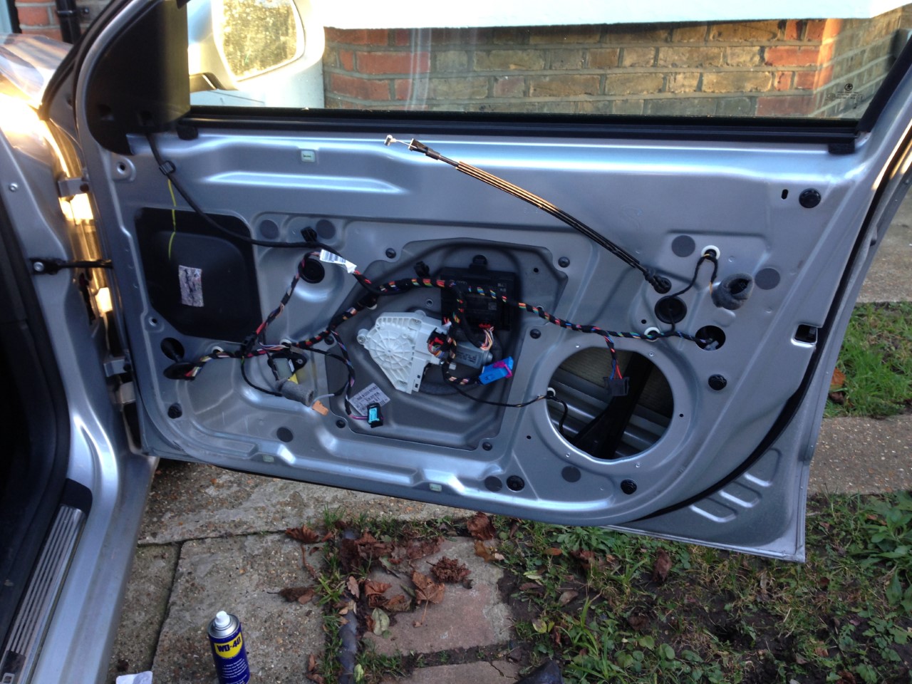

I'm after some help, I've got a Superb 2013 estate so a facelift version. A few weeks ago after washing it the drivers door and drivers side rear passenger door would not lock. I checked fuses and all the normal but could not find what was wrong out of desperation I took it for a drive hoping that maybe some water had got in somewhere and driving it and heating it up might dry it out. It was dark and whilst sat at some lights I noticed that the lights on the drivers door were not illuminated although the other side was. This made me realised the driver door was not getting power. So I opened the door and gave the rubber gator (see photo) a wiggle and hey presto everything came back to life. I intended to take the gator off and make good the loose connection but it was raining and dark so I put it off. The fault stopped happening so I figured don't mess around with something if its working ok. Then today when the wife was driving the drivers side would not unlock when she got back to the car. So now I have had a closer look at the rubber gator and I can't see how you get it off and I don't want to damage it and make things worse. Can any one offer some advise on this or has any one experienced similar problems?

After being quoted £375 to fit a new loom by a Skoda dealer and struggling to find an independent that was interested in the job, I decided to try and do it myself. Door card has all come away fine with out an issue using a good set of trim tools. All the plugs have come out ok apart from the last one at the end of the loom furthest from the hinge that connects the loom to the lock. I have had to remove the speaker to get access to the plug but its still tight getting your hand in there to try and undo the plug. I've even had my 10 year old daughter with her hand in there to try and get it unpluged but all with out success. Its very frustrating as this seems to be the only obstacle to me completing the job! I was thinking about trying to bend a screw driver to act as a custom tool to help press down the tab on the plug?

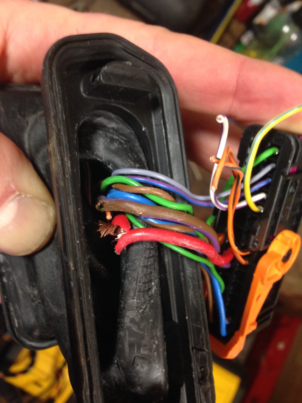

This tool arrived yesterday and I tried it out today. Using this tool I was able to disconnect the plug in a couple of minutes. I have been struggle with this plug for hours and mashing my fingers up in doing so. If you plan to do this job make sure you have this tool plus a pop riveter to put the speaker back in. Once this plug was off the rest of the loom went in with out issue. I'm surprised the old loom was working at all there were about 4 wires broken and two more badly damaged.

Hello, I passed all the plugs and cable through from the hinge side, as it  looked like getting the largest plug and rubber boot would be a struggle. It seemed to go ok doing it this way. The only thing I would suggest is that you take note of the route that the cable loom runs especially entering the door from the hinge side before you remove it. Plenty of photos on the phone to look back on. Also the rubber boot on the door side needs some persuasion to get it to sit properly in the door once everything is plugged in. I used a plastic trim tool to get it in place. I didn't have to release the retaining strap to get the loom in.
