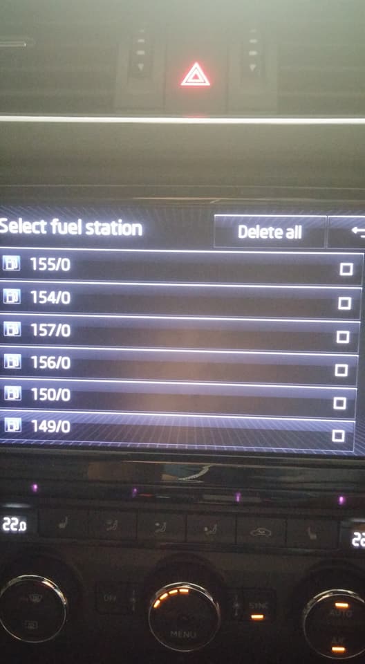

Does anybody know exactly what these mean? The numbers Skoda use are impossible to decipher.
Shouldn't they just show a brand, and distance?  BP, Caltex, etc, etc

It’s a problem with ROW cars and the more recent nav updates. My car built in April 2016 was fine on delivery, albeit only showing Shell. Since the update late last year the data has been meaningless.
Yep - looks like Euro/UK data has the names/distances properly displaying.
Aussie units seem to display these random numbers.... although someone on VWWC from Melbourne indicated his displayed names/distances, so who knows.

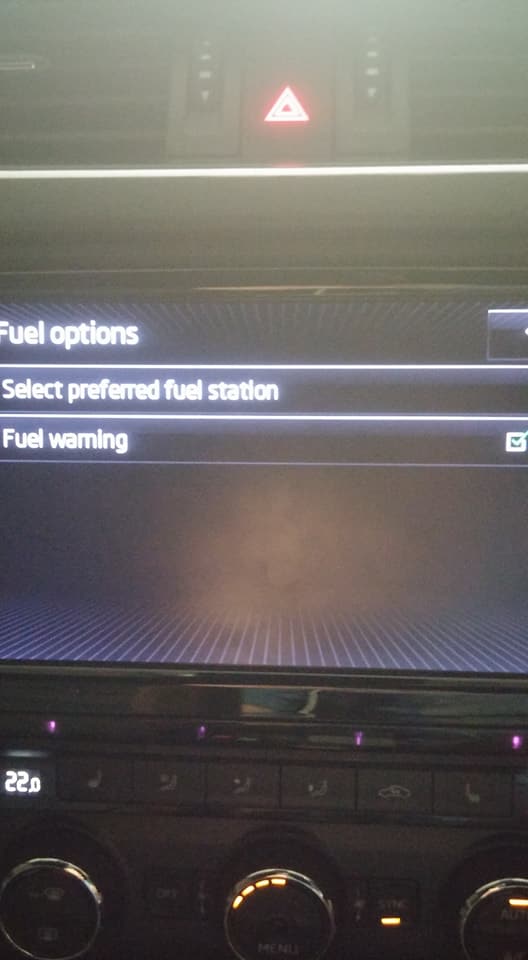

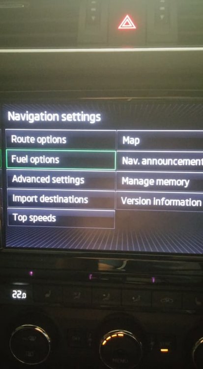

try  Navigation Menu Settings/Map/show POIs/Show brand logos for POIs.
You might also want to do an online or mem card import/update of your POIs.
