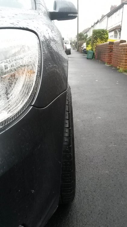

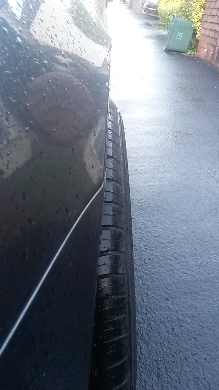

So I have fitted those audi wheels ( and new tyres ) without checking if they will fit correctly , I know DumbDumb     , Could please advise me if that will fail MOT
Thanks
Technically it could fail as the tyres are protruding beyond the bodywork, but as to whether it would be spotted is anyones guess, same as to whether  an eagle eyed Mr Plod will notice and stop you.

Sell them and put a different set on the car. The wheels and tyres stick out too far and technically would fail an MOT

On construction and use regs, yes, but on MOT as long as they aren't catching on any steering, suspension or bodywork components, and comply with the tyre size/axle and tread depths, then shouldn't be a problem. As you correctly state, an eagle eyed copper, versed in the correct C&U regs could in theory pull you up on it due to the protrusion, as they would class it as a pedestrian injury risk.

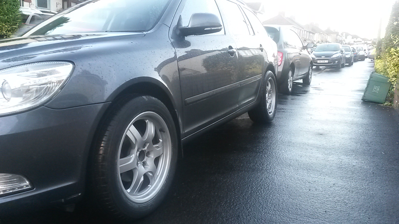

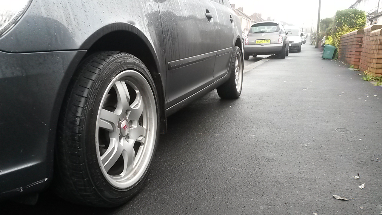

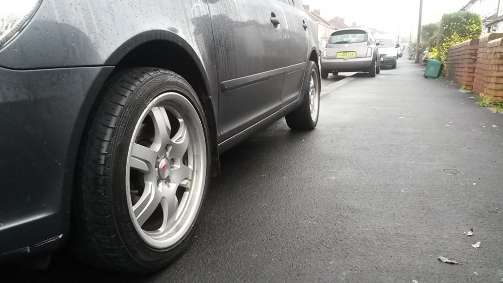

So they are 17" 7.5J ET28 on Maxxis 225 50 tyres
But I manage to make them fit better , changed front tyres to 215 45 and rear is 225 45 and it fits quite nice now :)

Having different size tyres front/rear is not recommended,
Your new front and rear tyre sizes have different rolling circumference and may cause the ABS to misbehave due to the rotational difference in speed between the front and rear axles. However the difference is only small, so you may get away with it.

I got different front witch I got part worns for £10 just to check if they will fit and they did :) , so now when replacing I will go 215 45 front and rear .
