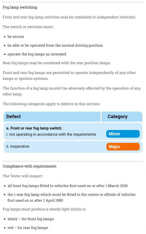

3 hours ago, xman said:
Unfortunately this mod would be illegal in UK and would likely fail an MOT as well.
Don't know if it falls foul of any other legal issues but it would be fine for MOT.
4.5 Front and rear fog lamps
4.5.1 Presence, condition and operation
You only need to inspect:
  • front fog lamps fitted to vehicles first used on or after 1 March 2018
  • the 1 rear fog lamp which must be fitted to the centre or offside of vehicles first used on or after 1 April 1980
A rear fog lamp isn't needed on:
  • vehicles not fitted with front and rear position lamps
  • vehicles with permanently disconnected, painted over or masked front and rear position lamps
  • tricycles and quadricycles
Front and rear fog lamps are permitted to operate independently of any other lamps or ignition systems.
11 minutes ago, sgt1297 said:
Having the fog lights operate with the main beam should not be an MOT fail!
As long as the fog lights operate as they should when being used as fog lights there should not be an issue.
There must be an MOT tester member on briskoda.net. An opinion would would be welcome.
Or even the experience of owners who have carried out the mod and had a problem or otherwise during an MOT.
I have LED headlights and halogen fogs and have activated cornering lights, flash with main beam and on with main beam.
MOT not due for 18 months though.
Watch this space!
Depends how MOT tester interprets "operate the fog lamps as intended"
Judging from the obsession with fitting football stadium grade lighting on their cars,  I reckon many members could do with visiting their local optician and get their eyes checked.
Edited by xman
That's the important line.

No issues here. Passed my MOT with this mod still active on the car back in June. Wasn’t mentioned at all.
