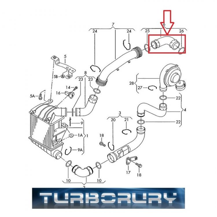

I ordered a new intercooler pipe from turborury.pl ready replace the deceased pipe that is in there now. On this diagram, the one I am looking to replace is pipe number 23. What is required to do this myself? If it's an easy fit just to take the old one off and put the new one in I will do it myself, but if there is some things that have to be taken off I will let my garage do it whilst they change a few bits on the front suspension. Thank you in advance.

Just 2 metal clips (number 24 on the diagram) that you pull and the pipe pops out. 30 second job
