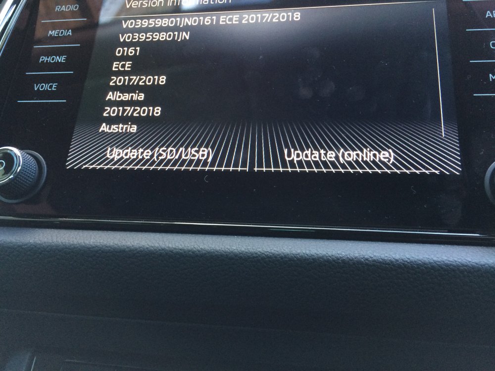

Then from Navigation view go into settings>version information and choose update from USB/SD

Took about 40 minutes to update from a USB HDD for me.
