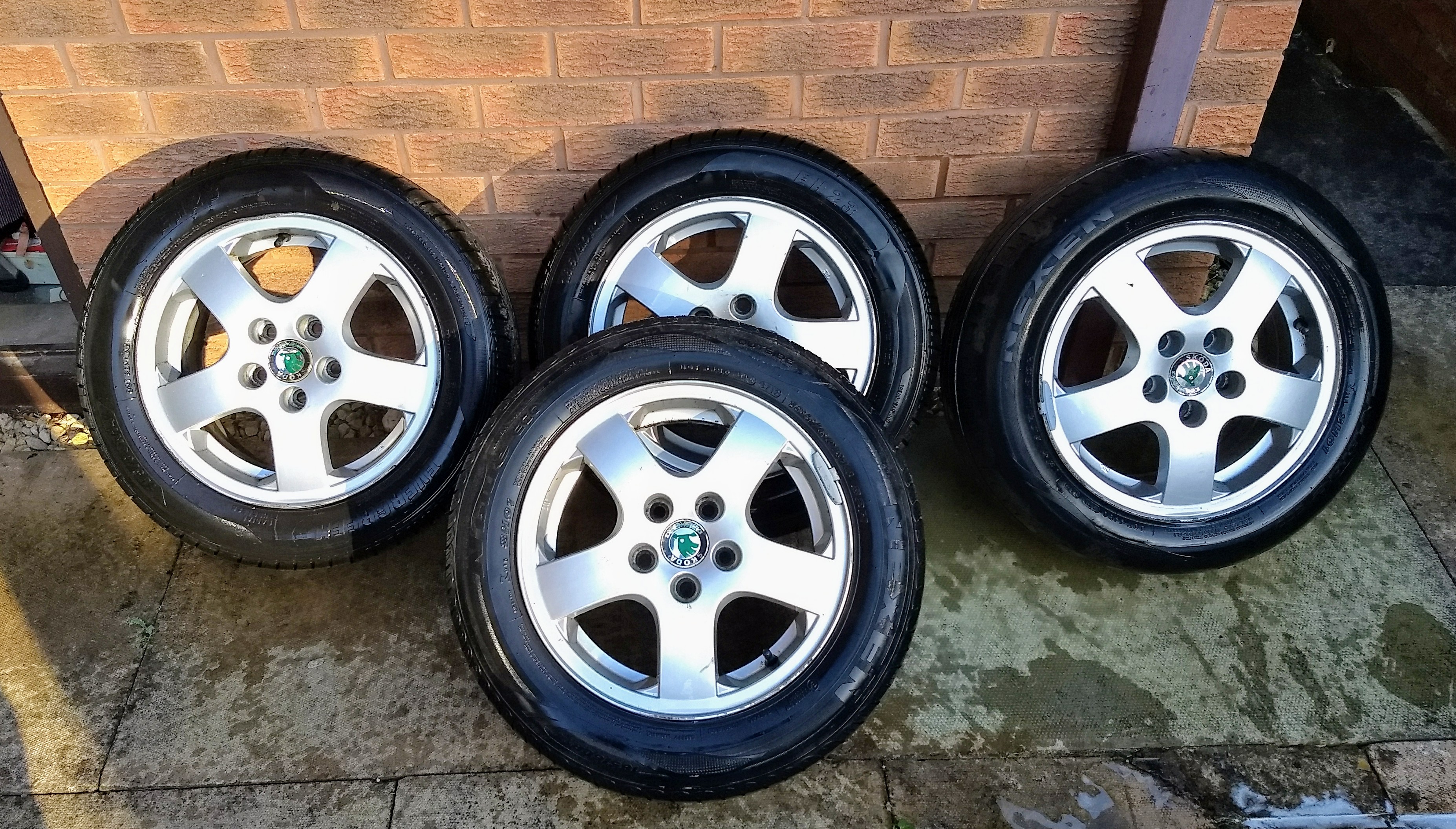

Here's a pic of the new alloys I picked up from Evesham. Set of four with locking nuts and key for them and the full set of nuts.

Do yourself a favour and chuck the locking bolts in the bin since you have enough standard bolts to make a complete set, nobody steals bog standard alloy wheels off fifteen year old cars, you'll thank me next time the wheels have to come off after a salty winter.
I find the skoda ones pretty good actually. Not had any issues even when the tyre place torqued them up to 250nm

Thats what the torque wrench maxed at when I tested the torque. Could well have been more as it required a 750mm bar and a length of tube attached to it.

My 3.5T LWB van is only 235NM, don't use that place again, they could have killed you, over tightened wheel bolts can snap really easily.
I had it happen to me years ago on my old Passat estate, I was barreling along the dual carriageway and as I went round a sweeping bend the steering wheel started to vibrate like I'd lost a wheel weight, drove it steady the rest of the way to work, parked up and took a look to see two bolt heads missing, jacked it up to find that the remaining two bolts were finger tight and also about to shear off, I almost went white with fear when I thought about what could have happened on that sweeper at 70 MPH if they'd all let go.
It was a tyre place previous to me owning the car. I checked the threads very carefully but they were ok
I recently say a transit van with the wheel halfway down the road and a deep scrape in the tarmac on a slight right hand bend, looked closer as i went past and the wheel studs had all snapped!
