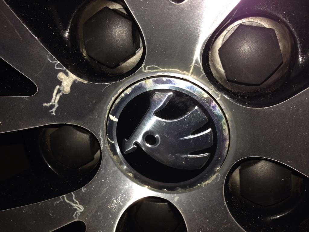

Centre cap corrosion x 4
Wheel corrosion x 1

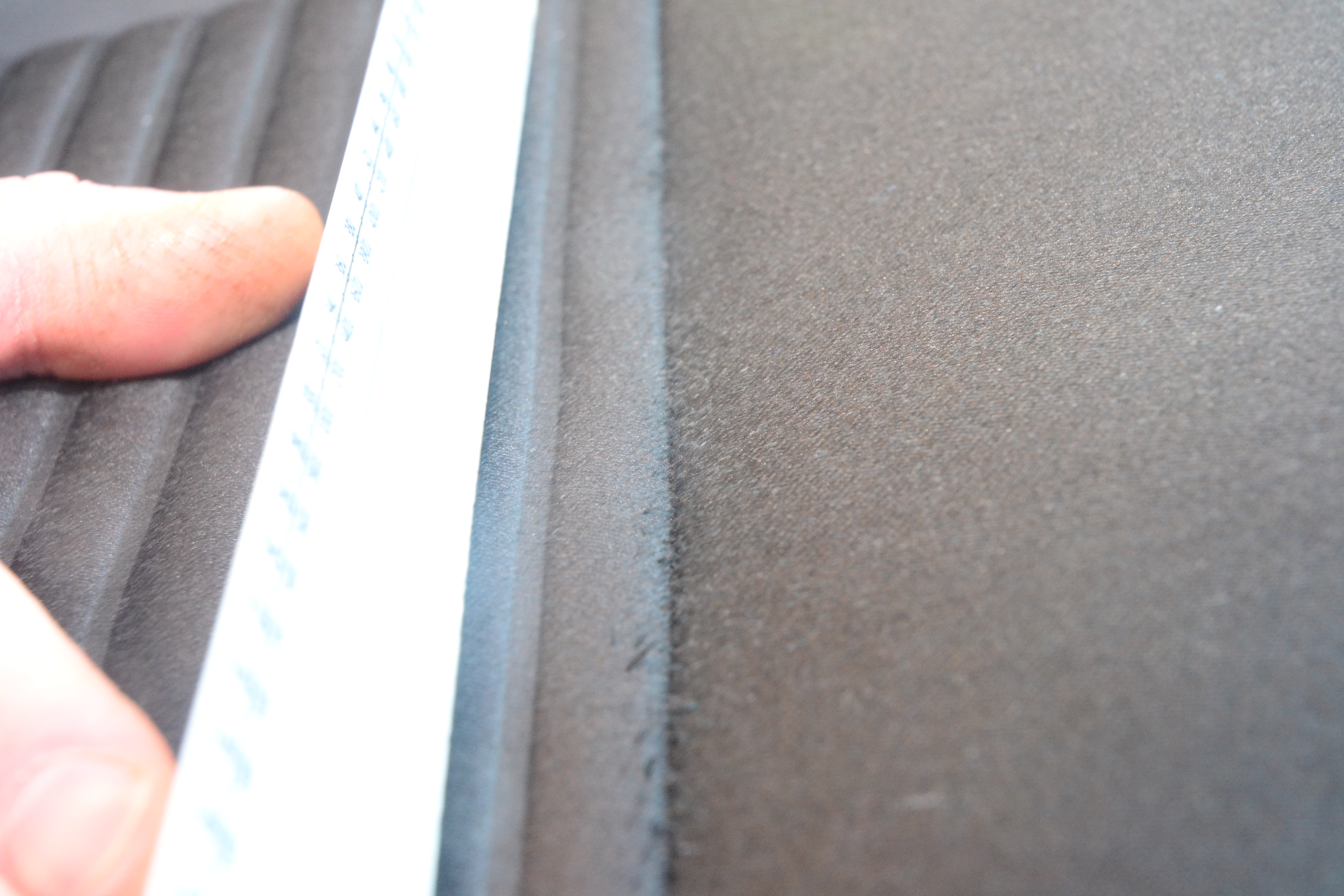

The main issue I have is that on 3 of the four seats there is stitching coming apart. I think this is totally unacceptable on a car lees than two years old.

White Worm / Corrosion of Alloy Wheels is well covered if you do a search, on many models.
Your Manufacturers Warranty is what covers it, and do not let Dealers or Skoda UK CS say over 6 months / 6,500 miles so not covered.
(External Environmental influences / damage wheel chipped / kerbed, ie Wheel Washing, driving a car on a road, acid rain etc,  or just poorly finished Wheels and trim not up to using on a road vehicle, members here / owners do get wheels replaced, and caps,  Seat wear more difficult though.)

I had white worm on the centre caps of my 15 plate vRS, nothing severe just untidy and they were replaced at the last service without question.

The areas on the seats that is affected is not where there would be bits on your jeans rubbing etc. On the rear seat its on the back rest where my 10 year old lad has sat less than once a week since the car was new.

my centre caps corroded like that after 6 months old, forgot to mention it at 1st service.. they will probably have disappeared by the 2nd service!!

My wheel centre caps have some white markings, just like my MkII. I asked for replacement at the 2 yr point and the dealer fobbed me off  with 'damaged by detergent'. I replied that it was the usual poor materials. What I should do is get a VRS set from Pastyboy, if he still does them, I had a set on my MkII as per the picture below, which were superb, they glued onto the old centre caps and had no 'detergent damage' when I sold it about 3 years later. The picture was taken the night before I sold it at 8 years old, having bought it from Skoda direct 7.5 years previously. The refurbed wheels were unmarked after 2-3 years use.

There is no Additional 'Labour' time required on the Wheel Centres if the car is in for a Major Service and the Tech was removing wheels but then likely you are paying a Service and no wheels are coming off, so no popping the wheel centre out from behind, just the picking out, the picking out that can cause 'Alloy Wheel Centre damage then white worm.
Great if you get 'New for free wheel centres',  but really they are cheep enough as to just buy them if you need them.
As to White worm of Diamond Cut  / lacquered or painted wheels, if the 'Centre Bore' Wheel Cap causes the Corrosion, then Skoda are going to have to have the wheels inspected and prove 'Not a fundamental, design, manufacturing, material or workmanship failing'
