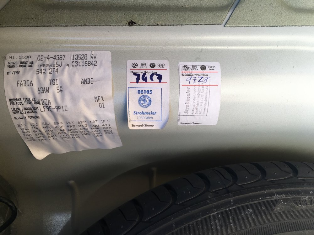

Hi,
i am also looking for a monte carlo 1,2Tsi, and i found one. They say it is from 2012, but i think the car was produced 2011.
I have the back side paper and some code.
May i know from this if this has a timing chain and if has been upgraded with the new set? I remember they put a code once fixed that issue.
Btw, the word “Ambi” is correct for monte carlo? Souldnt be different?
Thanks for feedback
Edited by Juhagpl
Yes that is why i am asking : )
they also try to sell it as ~100hp version. I didnt even recognize the 62 kw...
The Euro 5 1.2 TSI is 86 ps  (63 kW)
or 105 ps.  (77 kW)
Edited by AwaoffSki
