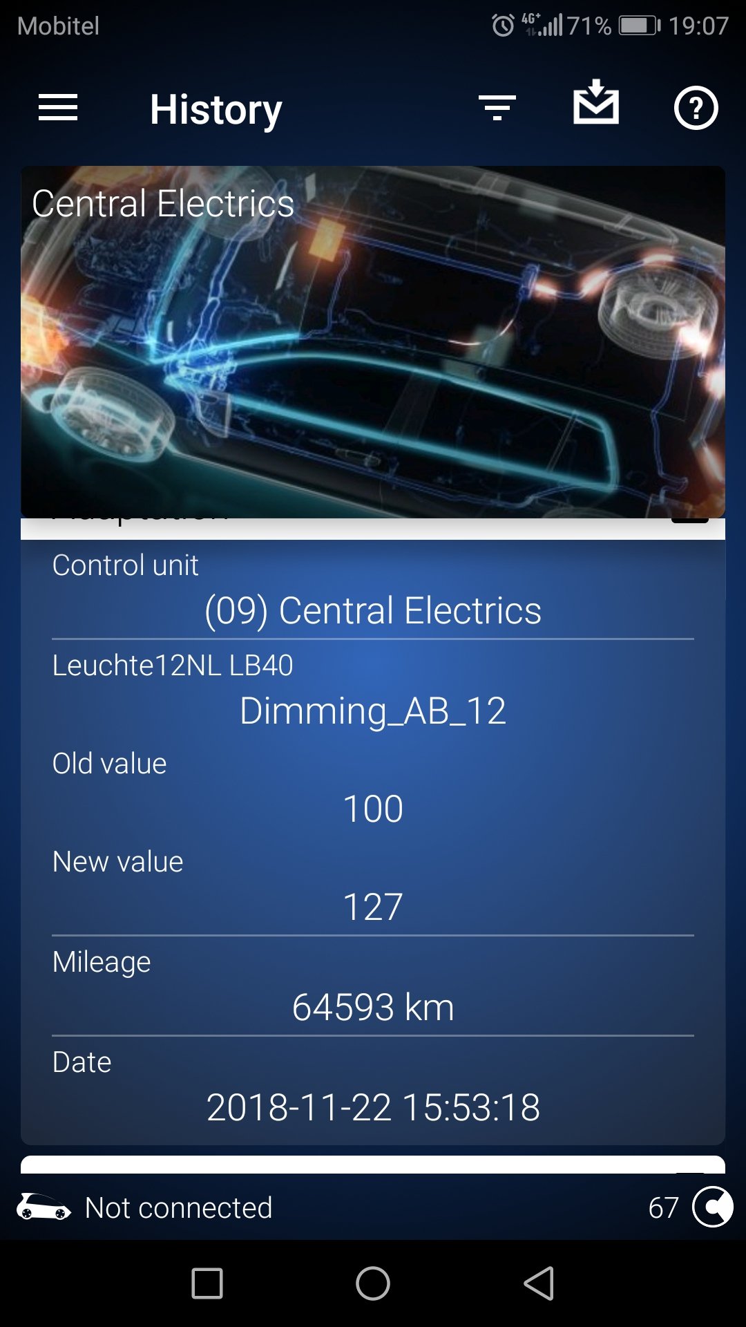

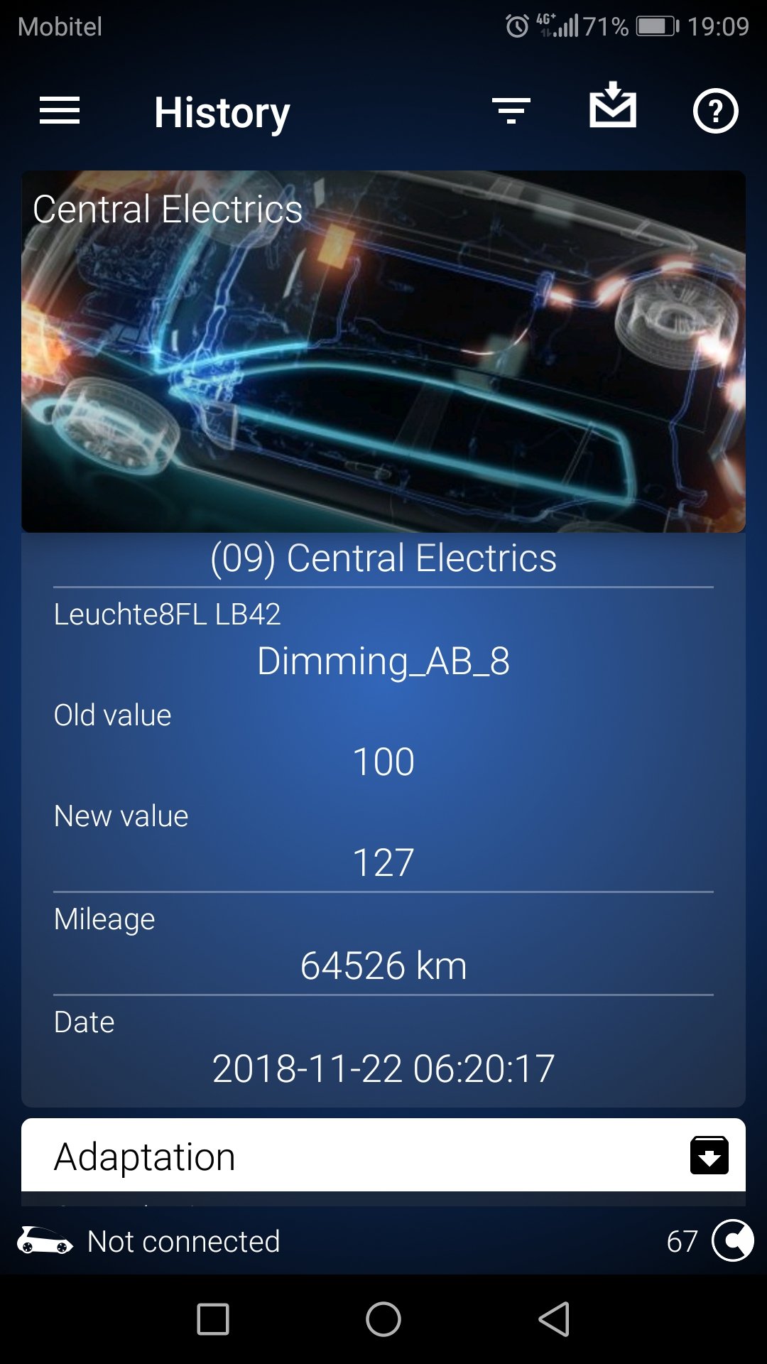

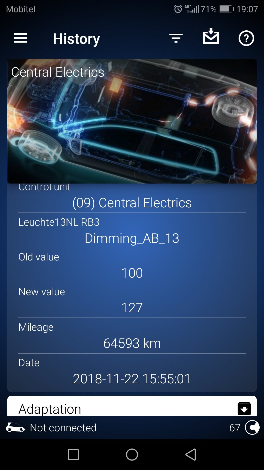

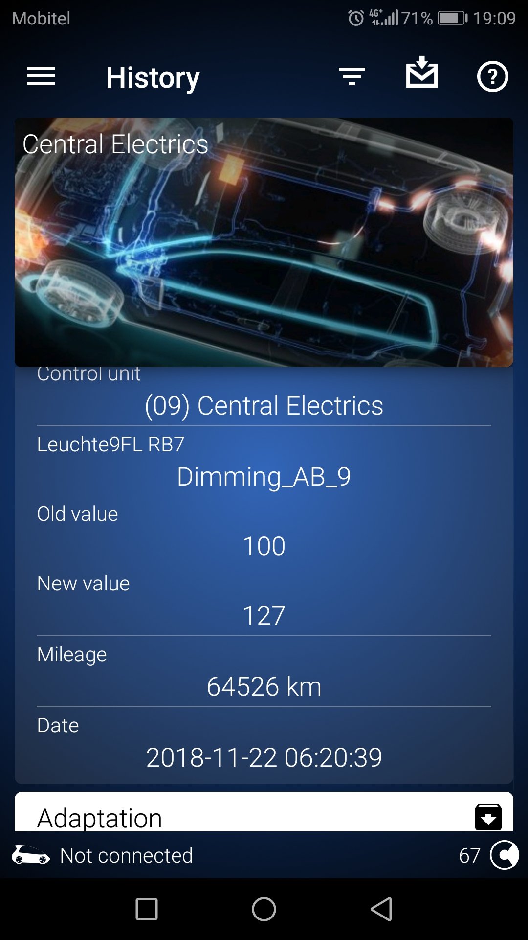

So, attempted this adaptation today and can do AB6 and AB7. The others won't stick. Do you have to do them in stages? Didn't have time to try anything other than change the values one at a time.
I did them all separate sessions, so change and apply for each one.
I did them in dark so I clearly saw a step up in brightness in each one.
Mind you, that my obd11 descriptions were in german still at the time. Verify that you are setting the right ones.

I have an octavia 5e and intending to do the same as the halogens low beam are pretty weak. Can anyone confirm that this change does increase the visibility?
regards,
did the change and don't know yet if placebo or not but after engine reignition lights seemed better. Need to drive thru more to really see if it is for real. Only applied these :
Adaptation
    Control unit: 09 Central Electrics
    Values:
        Dimmwert AB 13:
            Old value: 100
            New value: 127
    Mileage: 28110 km
    Date: 2021-08-03 22:10
Adaptation
    Values:
        Dimmwert AB 12:
            Old value: 100
            New value: 127
    Mileage: 28110 km
Adaptation
    Values:
        Dimmwert AB 7:
            Old value: 100
            New value: 127
    Mileage: 28110 km
    Date: 2021-08-03 22:08
Adaptation
    Values:
        Dimmwert AB 6:
            Old value: 100
            New value: 127
    Mileage: 28110 km
    Date: 2021-08-03 22:06
